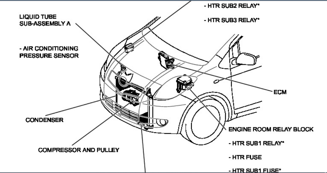

Can the AC pressure switch be changed without loosing the Freon in the system?
Sunday, June 3rd, 2018 AT 12:07 AM
MECHANIC
52,796 POSTS
Good morning.
The switch has a Schrader valve in the line so the Freon will not escape. Be careful as the valve may stick and allow Freon to escape.
It should be an easy change.
