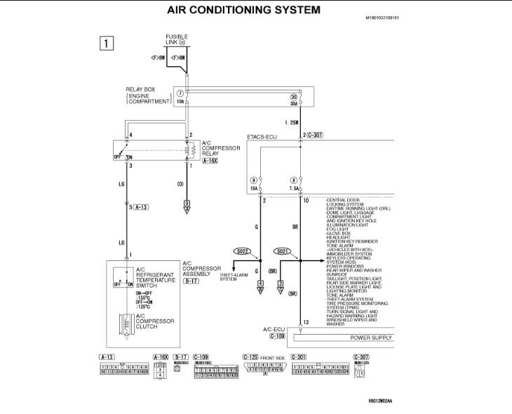

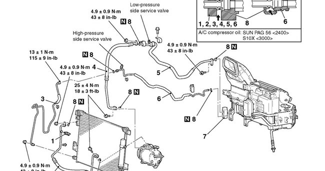

Low and high pressure switch location and AC electrical diagram.
Friday, August 31st, 2018 AT 9:30 PM
17 Replies
Good evening.
I attached a wire diagram and a hose diagram that shows the location of the high and low side fittings.
