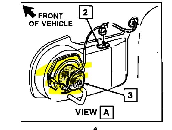

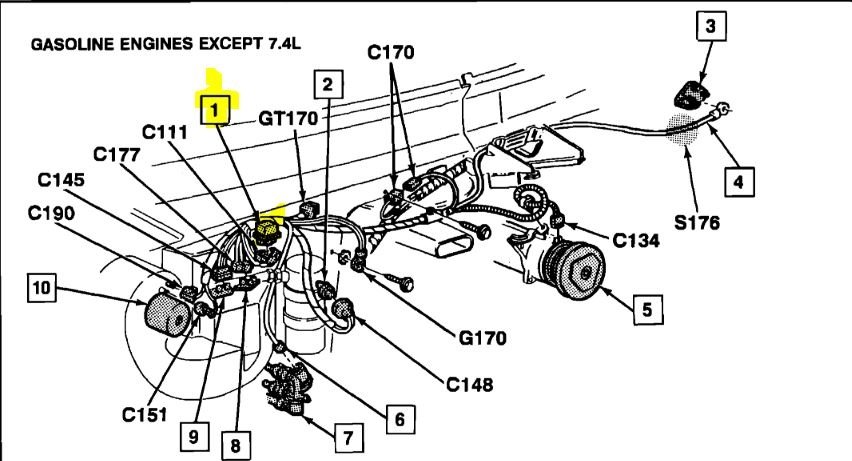

A/C, heat and defrost not blowing at all.. was working fine when I went into my dr appt and when I started the vehicle I had nothing blowing.. checked all fuses.. not sure if it has a relay or even where the relay is located or control module. any help would be greatly appreciated and thanks in advance.. Nick Williams

Nick, the blower motor does have a high relay. It is under the hood on the firewall. See
pic 1.
Does the fan work on any of the speeds? If it still works on high only, the resister is most likely the issue.
As far as the blower motor itself, here are the directions. They are vague, but I should be able to help if you have questions.

Pic 2 shows the blower motor location. If you can, run battery voltage to so you know if the motor is bad or not.
Let me know what you find.
