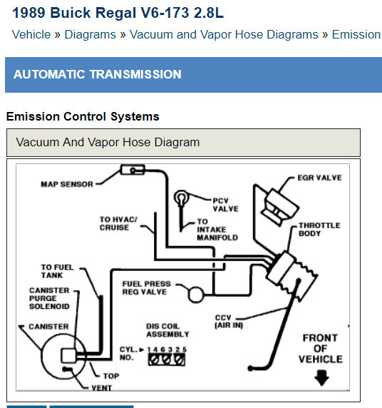

Yes, the system must have vacuum here is a diagram so you can see what happened (below).

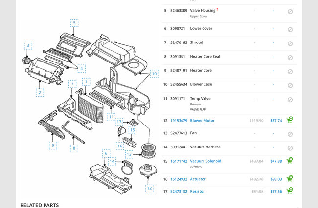

All the vacuum lines are good under the hood. I just replaced some of the tubing on the egr harness. But the cruise control vacuum tank broke on me when I was disconnecting one of the vacuum lines to check if it still worked. Someone told me I would need to replace the Electric Vacuum Solenoid that works all the actuators. Would this fix my issue with getting no air out of the vents? Also would my defroster speed get stronger to clear the windshields?
Number 15 is what he told me to look at.

If you are referring to the main controller on the instrument panel that is still working fine. I also tried replacing with a new one but did not fix anything. Please let me know what main controller you are referring to? I am thinking it is the actuator blend door that controls the temperature for AC and heat. Someone told me that had the same issue I am having when their vents are stuck in defrost mode. They said replacing the actuator blend door fixed the problem.

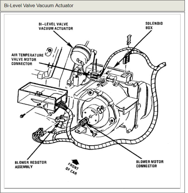

Yes, that could fix it. Here is another diagram I found for you.

Ken, I had no luck with that part either. I am thinking it is something really serious now. I hope one of the doors is not broke. Because than does not that mean they have to remove the entire air duct door assembly?

Do not get bummed yet, remove the blend door motors/actuators and move the doors by hand to see if they work. I have seen the blend doors break loose inside but it is rare. Also, while the actuators are off start the car and see if you can get them to move.
