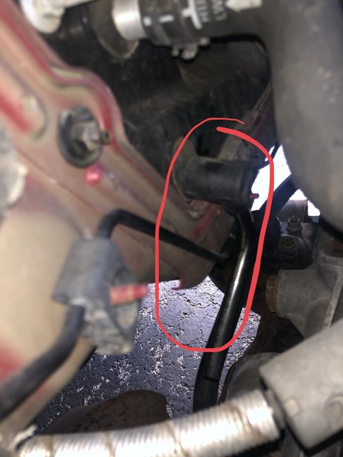

My floor board is wet on the passenger side and I am looking for the A/C drain. I think it may be clogged. I found a small elbow type hose under the hoses that are for the heater core and checked it but it was not clogged.

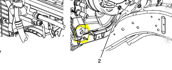

Good morning,
I attached a picture of where it is located. If you remove the hose and it was not clogged, then the clog is inside the case. You will need a coat hanger or compressed air if you have a compressor at home to dislodge the dirt.

I have found hose, I removed it nothing came out. you said it’s inside the case? how would you clear it if that was the case?

As I stated in my previous post, you will need a coat hanger or compressed air to clear the drain. The dirt is inside and needs to be moved for the water to drain.
No, that is the only location.

Can you upload a picture of where you are cleaning?

This one right inner the heater core hoses is the one I was cleaning.
Jul 12, 2019 at 5:19 AM
That is the drain for the AC.
