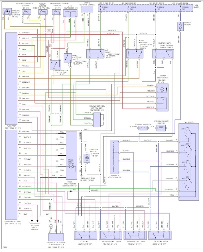

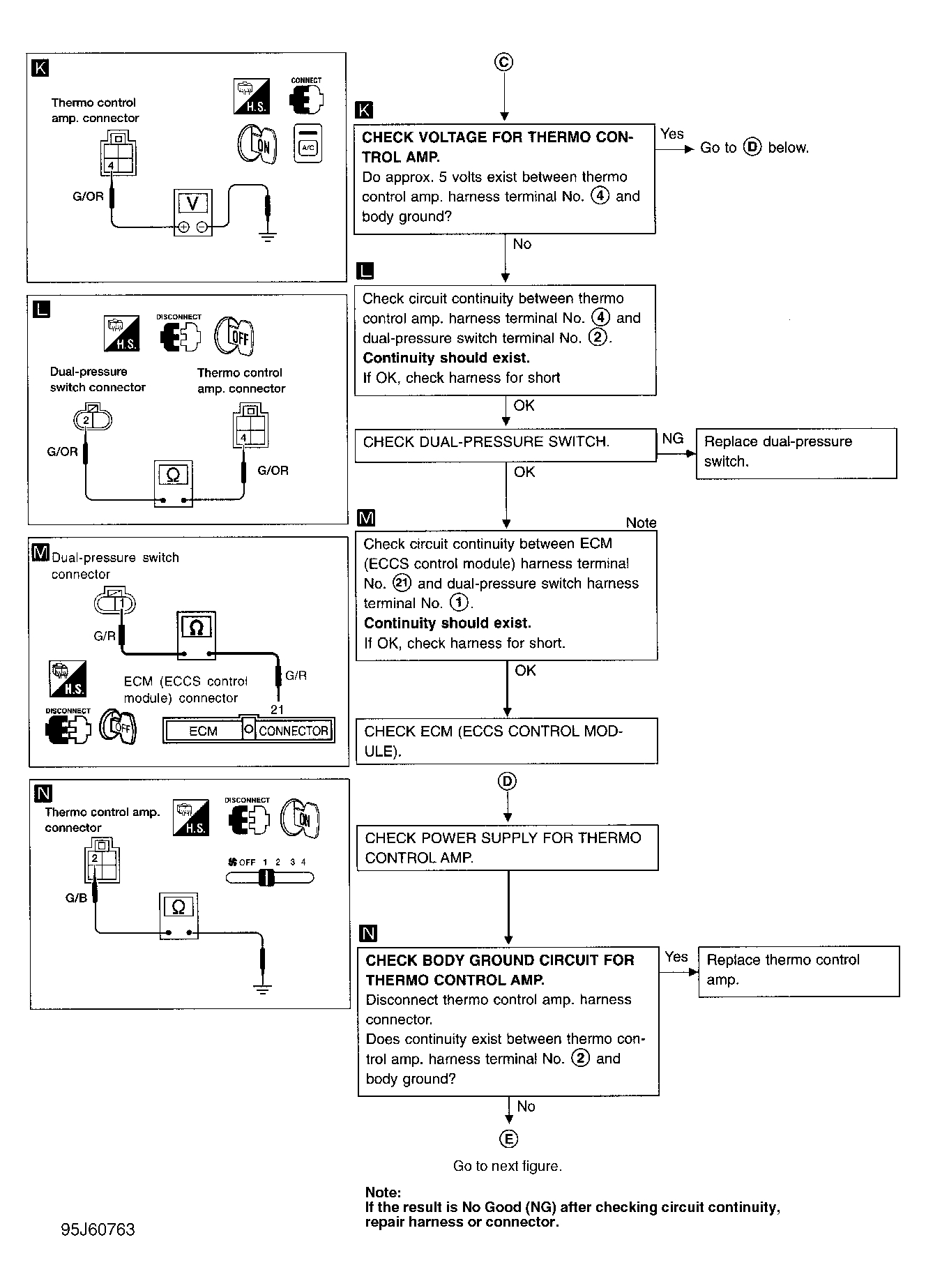

The air conditioner compressor will not run unless I ground one of the wires where the low pressure switch connector. I have already replaced the LP switch and recharged the system with 1.75 lbs of Freon after replacing the LP switch.

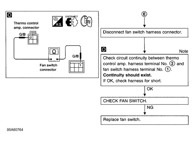

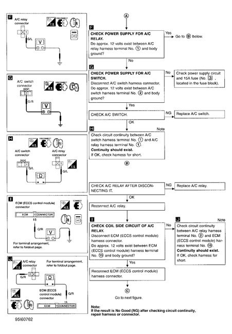

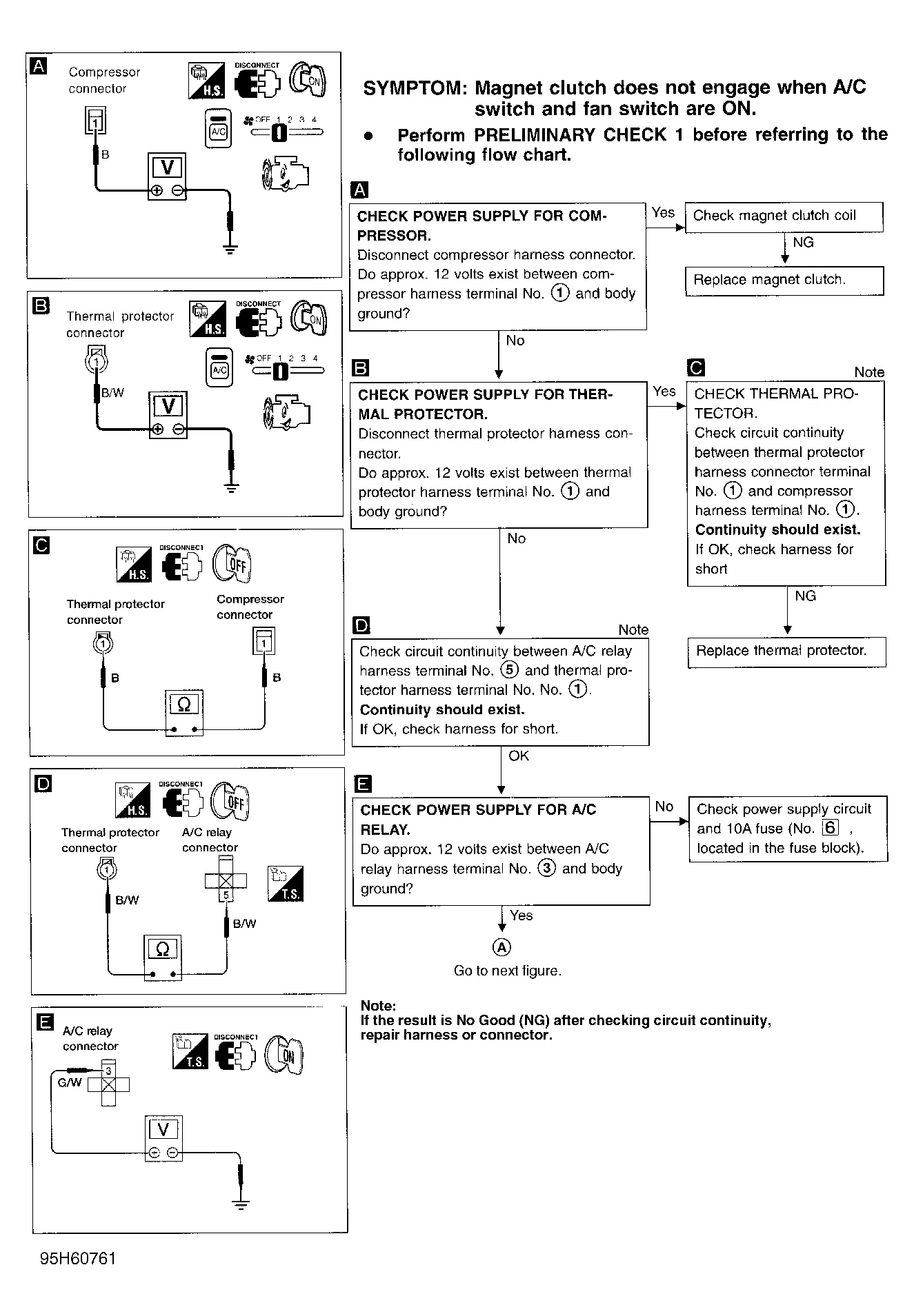

Try following the trouble tree I posted for AC compressor not coming on and let me know where it leads you.

Also remember that the ac cools very good - as long as you have the green wire with a red stripe at the pressure switch grounded.
Saturday, June 25th, 2016 AT 6:42 AM
KEN L
  • MASTER CERTIFIED MECHANIC
  • 55,322 POSTS

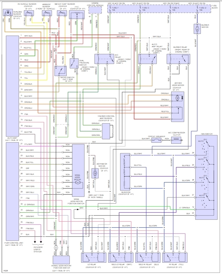

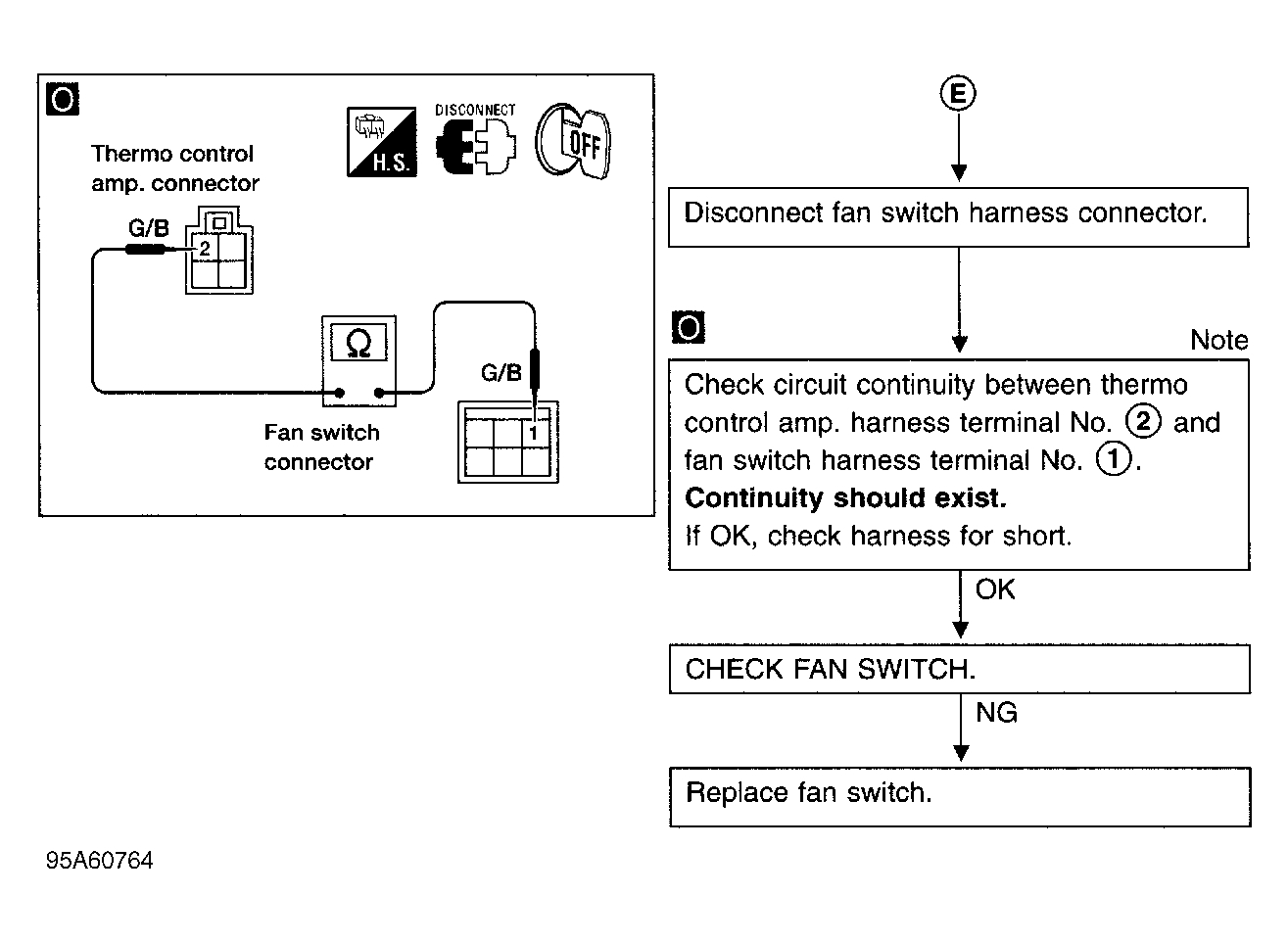

If I may, it sounds like you have an amplifier resistor that has gone out, here is a diagram to do some checking, but that what it looks like it could be
