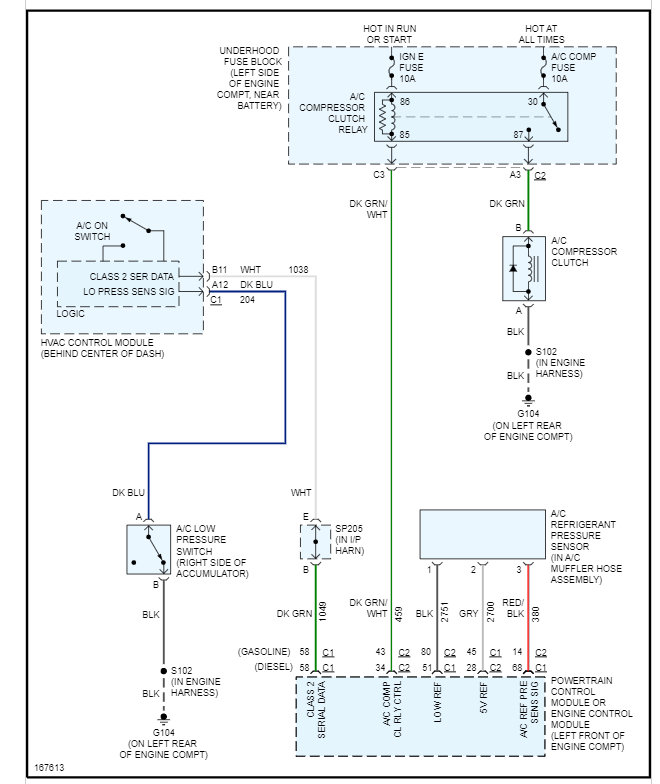

It was the low pressure switch tested it and it was bad. Also the A/C wire harness pigtail was worn out changed that. I now have 34 degree air at the vents.

Found problem, shorted A/C wire.

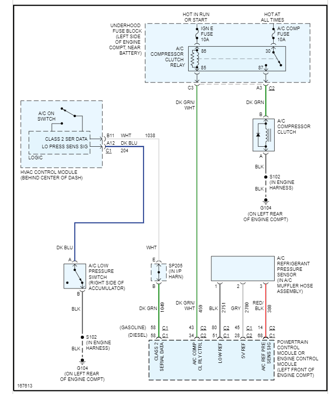

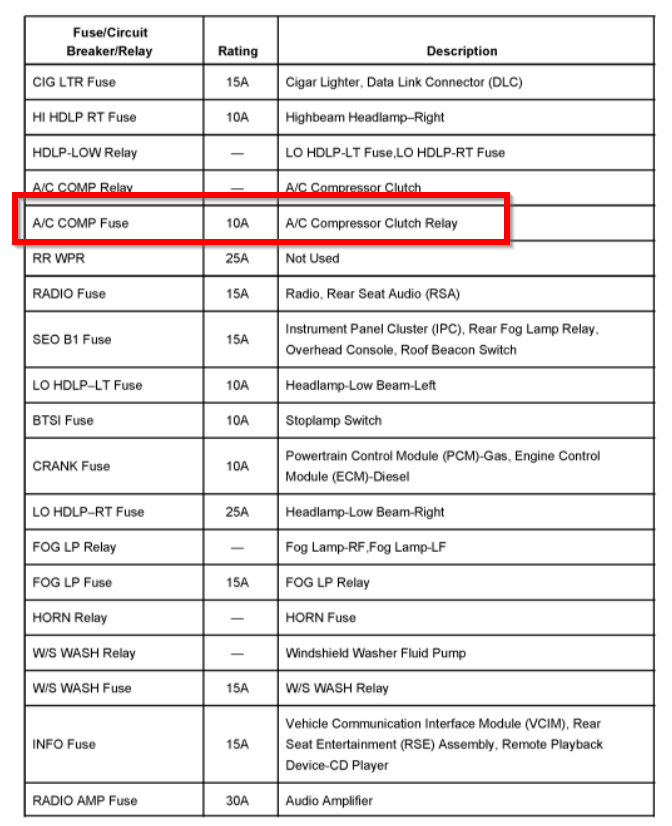

Update: The A/C fuse keeps blowing. I put a test light on the ground wire on the plug going to the compressor and it lights so I have ground from PCM. When I check for power, I have no power. I jump the relay then I get power on A/C plug.
I’m going to ohm out compressor to see if clutch is bad. But could a bad low pressure switch cause fuse to trip or most likely the compressor is bad?
Sunday, May 8th, 2022 AT 3:15 PM
Okay. Just to be sure, you are getting the A/C compressor fuse (shown in the diagram below) blowing?
If this is the fuse that is blowing then yes, it is the compressor. If you look at this circuit, then the compressor/relay is the only thing on it.
So, unless the relay is shorted to ground (unlikely) then the compressor is the only thing on the circuit that can cause this. Basically, what is happening is you have a path to ground prior to the load on this circuit which is the compressor. So that is the clutch as you stated is shorted.

Yes, it’s the A/C fuse 10 amp that keeps blowing.
