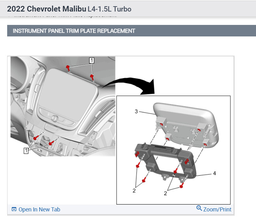

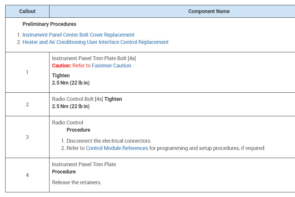

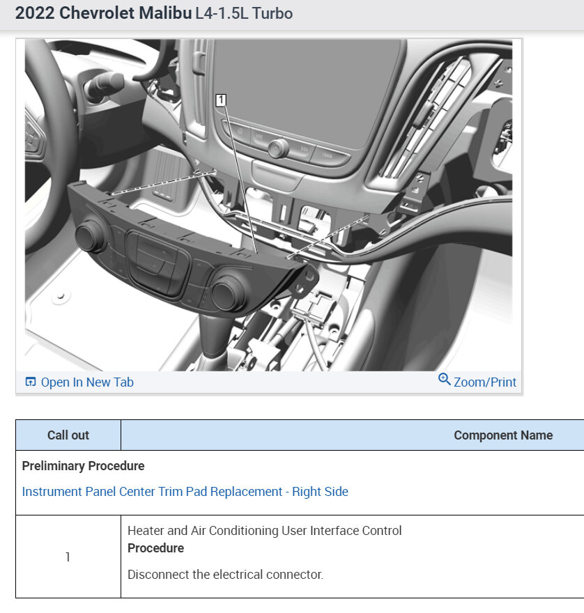

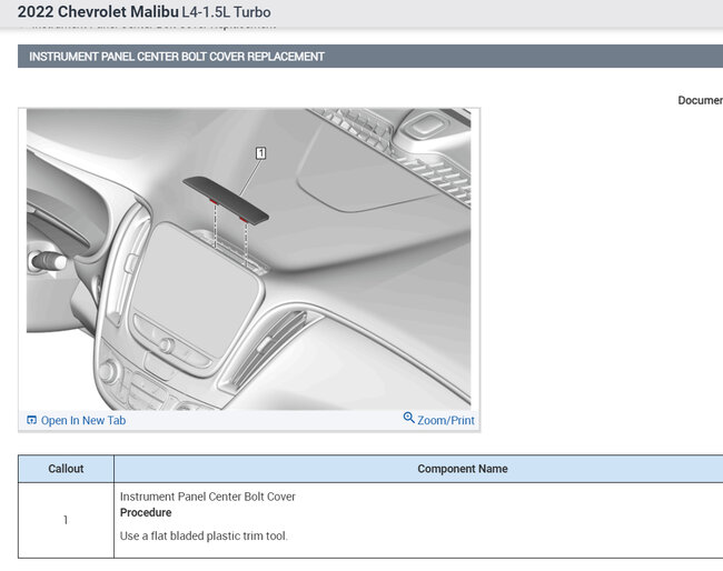

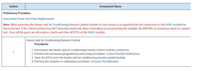

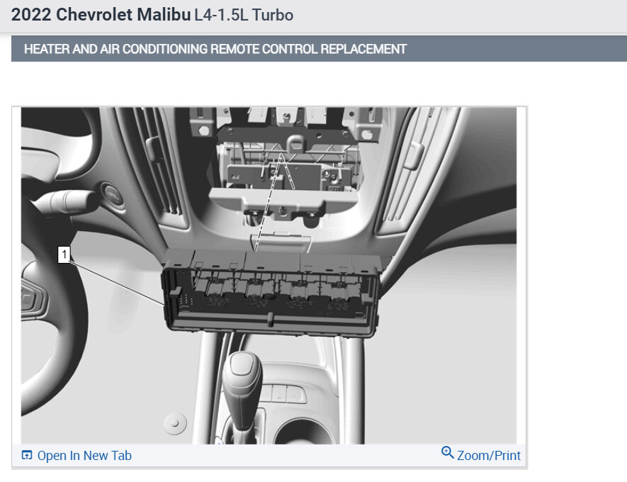

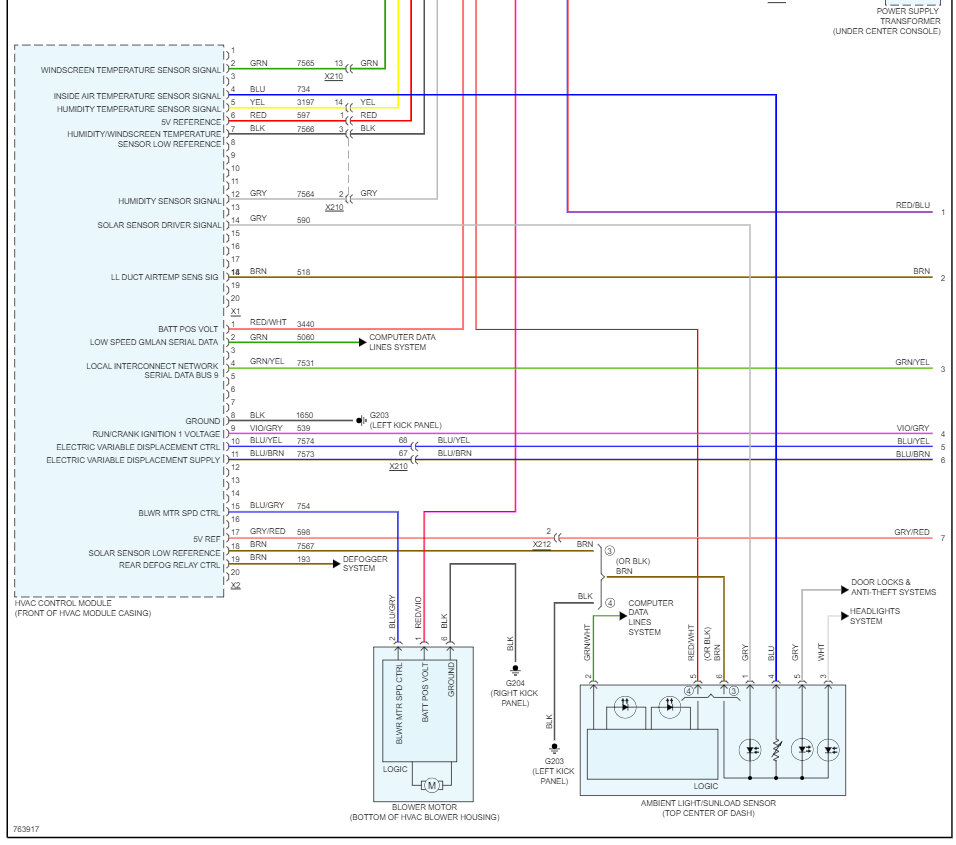

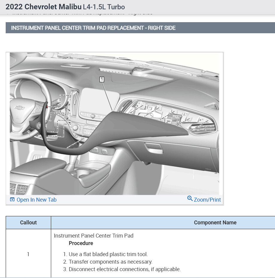

Yep, this is what happens when the HVAC controller goes bad, here is how to replace it in the images below. I have included how to calibrate the unit as well without using an interface module. Check out the images (below). Please let us know if you need anything else to get the problem fixed.

PAPAHOOD
Thanks for the quick response. A couple of questions. So, there are two components I need to replace? The remote control module and the physical button control module? And my other question is I’m a little confused on the procedure to clear or calibrate codes. Are those links for that? Or was that in the pics and I’m just not seeing it correctly. Thanks
Jul 4, 2023 at 11:44 AM

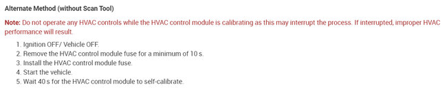

PAPAHOOD

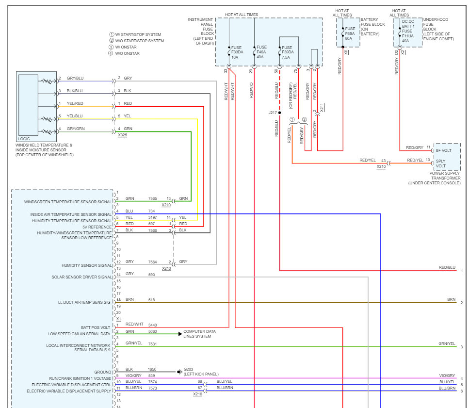

Okay, so, I figured out the instructions for calibration. Picture was just too big, and I thought it was an ad. Anyway, that brings me to hopefully my last question. In the instructions for that it says to remove the HVAC fuse for the control module when doing this. I have found two HVAC fuses under the dash and two air conditioning fuses under the hood. Just wondering which one it actually is. Thanks
Jul 5, 2023 at 7:27 AM
  • 54,128 POSTS
I would remove them both. Please let me know if that works.

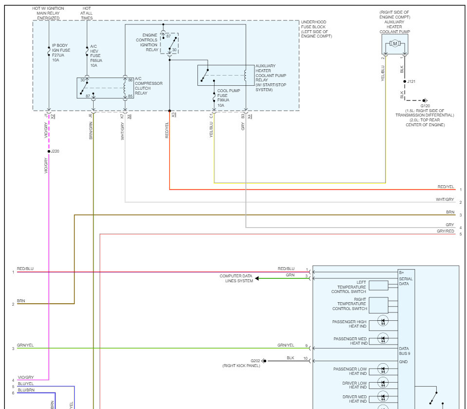

PAPAHOOD
And which fuse? Thanks
Jul 6, 2023 at 12:11 PM

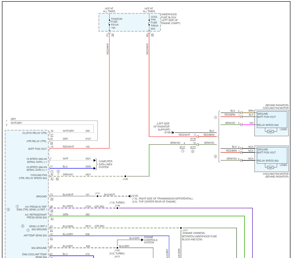

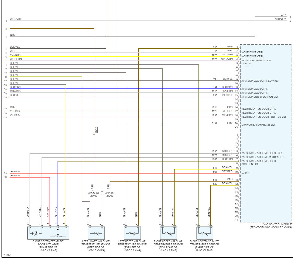

  • 54,128 POSTS

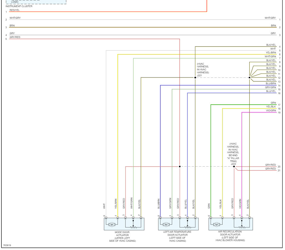

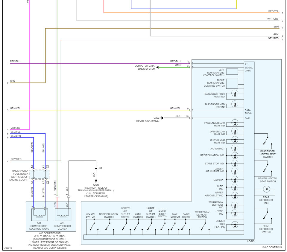

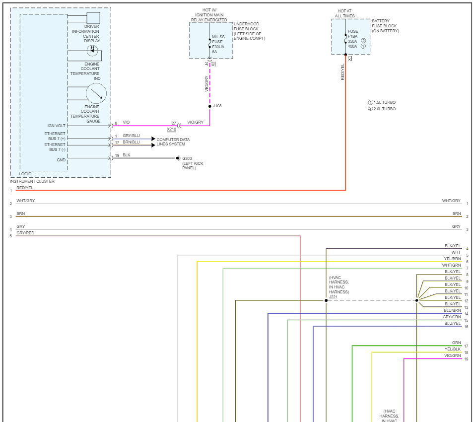

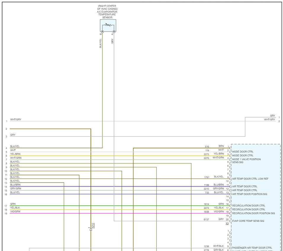

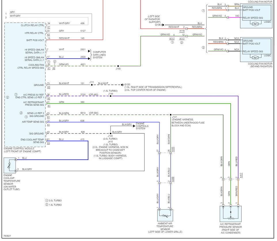

Sure, there are many fuses that run the system. here are the HVAC wiring diagrams so to can see how the system works and which fuses run the system:
Check out the images (below). Please let us know how it goes.
