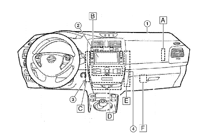

The A/C blower stays on even if I turn the A/C off?
2015 NISSAN LEAF
74,000 MILES • 2WD • AUTOMATIC
BHAMDOC1973
  • 2,007 POSTS

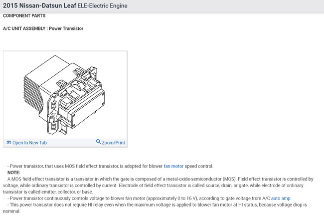

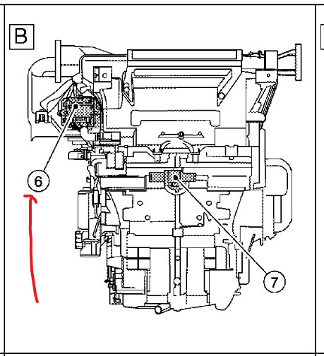

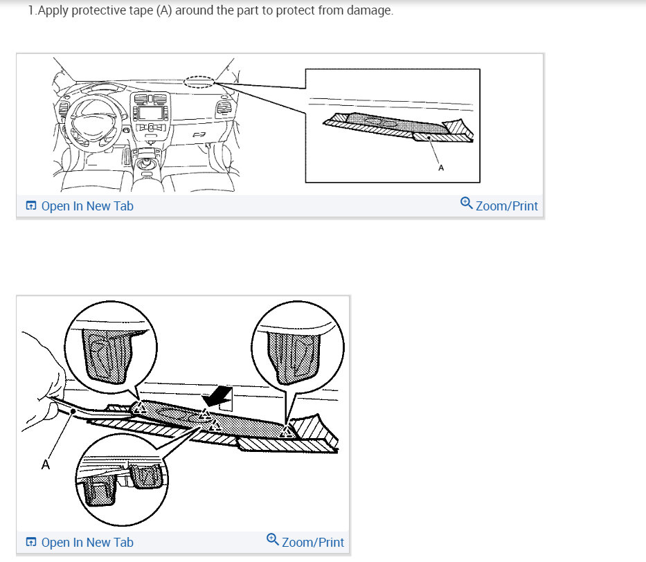

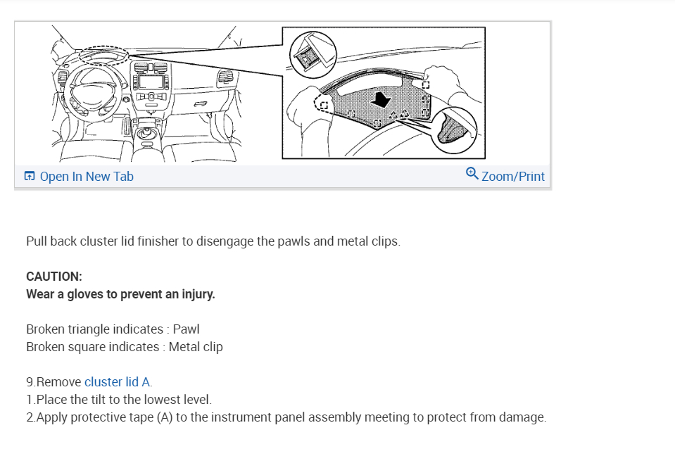

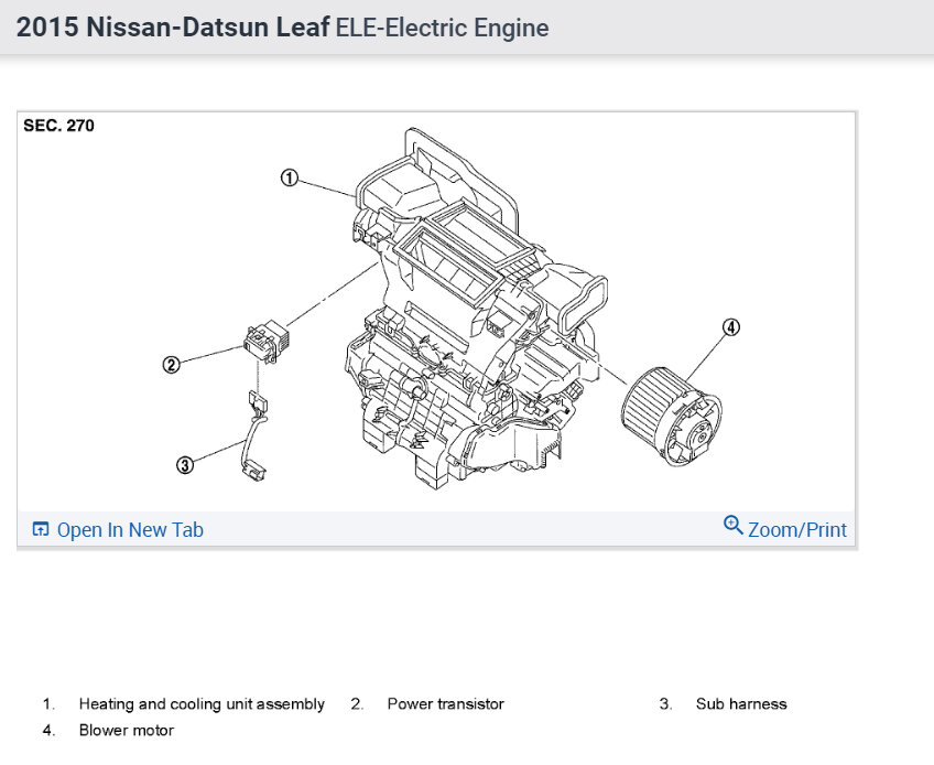

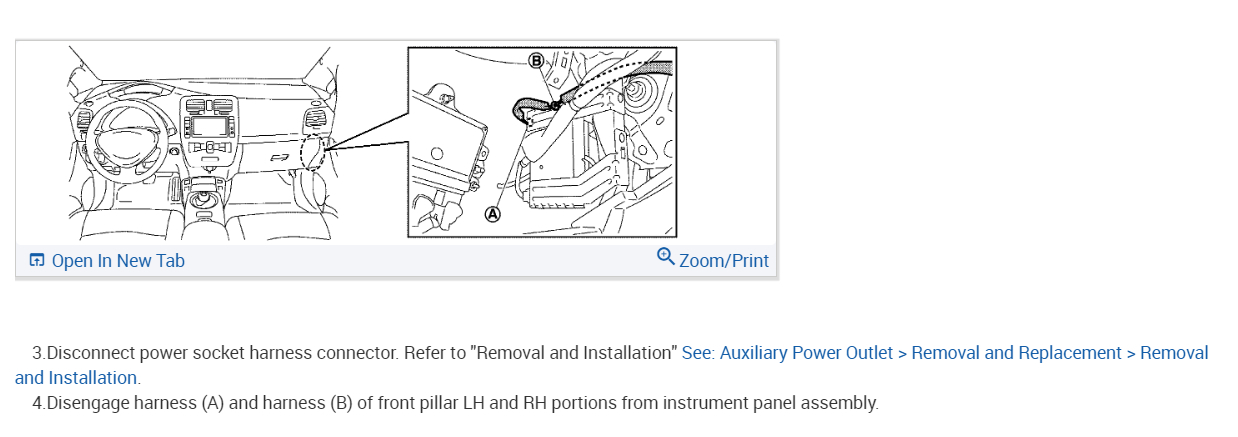

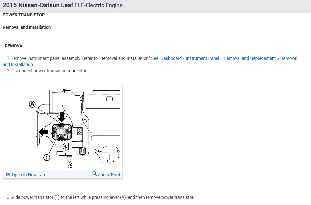

Speed does not change, blower works. It also stays on even if I turn the A/C off. After I shut off the car it stays on for 5-10 seconds, I am guessing it's the resistor. Can you share any instructions on replacing it? I heard it is on the left side of dash and it may be pain to replace.
Aug 21, 2023 at 12:48 PM
  • CAR REPAIR CONTRIBUTOR
  • 54,433 POSTS

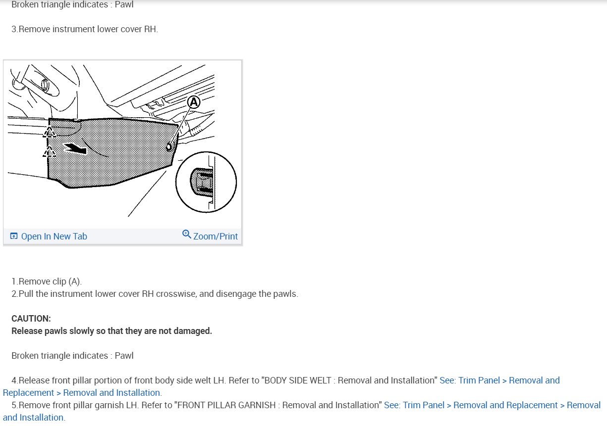

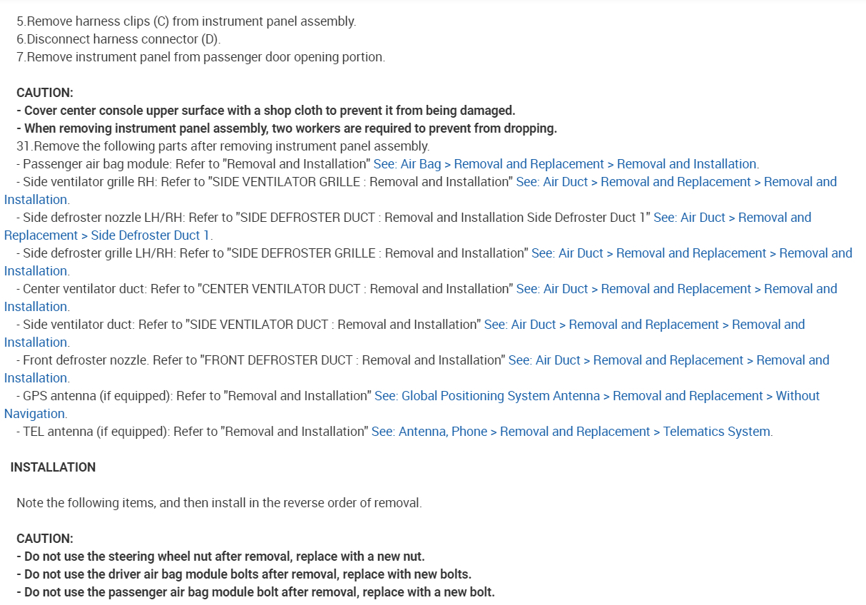

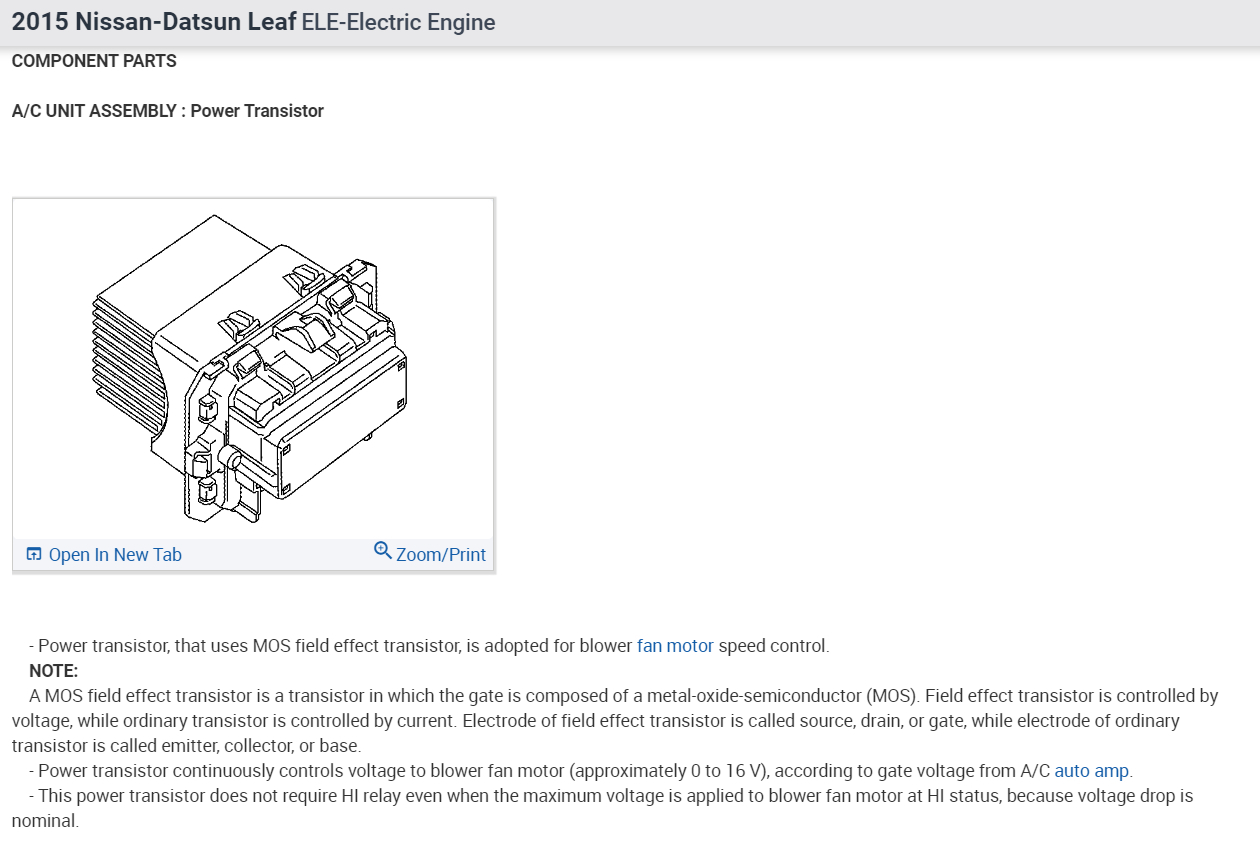

Yep, I agree it is the blower motor power transistor. It is in the HVAC plenum in the upper left side, here is the location of the unit and what it looks like. Check out the images (below). Please let us know what happens.
Aug 21, 2023 at 4:12 PM
BHAMDOC1973
  • 2,007 POSTS

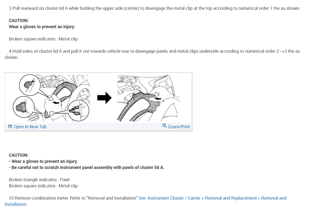

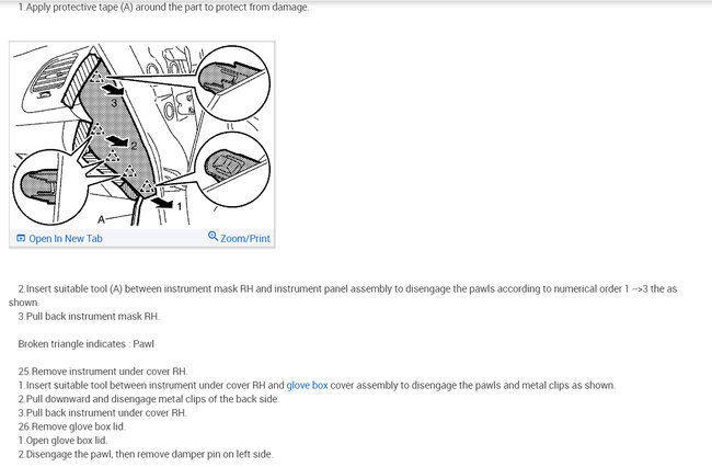

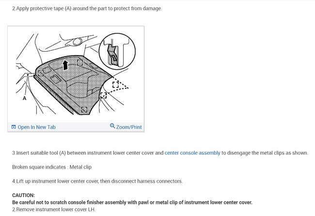

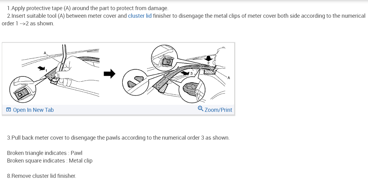

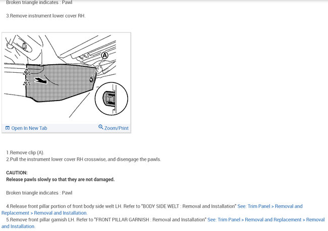

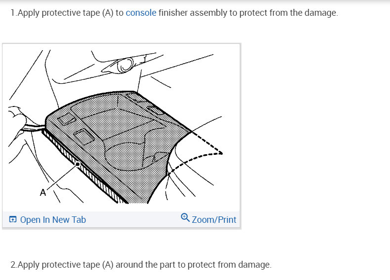

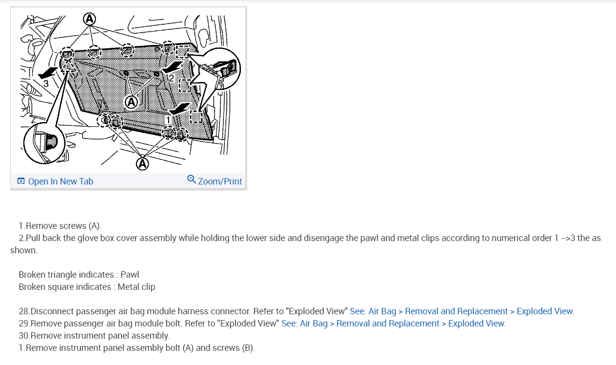

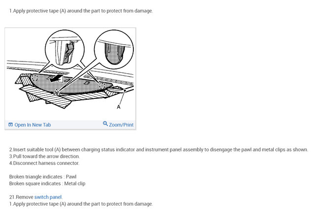

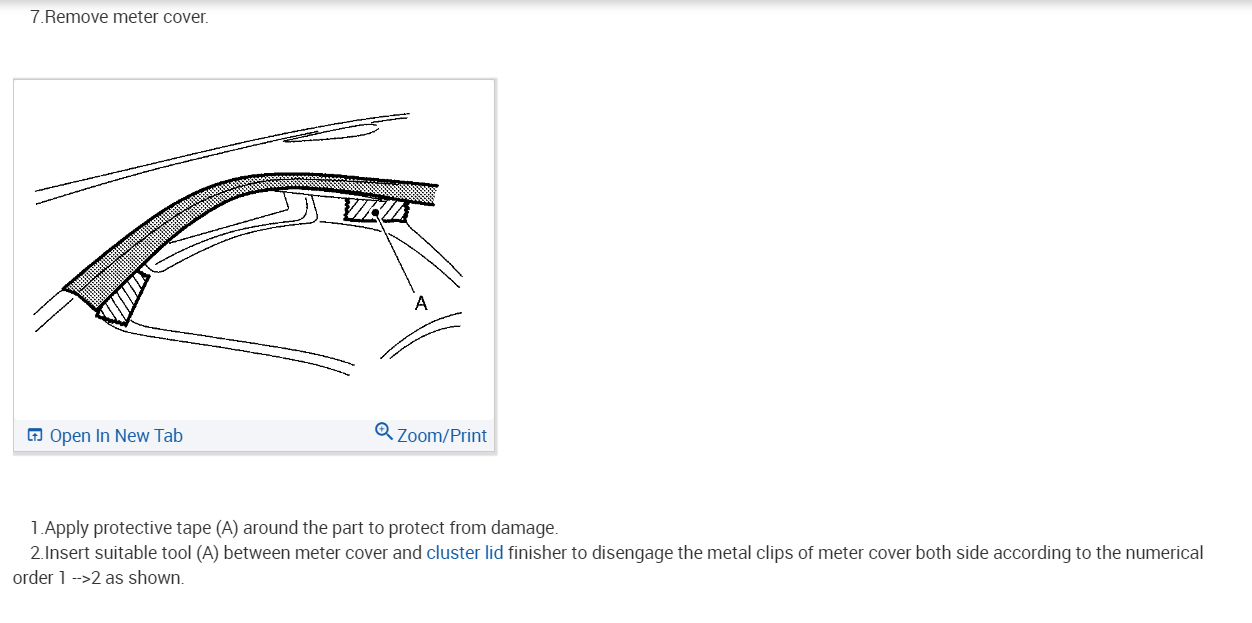

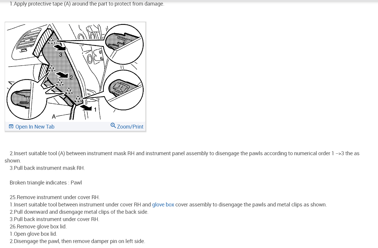

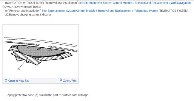

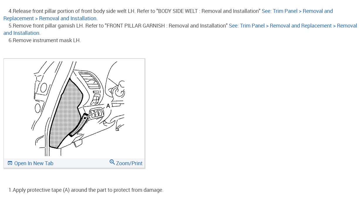

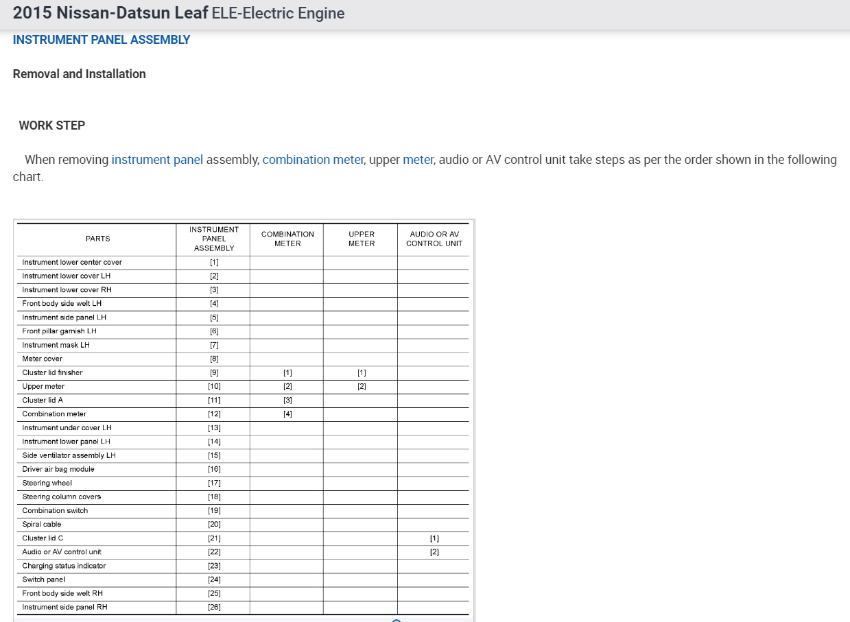

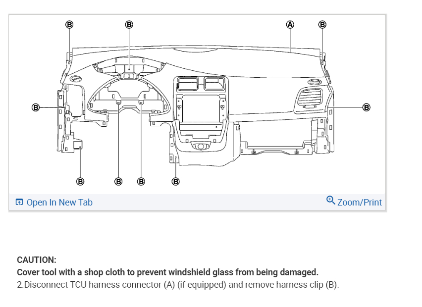

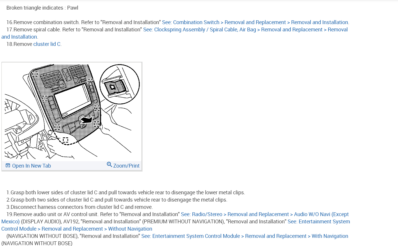

so, what is it asking to remove? the middle vac display?
Aug 21, 2023 at 4:15 PM
  • 54,433 POSTS

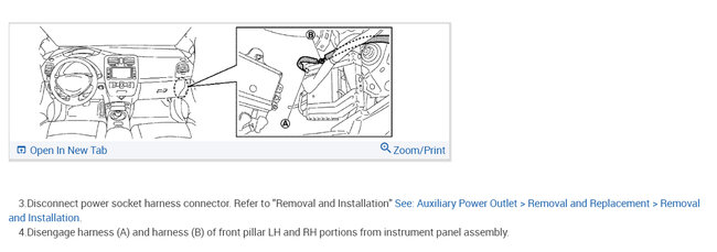

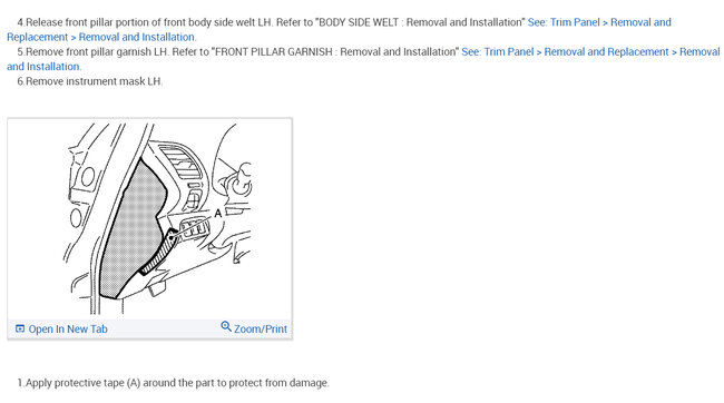

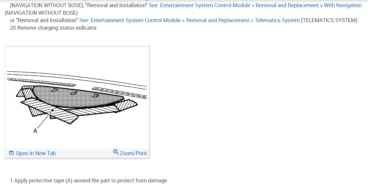

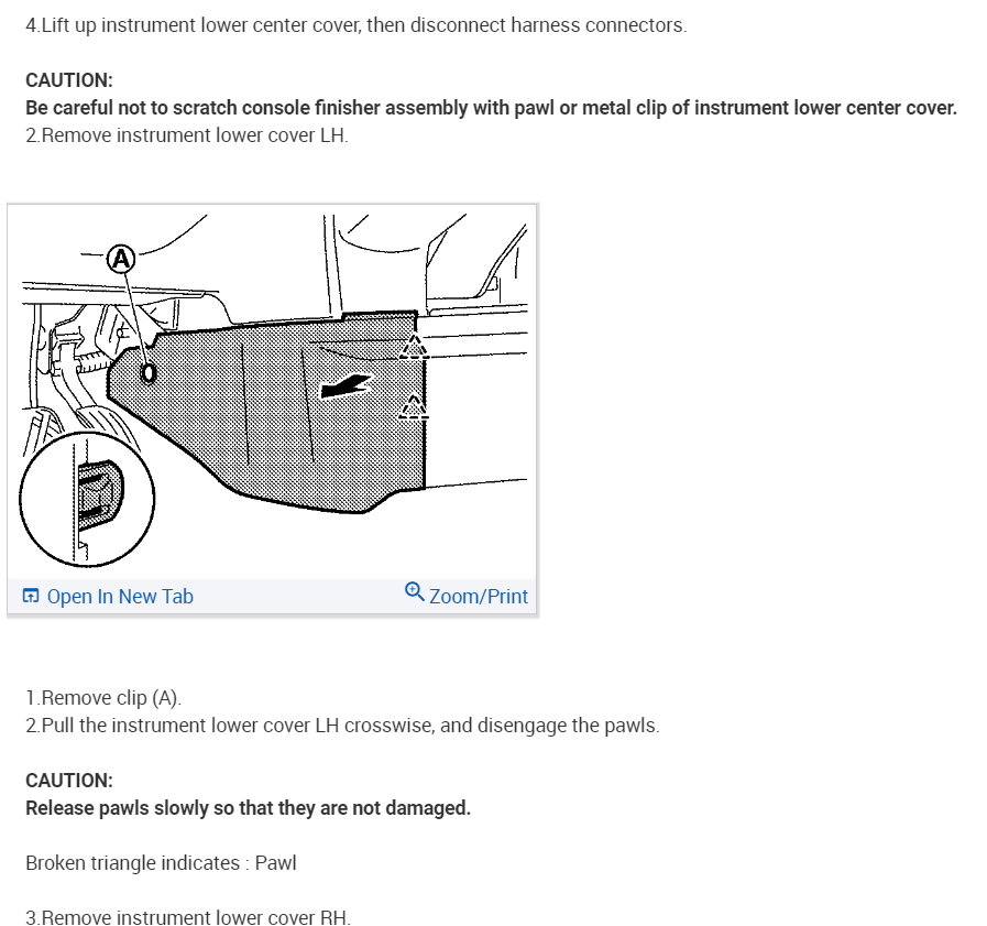

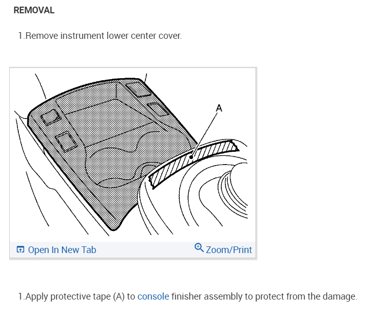

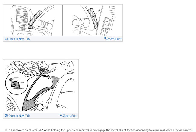

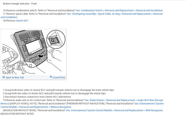

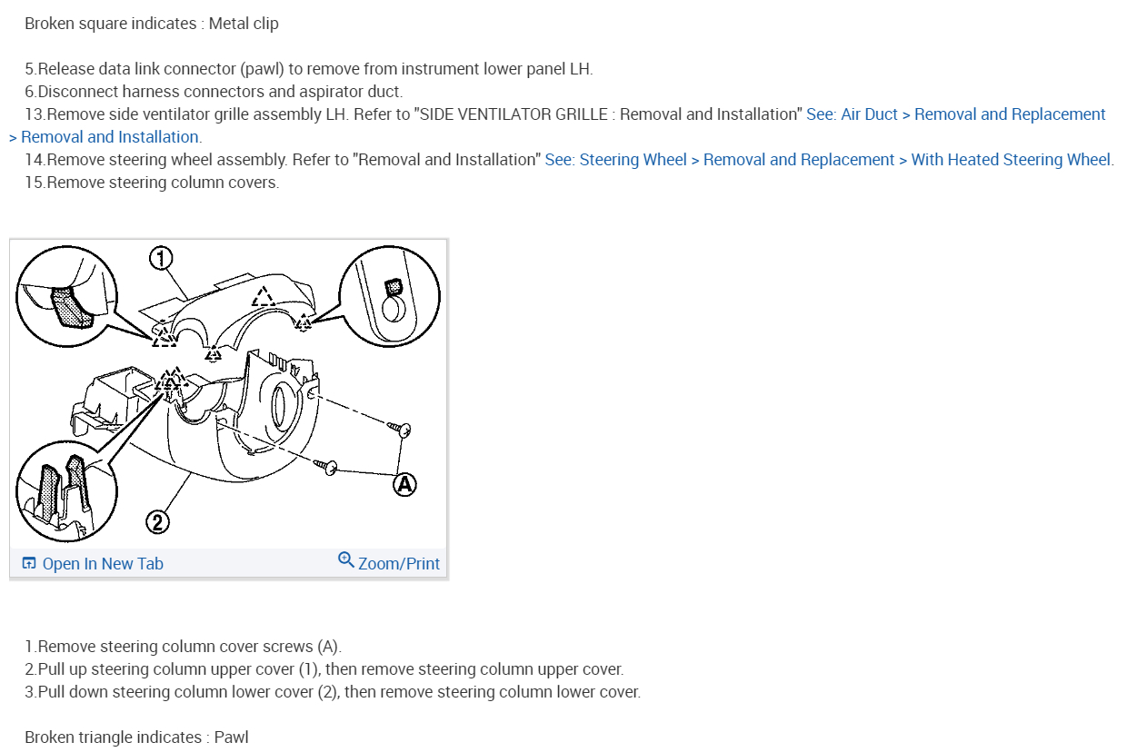

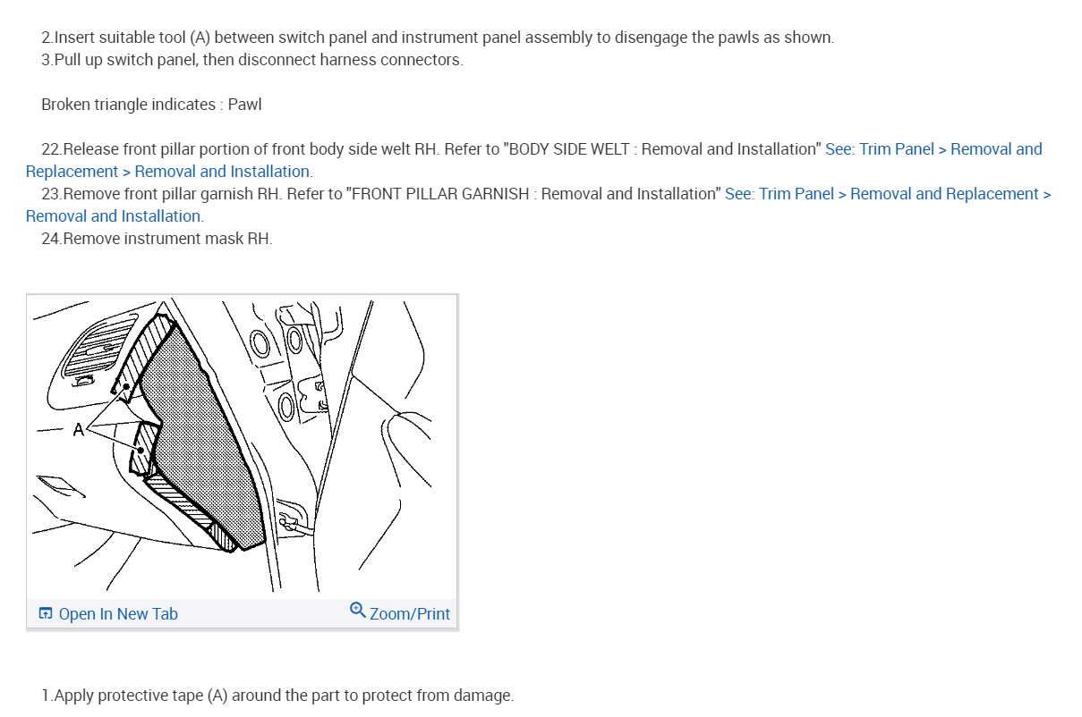

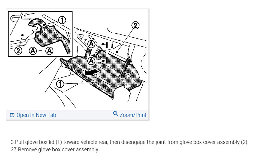

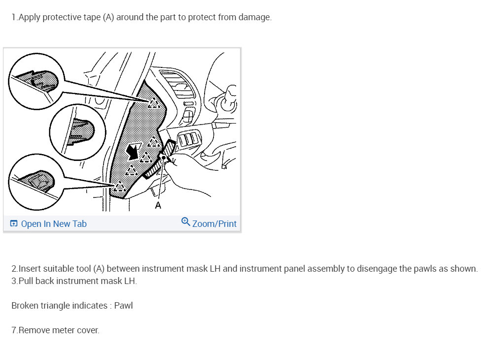

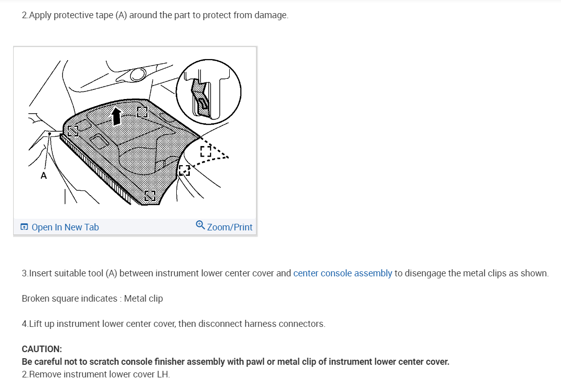

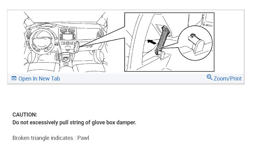

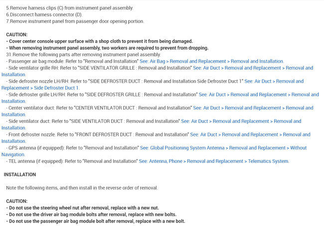

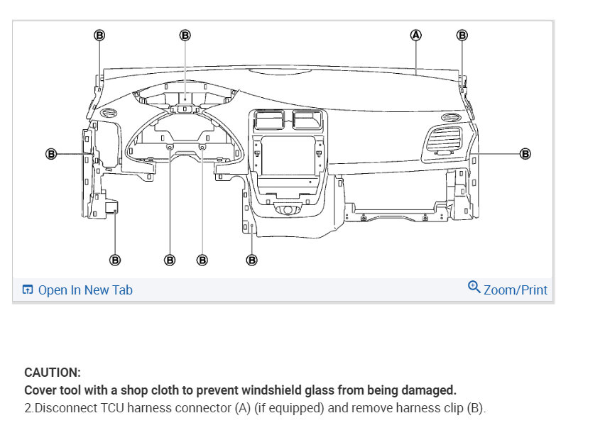

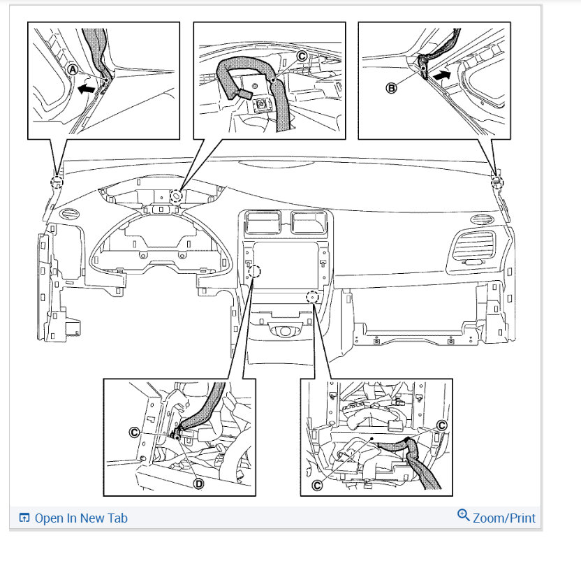

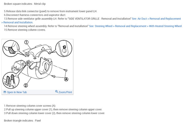

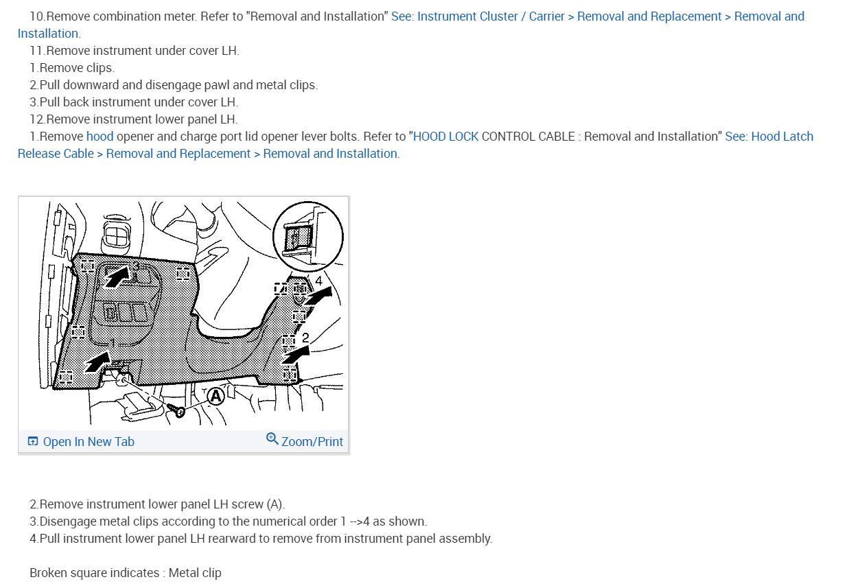

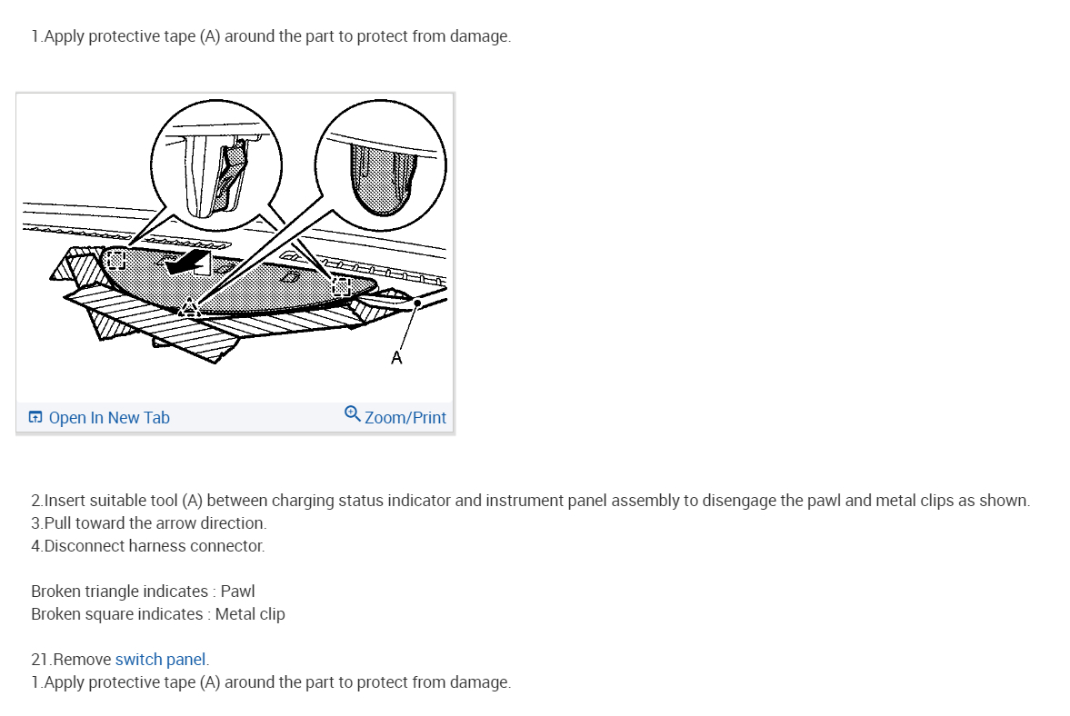

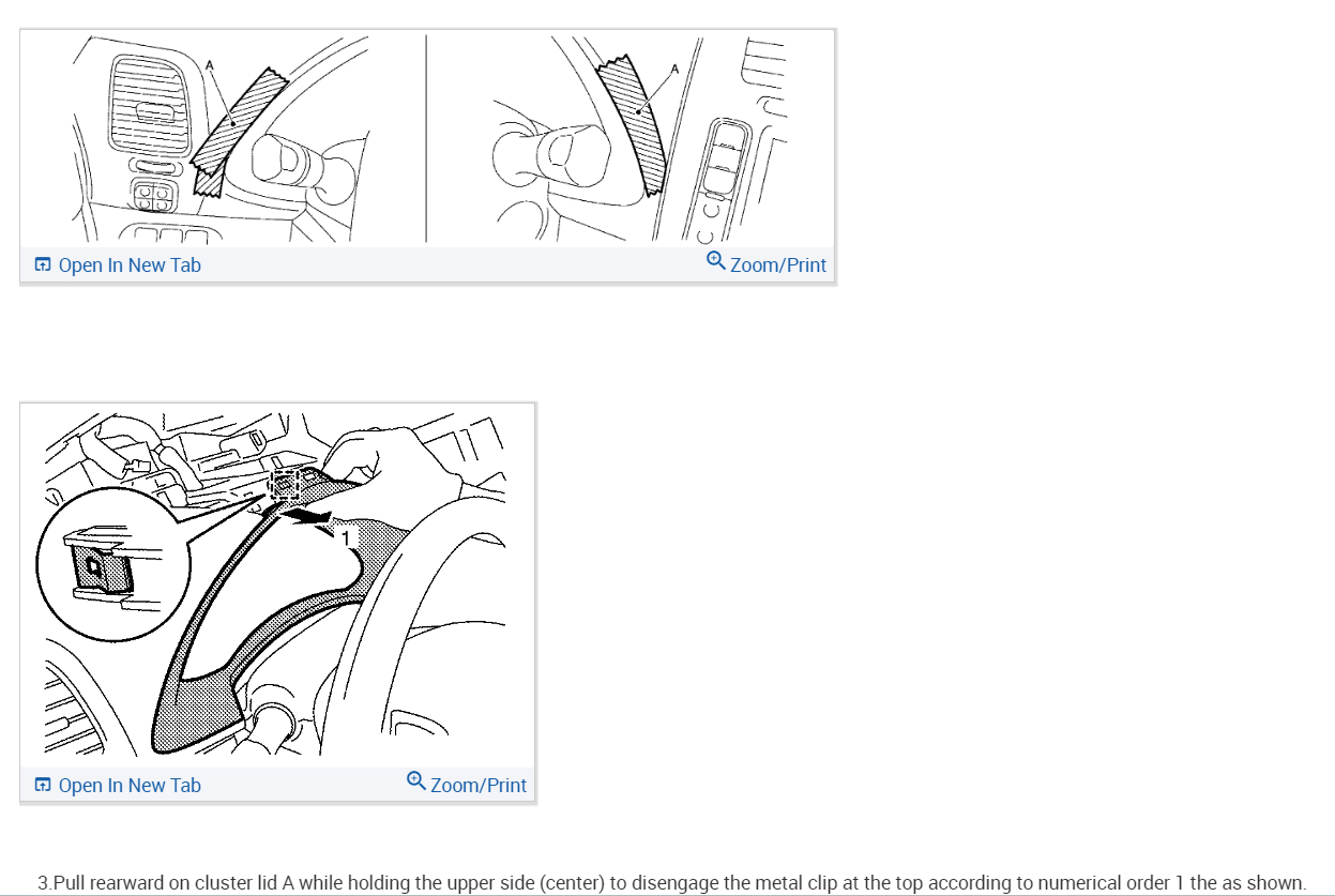

So, it looks like the dash will need to be removed, here are the instructions. Check out the images (below). Please let us know what happens.
