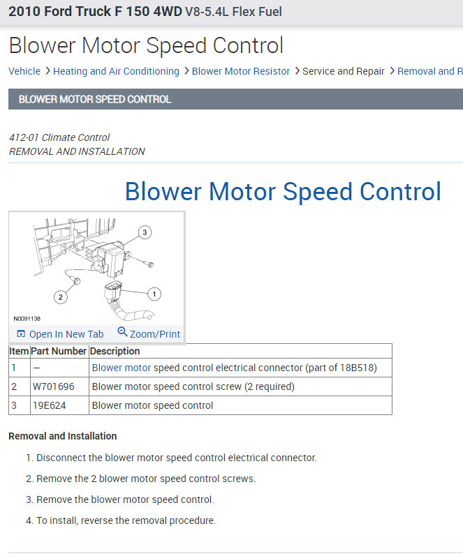

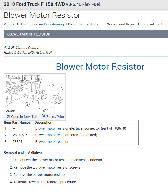

A/C blower control low fan speed stopped working
2010 FORD F-150
115,000 MILES • 5.4L • V8 • 4WD • MANUAL
CONACH
On the dash is a dial for 4 speed fan for A/C and heat. The low fan speed has stopped working. Only the 2 top fan speeds are working. I’m not sure what to check first.

It sounds like an issue with the blower motor resistor.
That resistor can go bad and will only come on in certain speed setting.
This truck also has a blower motor speed control unit which can also trigger similar issues.
But the resistor should be checked first.
To access the resistor you will have to remove the panel below the glovebox on the passenger side.

I have attached diagrams for your reference
