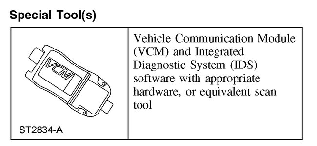

Replaced ABS module. Brake light warning turned off after module replaced. Main computer not recognizing module. ABS. warning light still on. Did have both brake and and light on, now just ABS. shows all sensors good.

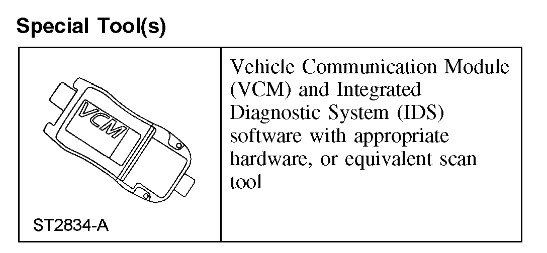

When installing a new ABS module, it must be configured (using vehicle as-built data) and calibrated. You need a scan tool that has calibration functions. What this done? It requires a vehicle communication module and the correct software.
See picture 1.
