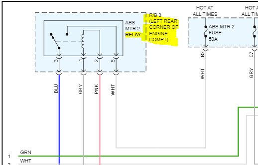

Can you find out for me the part numbers for the two ABS relays on this car, one on the right and one on the left side of the car under the hood.

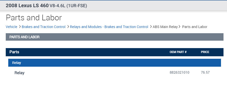

What I was able to find was part number 8826321010. I attached the parts/labor info below for your review.

I just went through the wiring again. There only appears to be one ABS main relay. Have you found two or has someone told you there are two? I have been wrong in the past and will be again in the future (LOL), but from what I see, there is only one.
Thursday, October 13th, 2022 AT 6:43 PM
BHAMDOC1973
  • 2,018 POSTS

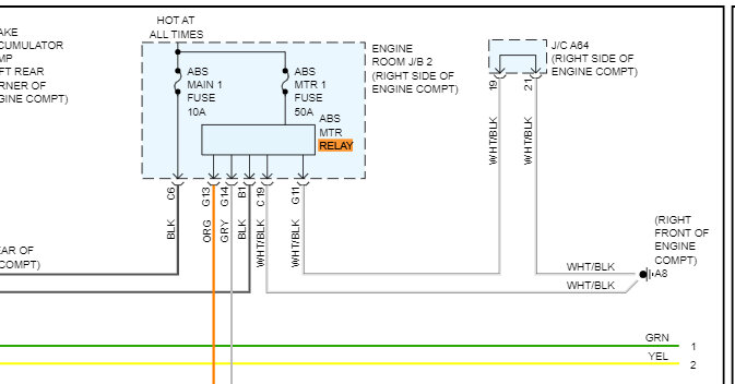

Hmm, that is what my friend was told, but online more than one video shows 1 on right side and another on left side in relay boxes, unless its fuses.
Thursday, October 13th, 2022 AT 6:57 PM
  • 110,194 POSTS
I just found it and you are correct. I didn't realize they had them in two different relay boxes. I had to page in 4 pages in the schematic to find the second one.

Can you get the part numbers?
Thursday, October 13th, 2022 AT 8:09 PM
  • 110,194 POSTS
The part number I attached above is correct. The relay must be the same type because it is the only one listed.
