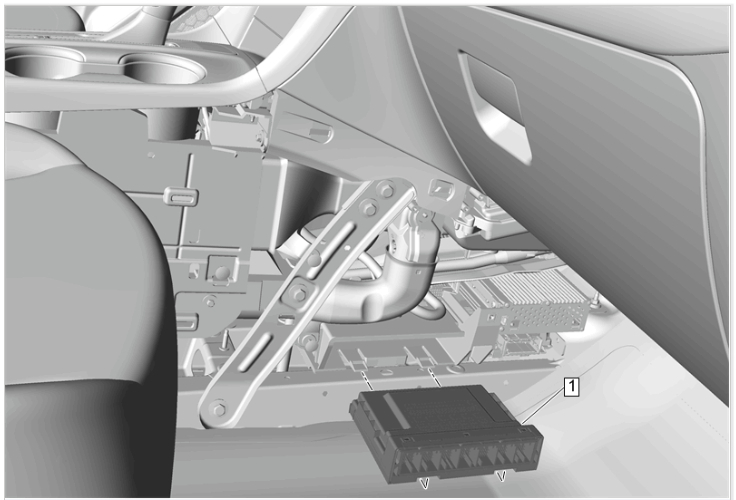

The fact that is happens after the rain it can be you have an issue with the CAN BUS system, did you see any wiring connectors that are damaged, does the car have water inside on the carpets? I would disconnect the battery and looks for corrosion at the BCM, here is its location. You pushing the brake pad back into the caliper will not cause this problem. More like a large part of the system is down, which can be the fuse panel. I would check all fuses with the ignition on (battery reconnected). Check out the images (below). Please upload pictures or videos in your response

I will check the BCM. Can I install a unprogrammed EBCM and drive said car to get it programmed? Would the car even start?

So some say the EBCM is the electronic brake control module other say is it the electronic body control module. They both need to be programmed in, but the brake control module shouldn't keep the car from starting, a bad body control module will.

Please go over this guide and get back to us. Also, I would when the battery is disconnected unplug the Body control module and check the pins for corrosion. Let us know how it goes
