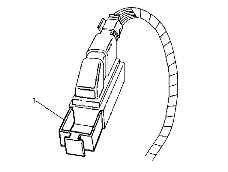

I'm working on the vehicle listed above and it has been messing up since I got it. So my question is, how do I disconnect the ABS because there is no main fuse under the hood.

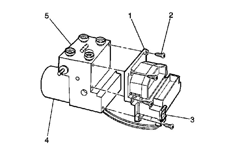

Good evening,
Did you check for codes for the system? Most of the time, it is just a sensor.
You can disconnect the wire harness from the module. I would look to repairing it as it is a safety feature.
Notice: Always connect or disconnect the wiring harness connector from the EBCM/EBTCM with the ignition switch in the OFF position. Failure to observe this precaution could result in damage to the EBCM/EBTCM.
1. Turn the ignition switch to the OFF position.
2. Remove the air cleaner housing from the engine compartment.
