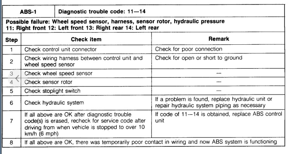

Usually (but not always) when starting it for 1 second, ABS light on. Then turn off it after 1 and restarting, ABS light off.
Occasionally:
ABS light suddenly on when driving. Then stop the car and restart it again, ABS light off.

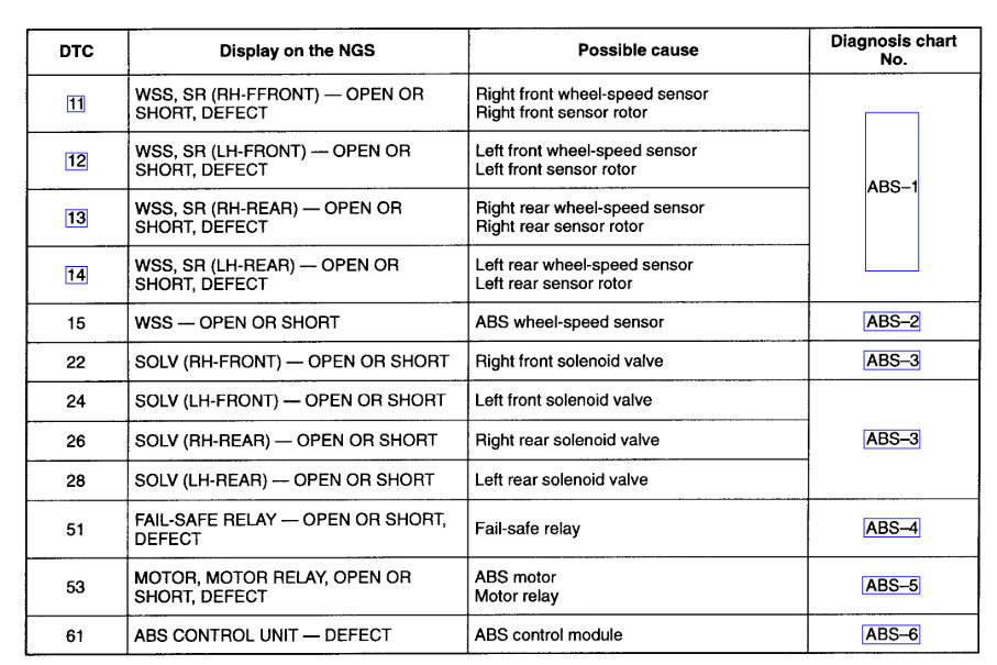

Code detected:
11 - Right Front Wheel Speed Sensor Open circuit or Short to power supply
12 - Left Front Wheel Speed Sensor Open circuit or Short to power supply
13 - Right Rear Wheel Speed Sensor Open circuit or Short to power supply
14 - Left Rear Wheel Speed Sensor Open circuit or Short to power supply
51 - Valve Relay fault
61 - ABS Control Module fault
I have changed a new ABS relay Ry1212 but it still happens randomly.

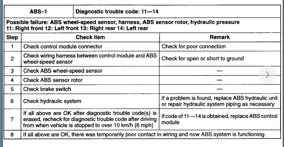

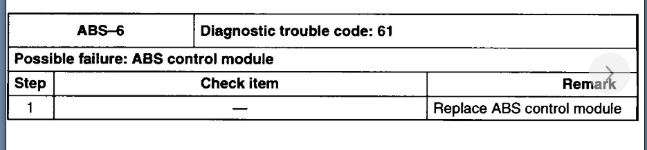

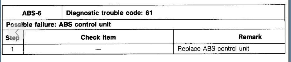

Based on these codes, you have an issue with the ABS control module. Code 61 gets right to the point and tells you to replace the unit. Then the wheel speed sensor codes support that. However, I included the wheel speed code diag because you need to check wiring at the module just to be sure it is the module causing all of these issues.
However, I am confident that you need to replace the ABS due to these codes. Let me know if you have questions. Thanks

I saw that one and I guess I made an assumption based on the other codes. However, I attached the testing for it. Basically it tells you to check the fuse and relay, then wiring. If they are all ok, the turn the ignition to the on position and see if the light stays on. If it stays on then replace the module.
The assumption I made is based on the other codes, I think the fuse and relay are fine which means the module is the issue.
