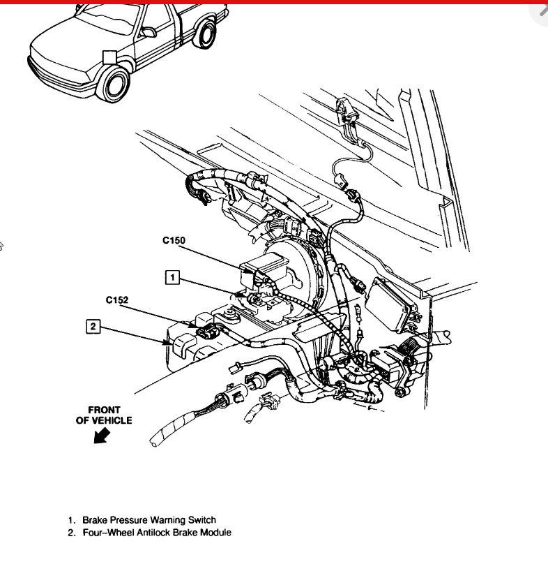

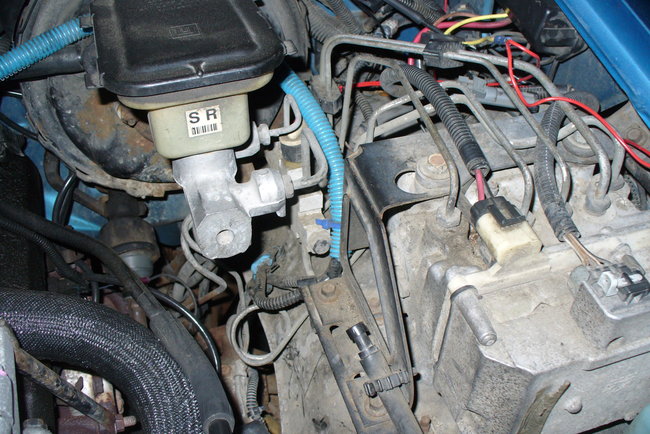

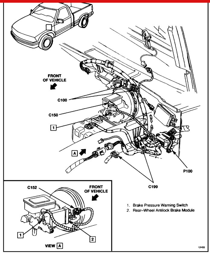

Please see the attached pictures. One is 4 wheel and the other is rear wheel.
Please let me know if you need more information.

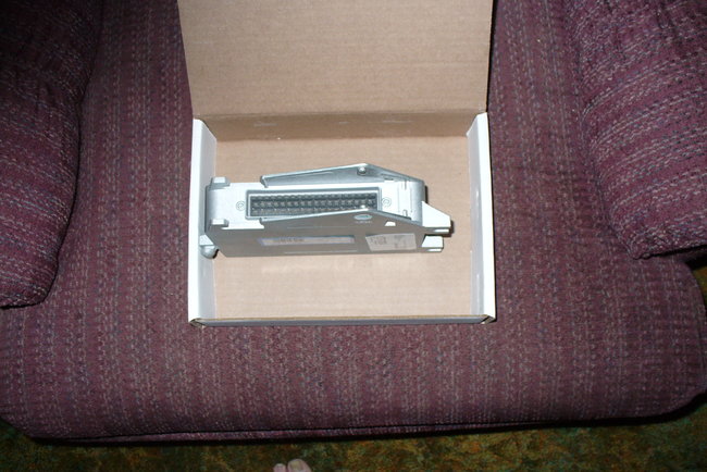

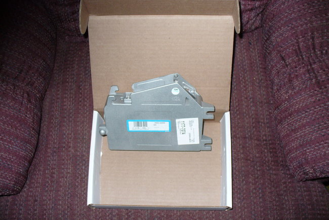

Thank you for your reply. I see the 2WAL control module mounted adjacent to the master cylinder. The 4WAL pic shows the ABS module but what I need is the "Control module" location the 4WAL.[ Shown in pic I have included I have looked under hood and under the cab along the frame. The module is not a small box it is approx. 8"x6"x1 1/2". Also a picture of my ABS module. Thanks again for any help you can provide!

I should have been a little more specific with my question. I know the ABS module HMV is on the left fender. I am looking for the control module. It is not in plain sight. [ Ref. Pics in previous post. Unlike the 2WAL it is not mounted by master cylinder Even if were partially blocked from sight I would have seen it. My best guess is it is behind the left kick panel The harness goes through the fire wall to right of the brake booster to see I have to take the bottom dash panel, door threshold and kick panel out. I am not looking to waste time pulling the truck apart unless I have no choice. I have spent hours looking at all the diagrams online and have not found anything addressing this control module. Still hope someone can help!

Can you send me the part number for that module? Thanks
Wednesday, October 2nd, 2019 AT 6:47 PM
DAVID BAILEY
  • 10 POSTS
The number on the box is ALB1599M. The number on the sticker on the part is ABS1599S. The case has 1599 stamped on it.

A little more info. I have a INNOVA GM Code reader. I read the codes and got 15 codes. According to the book 13 of the codes are "Control Unit Fault". I started with inspecting wiring checking the connectors. The resistance of speed sensors checked okay. Did not find corroded or loose connection. Sprayed all with Elect. Spray and applied dielectric grease, plugged everything back in I only get "control unit fault" for 13 different codes. The book says it is a Kelsey Hayes 4WAL I decided to replace the control module to eliminate this nagging dash light. The diagnoses was about 2 years ago. The unit I bought was what all the part stores call for #1599. Chilton"s repair manual does not address Kelsey Hayes as the mfg. And only a picture of the EHCU. If I can provide any more information let me know.

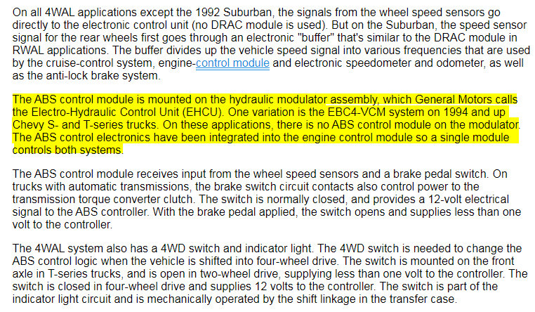

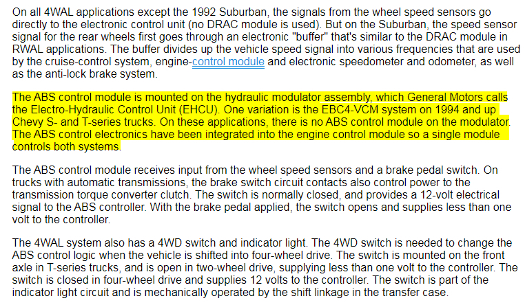

I am finding conflicting information and have not been able to sort it out yet. I looked up that part and it is available for your truck. However, I suspect that this because there are other options for your model year. Meaning not all 94 Sonoma's had the same system. This means the ABS control module does not apply to your vehicle. Please see the attachment and the highlighted portion.
I am asking one of my GM dealers to confirm this. I will let you know what I find.
+2

I am really disappointed in repair manuals lack of information. It looks like you have found the information. I could not. This makes a diagnosis of "Control Module Fault" a little more difficult.
+1

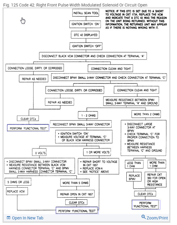

I'm in no hurry. I cleared the codes key on light on for about 2 seconds then light goes out. Light came back on after driving about 50 ft. I cleared codes again and left the truck for a couple hours. When I came back I plugged the reader in to see if it flashed 12 or 14 system normal. It flashed the codes I thought were erased. I did not sit through the whole list at this point it was better for me to just walk away! I do have a good spare PCM. I installed it and drove the truck for a week with no problems but I wasn't working on the brakes then. I put the original back in. Do you think it would benefit me to swap them out and read codes again?

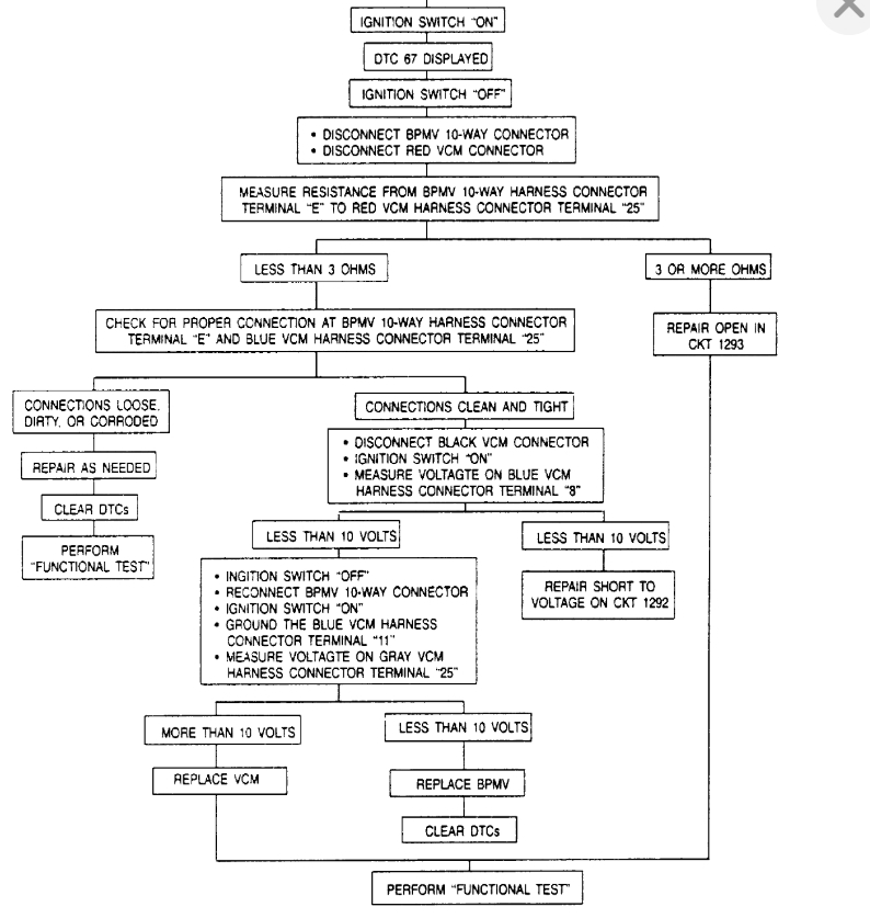

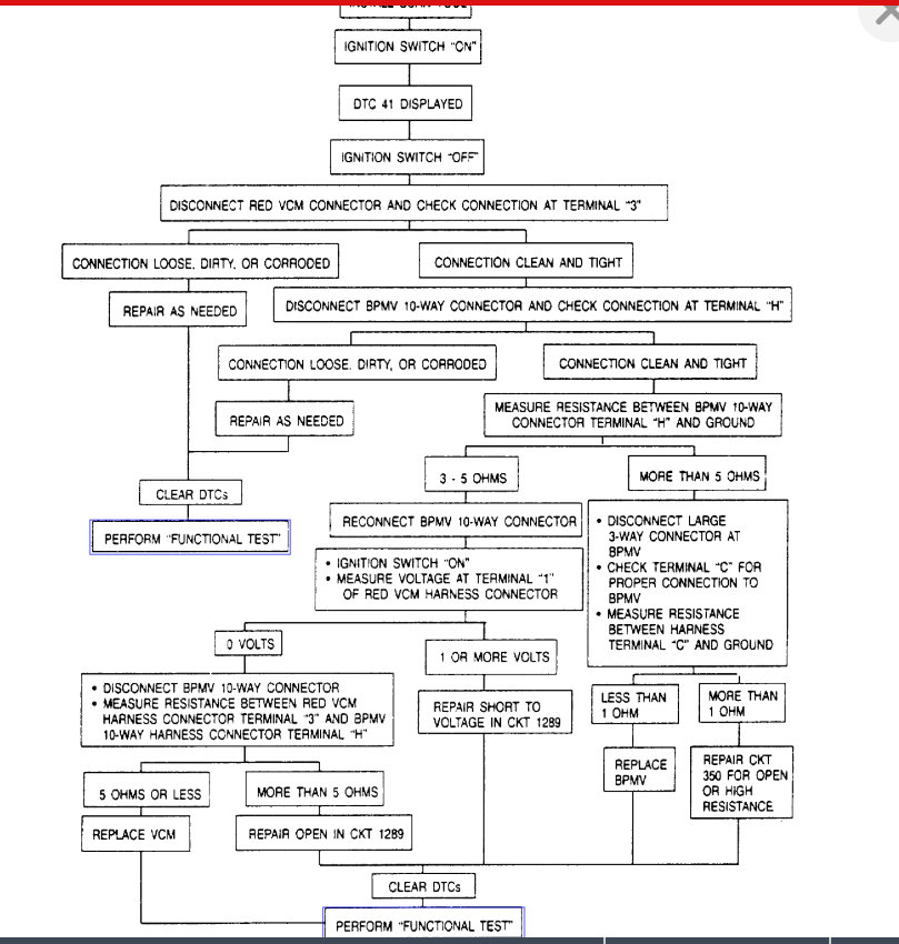

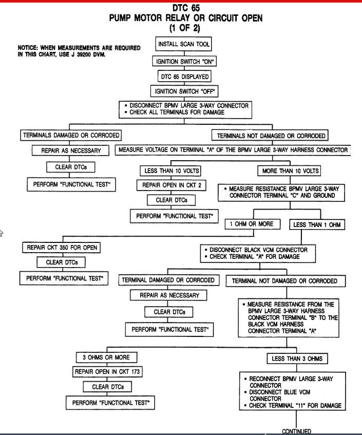

I attached a couple of the flow charts that we need to run through. I think you may have a VCM/ABS module issue. Let's run through the flow chart for code 67 first then 65. They are the last two.
When you changed out the module did any of these come back with that one in it?

Got It! This will take a while. Where can I get access to the Flow Charts? I have looked for a Factory Service Manual and only found one site that is out of stock. If the charts are in the factory manual I could eliminate a lot of the back and forth here. I could contact you if I have a problem.
Wednesday, October 9th, 2019 AT 3:04 AM
Take a look at the attachments I posted in the last post. They are they flow charts but unfortunately I don't have the pin out charts for each connector. However, the pins should be labeled on the face of the connector.
First attachment is code 41, then 42, the 65, and finally 67.
