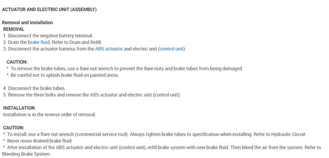

If I replace my entire ABS module, pump and all, and buy a used one with all the same numbers etc; Will I have to have it reprogrammed/reflashed?

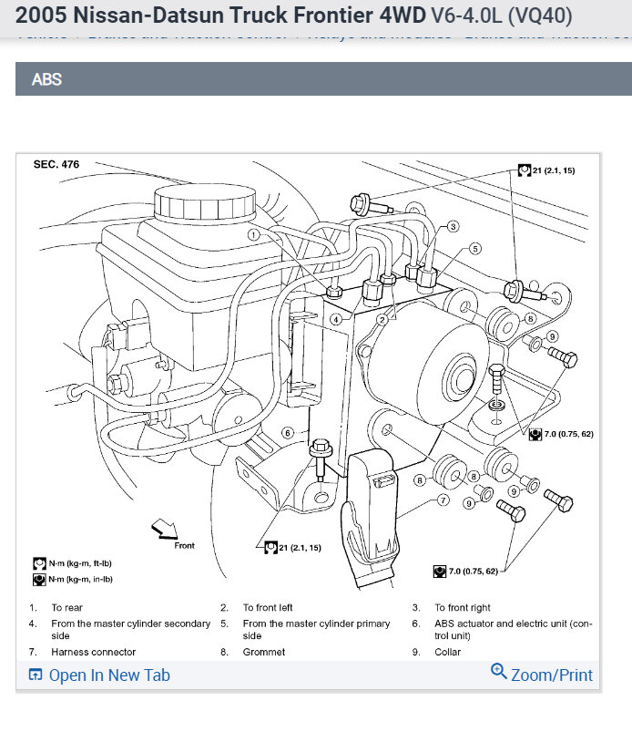

Nope, here are the instructions and they don't mention having to program the unit. Check out the images (below). Please let us know if you need anything else to get the problem fixed.
