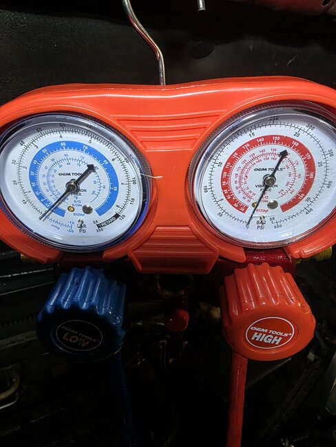

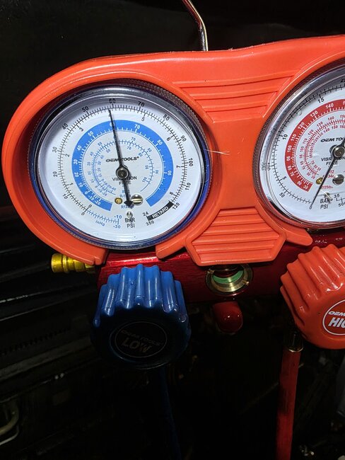

Yes, there is pressure inside the system. I connected the gauge the low pressure side reading is between 60 and 70 but for the high pressure, as soon i slowly start turning on the valve, the line start leaking freon and making loud hissing noise from the end connection. I can see freon bubbling inside the tiny glass like a hot bowling water. The more i open the valve, higher the reading but also louder the hissing noise and more freon coming out. For safety reason and i did not want to release to much freon in the air, i turned the valve off and stopped. First pic shows both low and high lines are connected but valves are not turned on yet. Second Pic only low pressure valve is on.For some reason i'm not able to load either a pic or a video of the high pressure where it's leaking and making hissing sound. I tried my to explain the issue. Hopefully you get it. Thanks
Sep 23, 2025 at 12:21 AM
  • 54,494 POSTS
Yep, it sounds like the system has a large leak, can you tell where it is coming from?

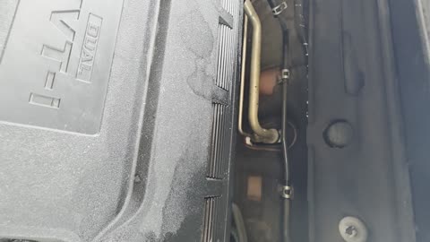

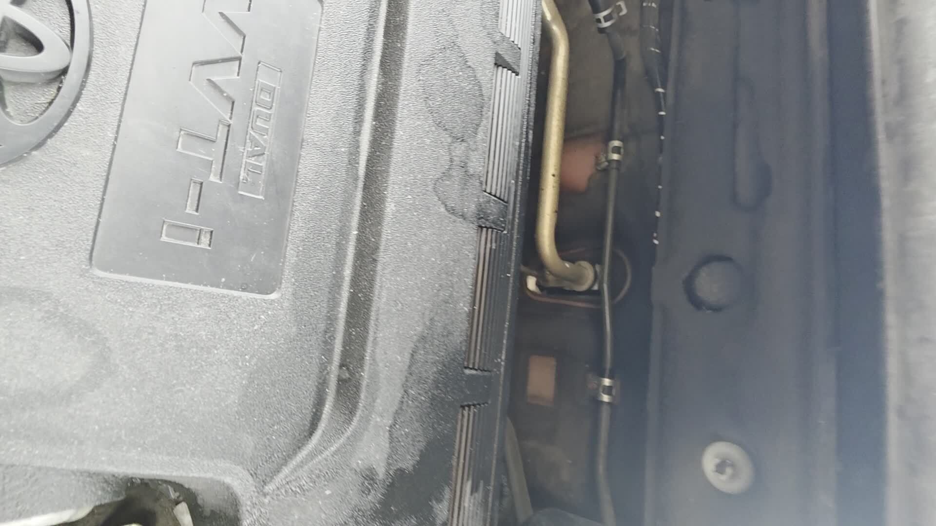

I may have found where the leak is coming from. I spray soapy water where both H and L are connected. I can bubbles coming out and on the bottom below the H line it look like a bowling water. Could this be the evaporator?
Sep 25, 2025 at 10:12 AM
  • 54,494 POSTS
Thanks for the video, if you did overcharge the system the compressor has a pressure relief valve which can leak once it has allow pressure to bled off. Please go over this video it will help.

Yes it's bubbling really bad when I use soapy water
Sep 25, 2025 at 10:56 AM
  • 54,494 POSTS
Then you found the leak, the expansion valve O rings must be bad or the expansion valve itself is leaking, I would watch the video again so help you see if any pressure is left is the system and then remove he valve and get a new part for it, then vacuum down and recharge it.
