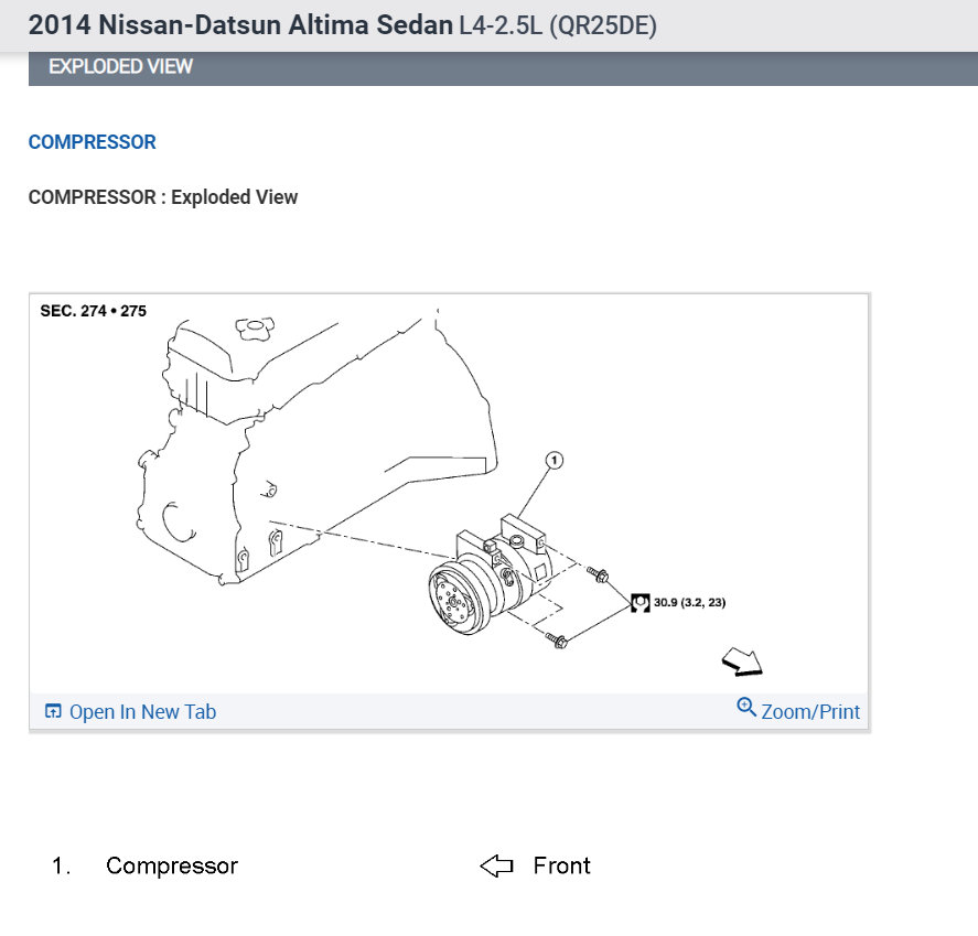

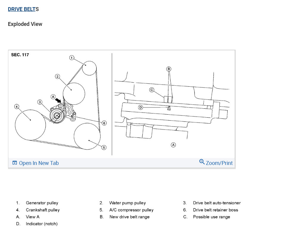

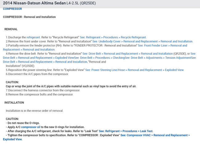

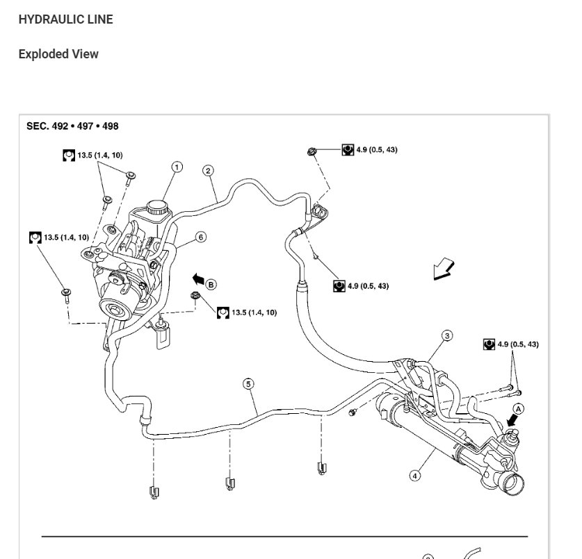

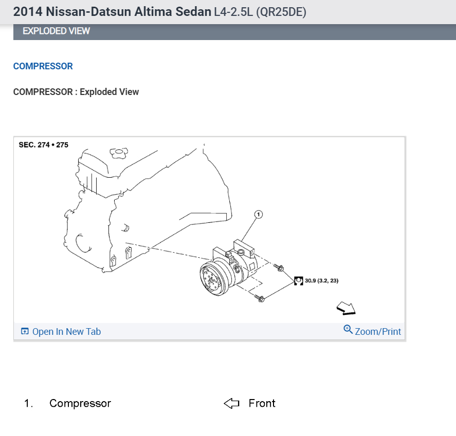

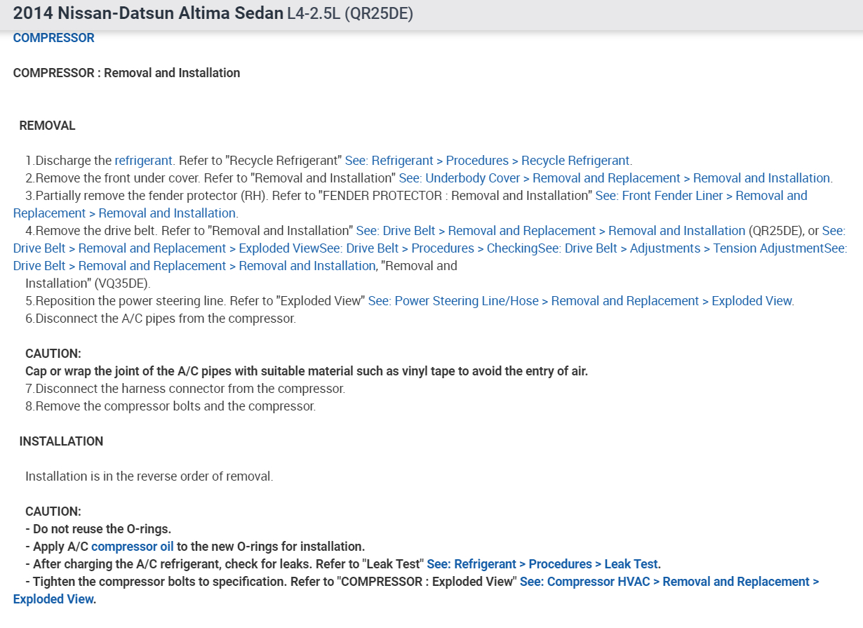

There is no blockage, the compressor is going out here is a guide and video to help you change it out with instructions in the images below to help you with your car. Here is a generic guide to help you see the steps. It looks like for your car you will need to remove the fender liner and reposition some power steering lines, not too bad.
