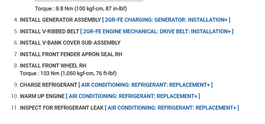

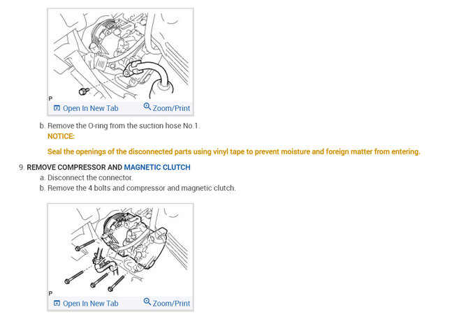

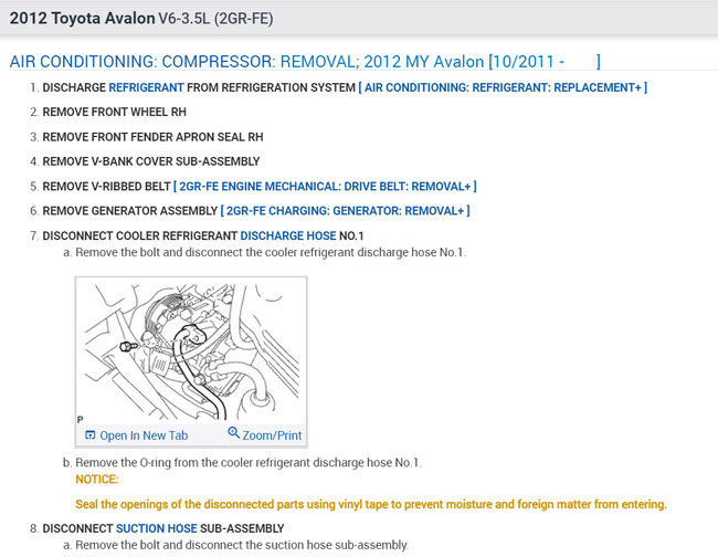

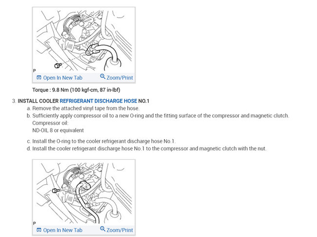

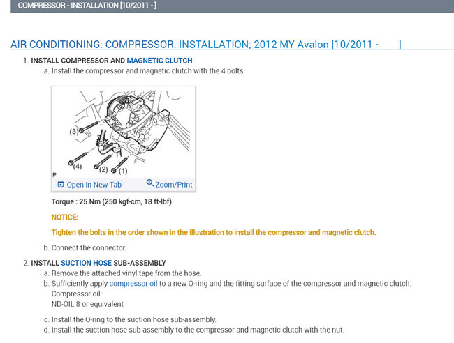

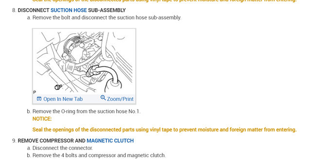

This sounds like the compressor is going out. Here is a generic guide to help you step by step with instructions in the diagrams below to show you how on your car:
https://www.2carpros.com/articles/replace-air-conditioner-compressor
Please go over this guide as well:
https://youtu.be/4EqdrBVb0sY
Check out the images (below). Please let us know if you need anything else to get the problem fixed.
