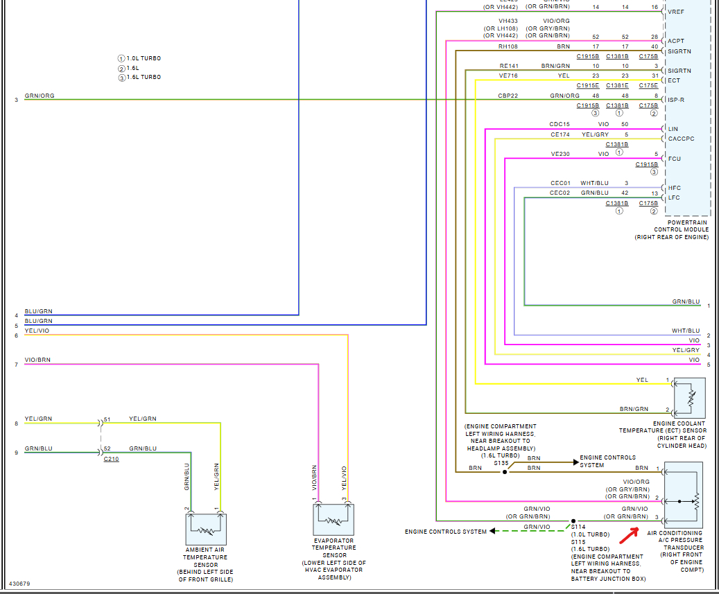

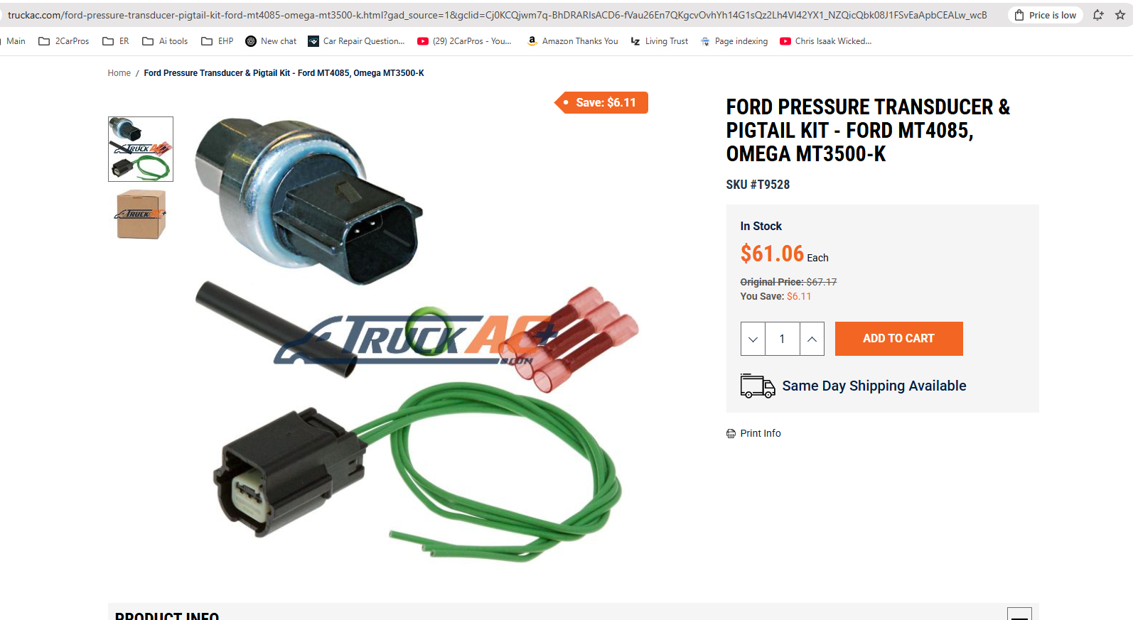

I had to replace the A/C condenser because of damage to the front passenger side. I think the plug that goes to this sensor at the bottom of the A/C condenser was cut off during the wreck. I need to replace but do not know the colors of the wire that goes to it or the type of plug. I have a pic of the only wire that i can find exposed. These wires are currently hanging out the side of the car.

I don't have the connector view but here is the wiring diagram for the pressure sensor at the condenser. There should be small numbers on the connector to help fix the wiring. Check out the images (below).
