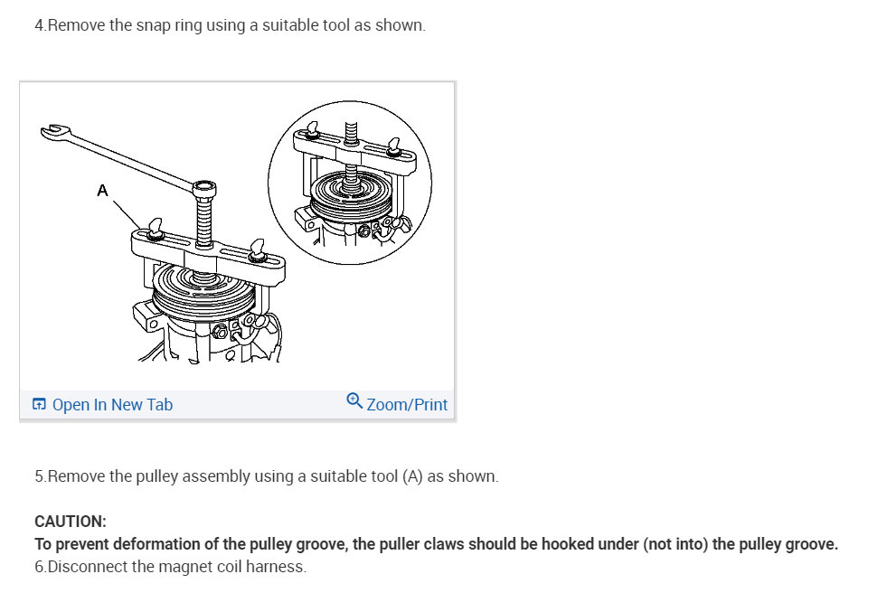

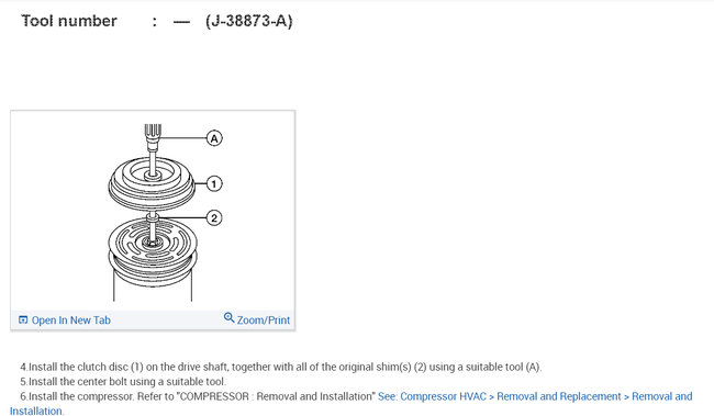

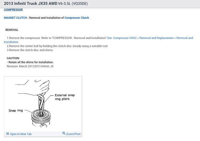

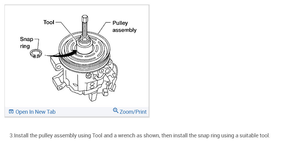

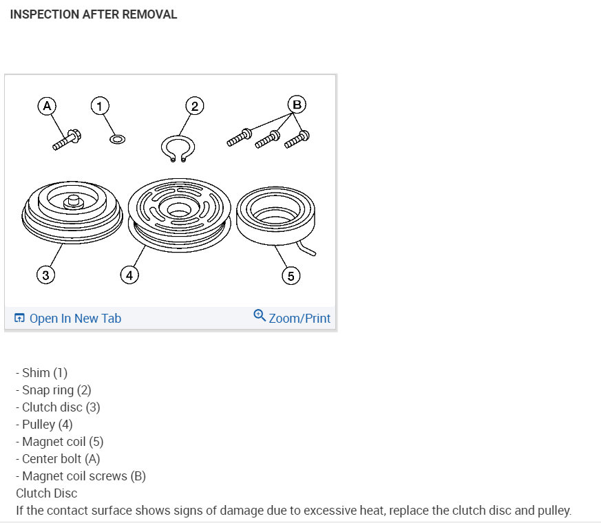

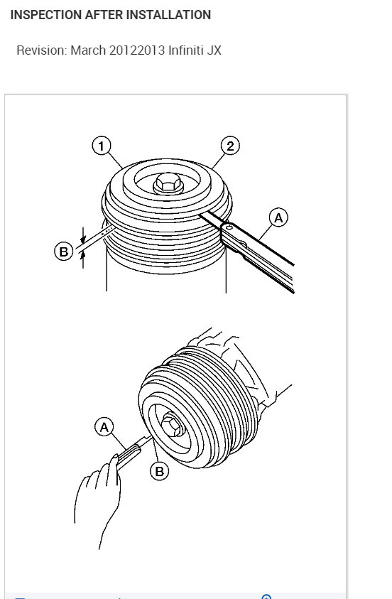

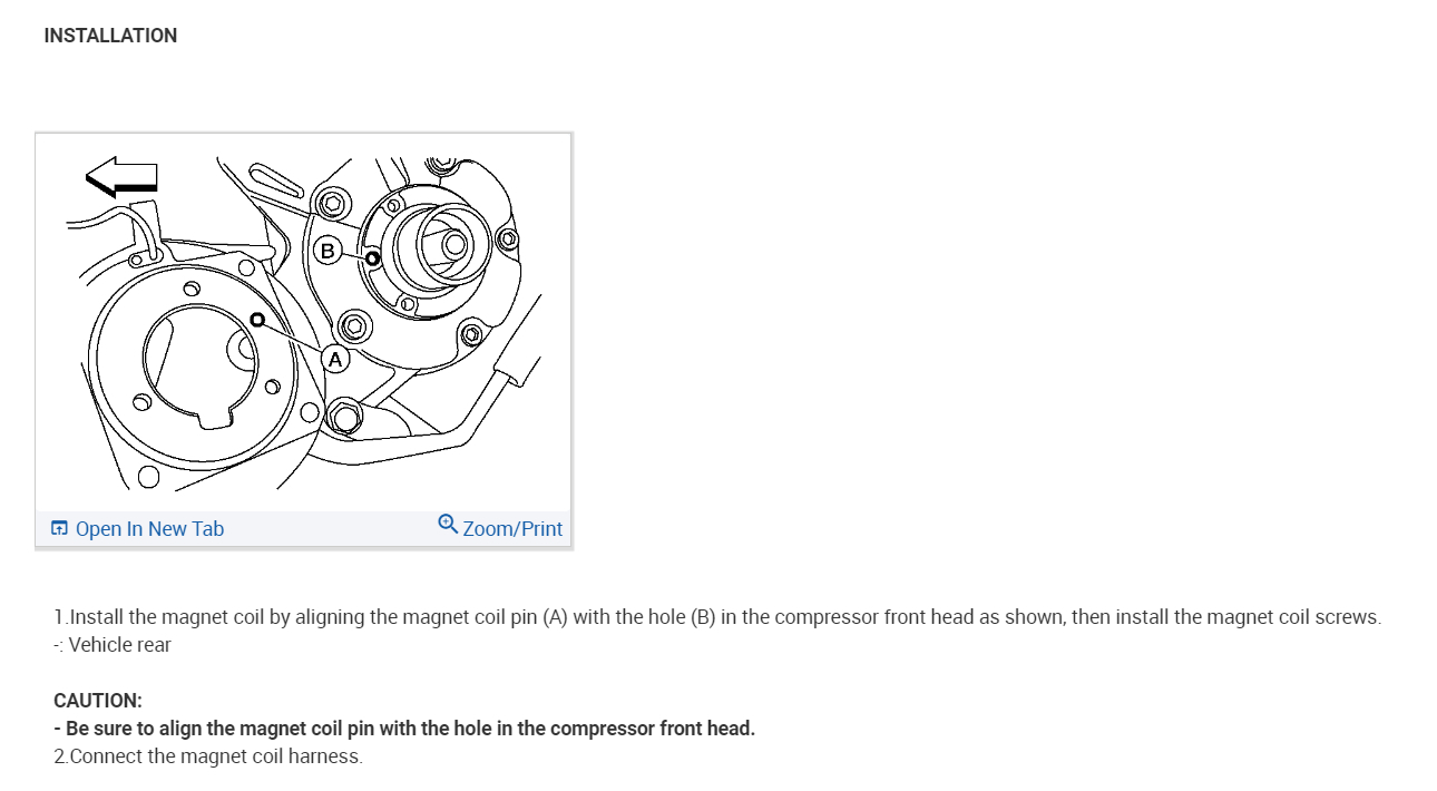

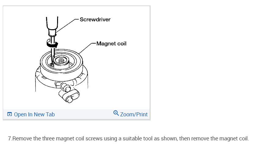

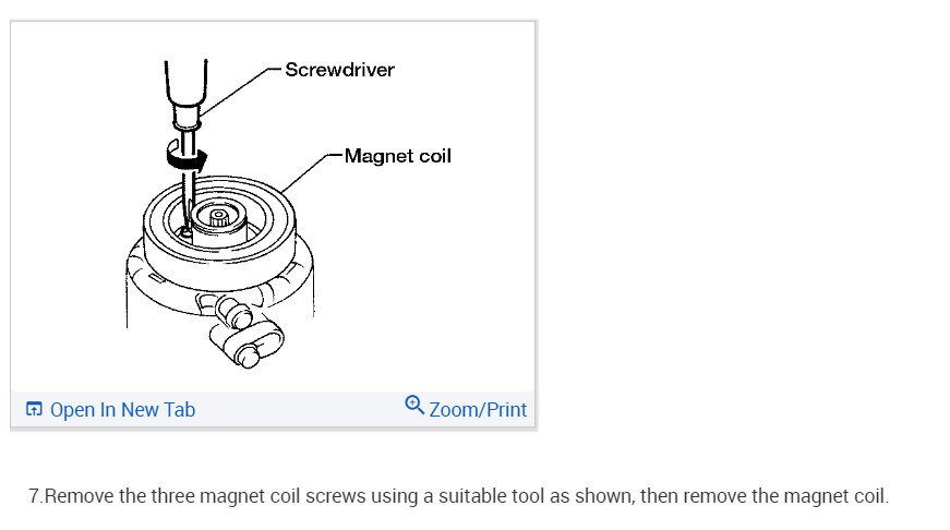

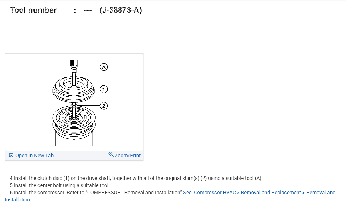

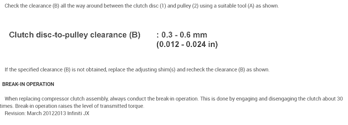

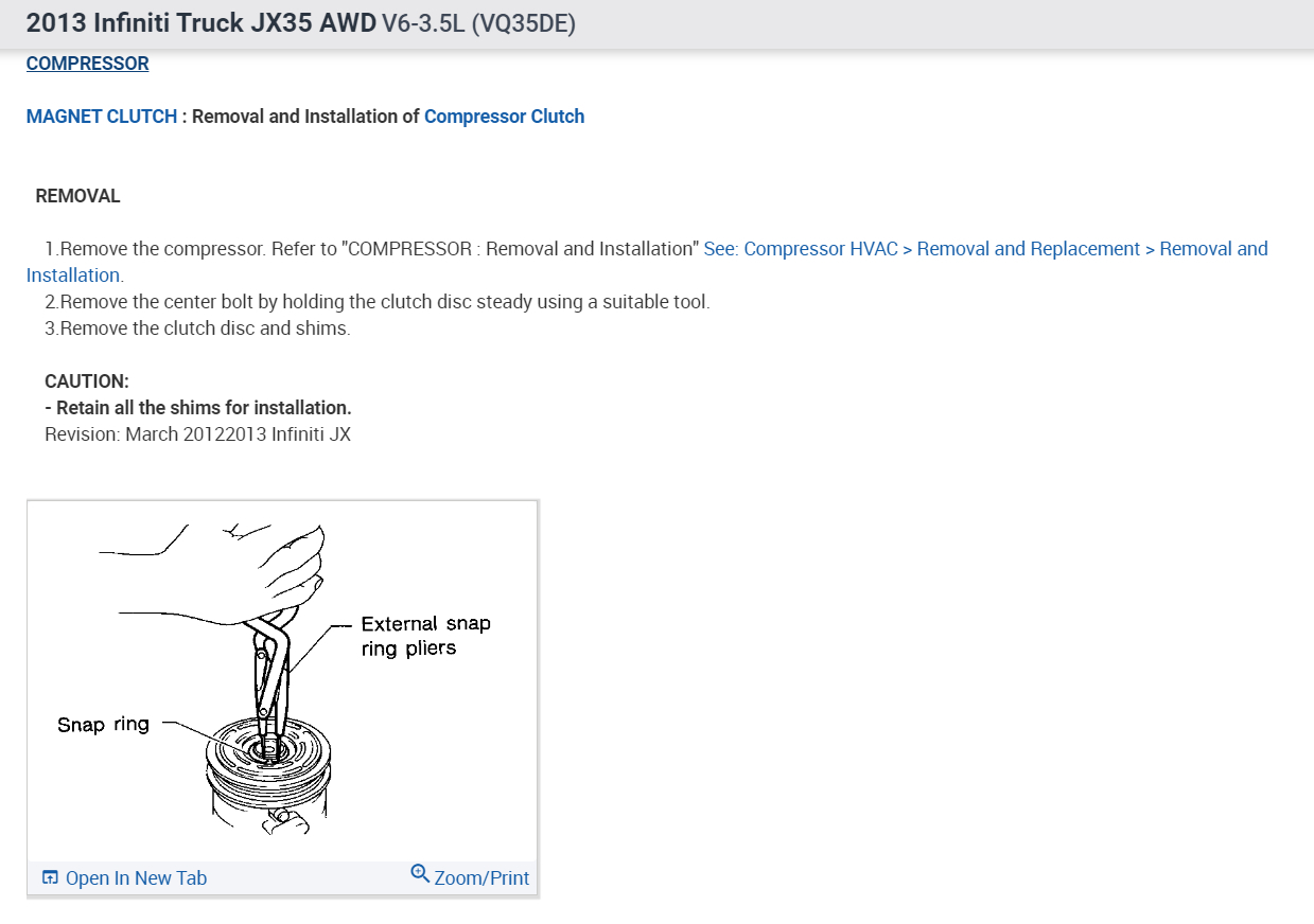

Looking for the spec's on the clutch how many thousands the clutch gap should be?
Jul 31, 2022 at 8:28 PM
  • 54,176 POSTS
Here are the instructions on how to replace the compressor clutch with the measurement at the clutch must have to operated correctly in the diagrams below. 0.3 to 0.6 mm or .012 to .024 in. Check out the diagrams (below). Please let us know if you need anything else to get the problem fixed.
