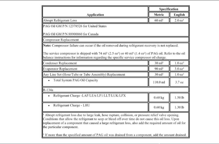

After replacing AC compressor how much Freon and type oil should be used?

Good afternoon.
Chart attached with the oil type, Freon amount for you to view.
https://www.2carpros.com/articles/replace-air-conditioner-compressor
