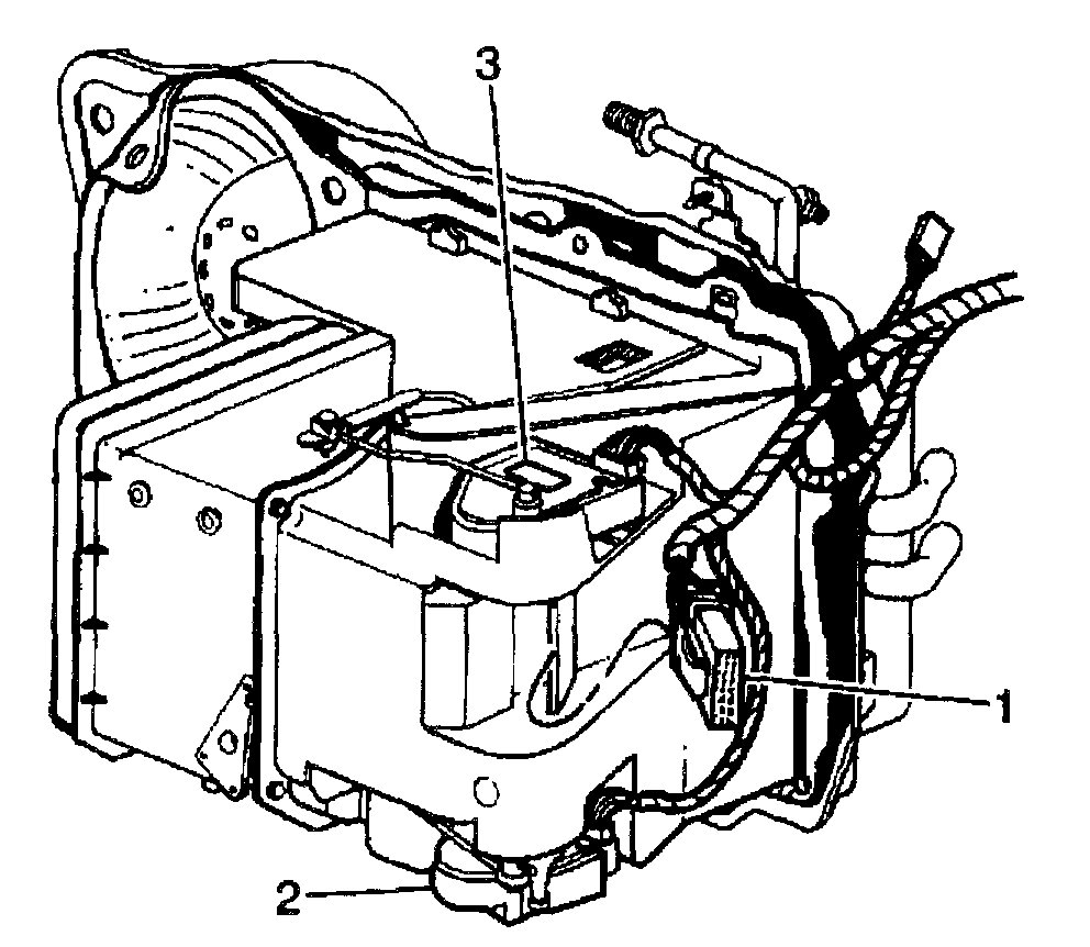

So my A/C and heat would not always change over on passenger side. I replaced the HVAC air door actuator. Now the same problem switched over to my driver side and the passenger switches just find. What can be the issue?

Did it happen as soon as you replaced the passenger side? Have you tried replacing the driver's side as well? Here are the directions. The attached picture correlates with the directions.
_______________________________
1999 Cadillac DeVille V8-4.6L VIN Y
Air Mix Actuator Replacement - Driver
Vehicle Heating and Air Conditioning Air Door Actuator / Motor Service and Repair Procedures HVAC System - Automatic Air Mix Actuator Replacement - Driver
AIR MIX ACTUATOR REPLACEMENT - DRIVER
pic 1
REMOVAL PROCEDURE
1. Remove the right sound insulator.
2. Remove the instrument panel compartment.
3. Unsnap the rod from the plastic retainer on the actuator arm.
4. Remove the two screws from the actuator (2).
5. Disconnect the electrical connector (1).
6. Remove the actuator (2).
7. Inspect the air mix door for free travel.
INSTALLATION PROCEDURE
IMPORTANT: After replacing the actuator (2), re-calibrate the actuator (2) for proper travel. Cycle the ignition ON for 3 minutes to allow the programmer and the actuator (2) to re-calibrate for proper travel.
1. Install the actuator (2).
2. Connect the electrical connector (1).
NOTE: Refer to Fastener Notice in Service Precautions.
3. Install the two screws to the actuator (2).
Tighten
Tighten the screws to 1.2 N.M (12 lb in).
4. Snap the rod to the plastic retainer on the actuator arm.
5. Install the instrument panel compartment.
6. Install the right sound insulator.

I was unaware that it have two. The one I replaced was under the glove box. Where is the other one located?
Saturday, August 22nd, 2020 AT 10:05 PM
MROULET1
  • 79 POSTS
When I look it up I only see that part that I replaced and a air inlet vacuum.
Saturday, August 22nd, 2020 AT 10:06 PM
  • 110,194 POSTS
Actuator Description
Vehicle Heating and Air Conditioning Air Door Actuator / Motor Description and Operation Components HVAC System - Automatic Actuator Description
ACTUATOR DESCRIPTION
The air temperature is controlled by the movement of an actuator. A dual zone system (CJ2) has the following 2 actuators:
The actuator on the bottom of the heating, ventilation, and air conditioning (HVAC) module assembly controls the temperature for the driver.
The actuator on the top of the module assembly controls the temperature for the passenger.
After replacing an actuator, re-calibrate the actuator for proper travel. Cycle the ignition "on" for 3 minutes in order to allow the programmer and the actuators to re-calibrate for proper travel.
Let me know if that helps.

I had did the one on the bottom, but when I did it I didn’t allow it to re-calibrate. Not sure if I messed it up. So I returned it got a new one re-calibrate it. So far so good.
Monday, August 24th, 2020 AT 7:11 PM
  • 110,194 POSTS
Excellent! I'm glad to hear it's working. If you didn't re-calibrate the new one, it will cause issues. However, if you would have disconnected it, reconnected it and re-calibrated it, that should have taken care of it.
