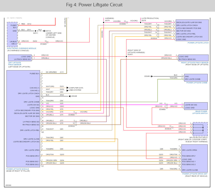

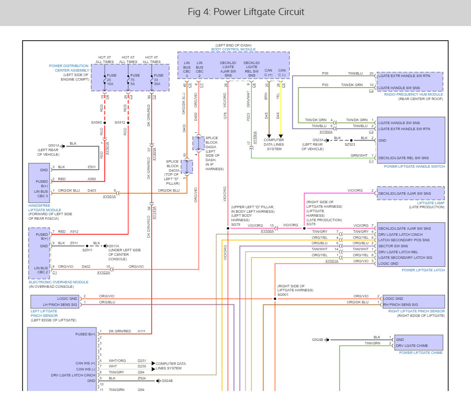

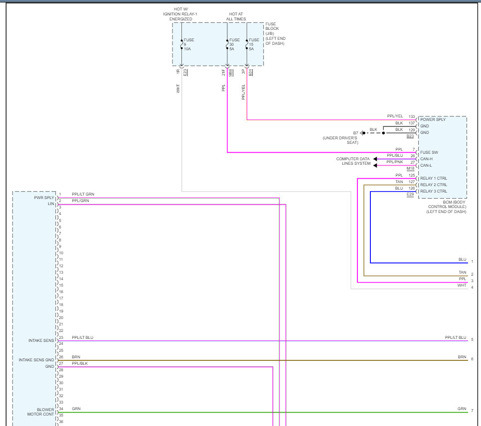

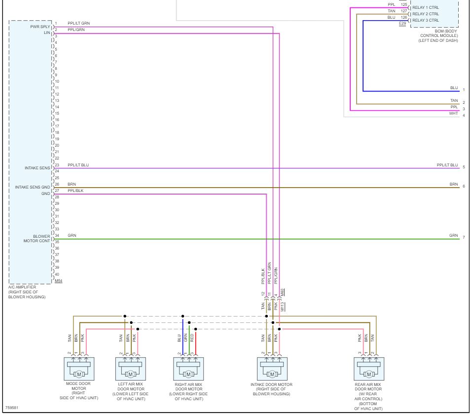

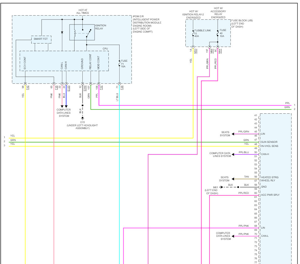

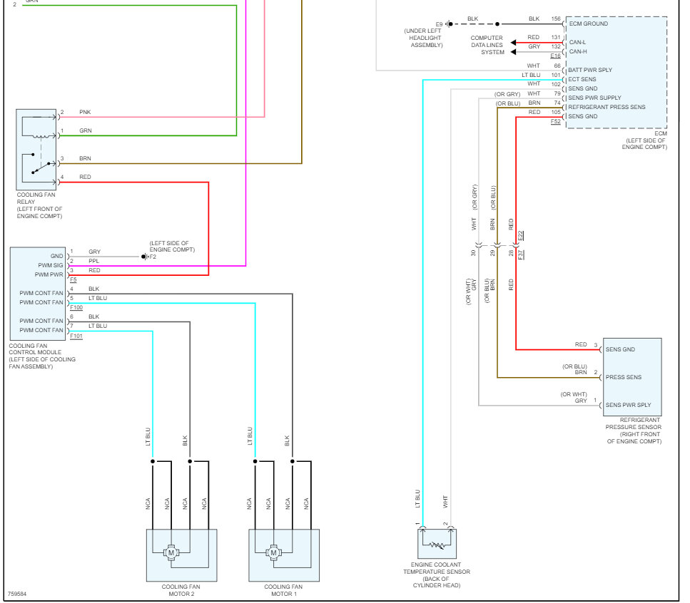

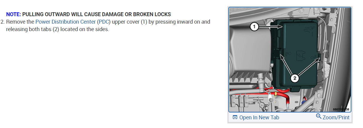

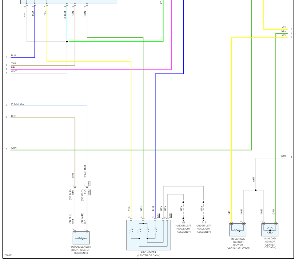

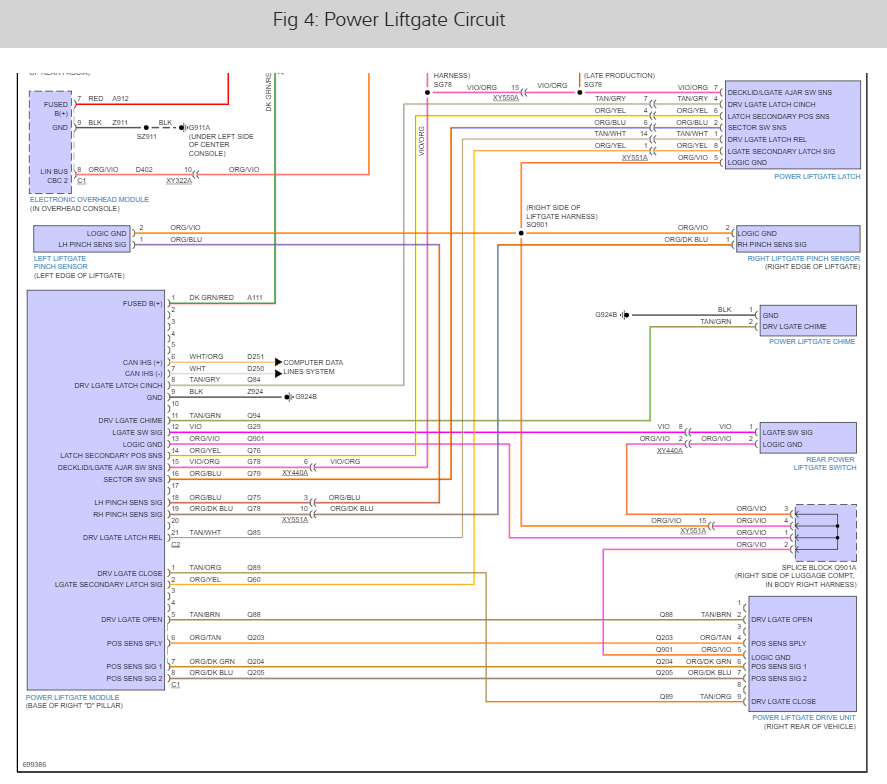

I would check fuses # 25, #75 and #33 in the under hood fuse panel. here is the wiring diagrams so you can see how the system works with a guide on how to check the uses with the fuse location in the diagrams below as well:
Lets do a CAN scan which is the future of automotive repair. you can get a CAN scanner from Amazon for about $50.00. here is a video to show you how. This will reveal any codes.

Thanks very much Ken those diagrams are exactly what I was wanting.I also did not think to use my Blue Driver scan tool. I guess it would work on this issue as well as engine problems. I am at work now so can't try anything but will let you know what I find. The fuses should be good because it goes right back to working after closing it manually. It never seems to fail with me when I want it to quit working but happens with my wife frequently.

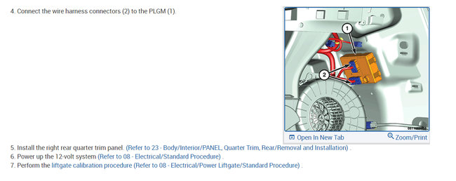

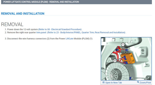

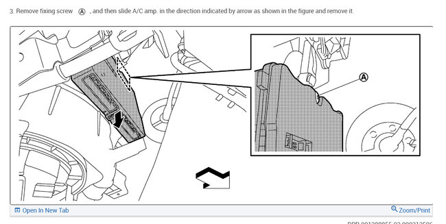

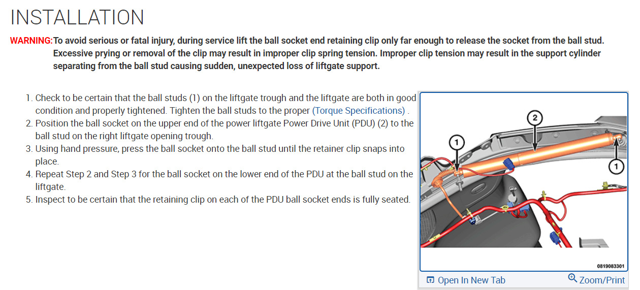

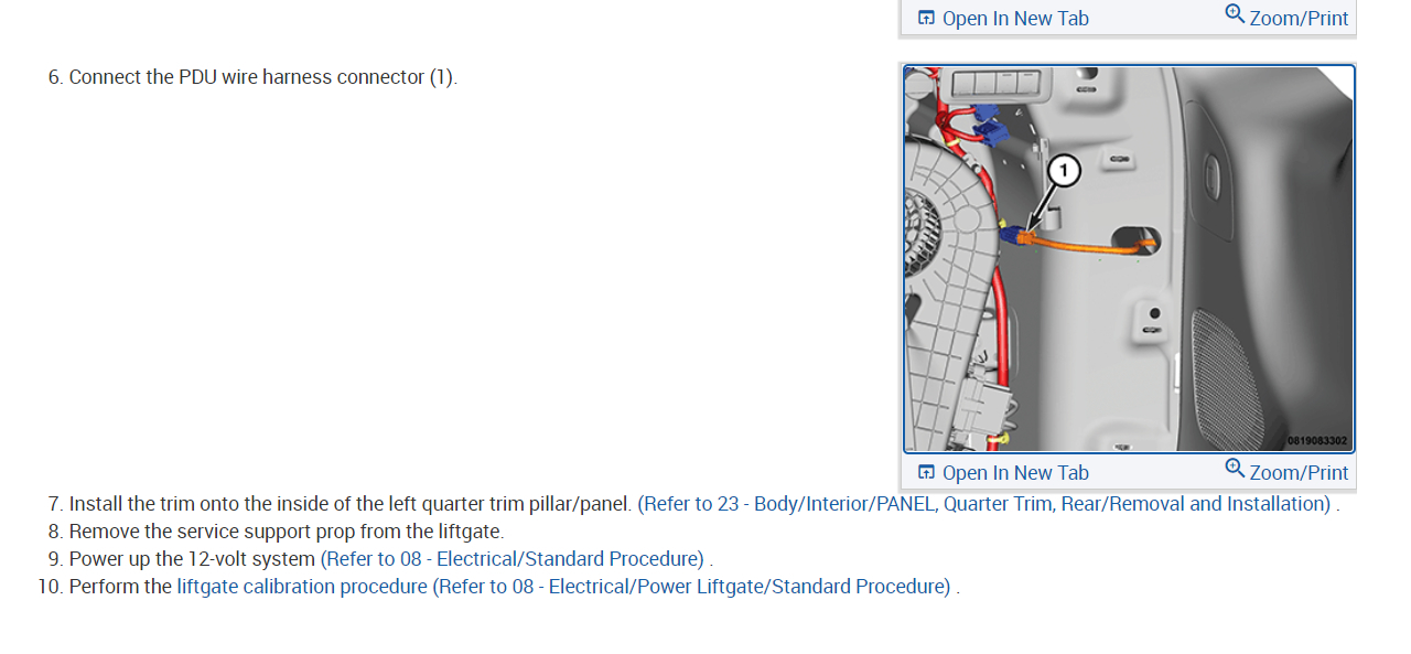

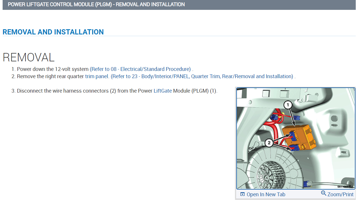

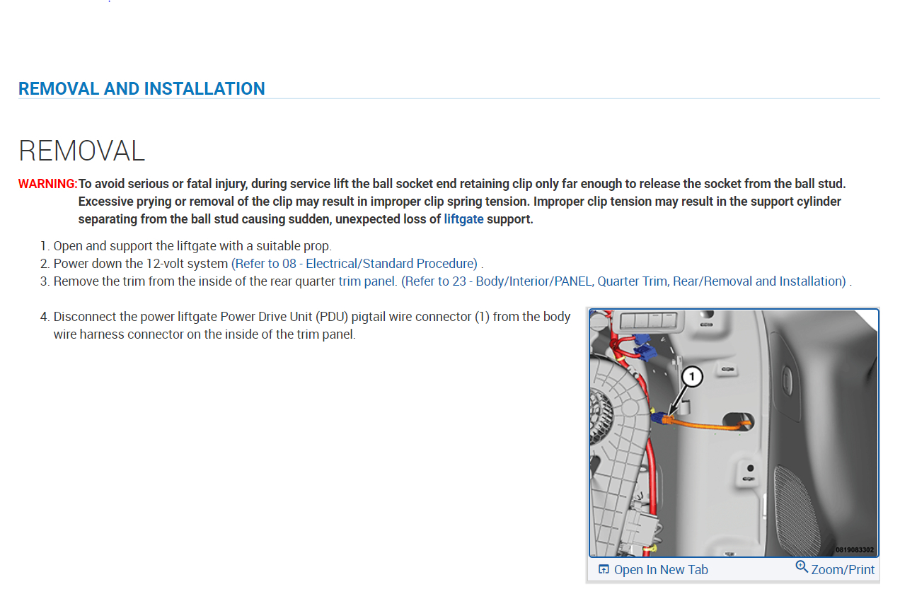

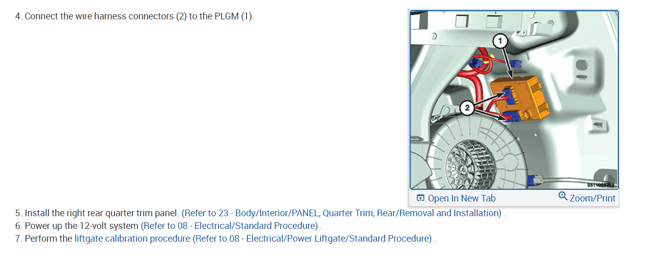

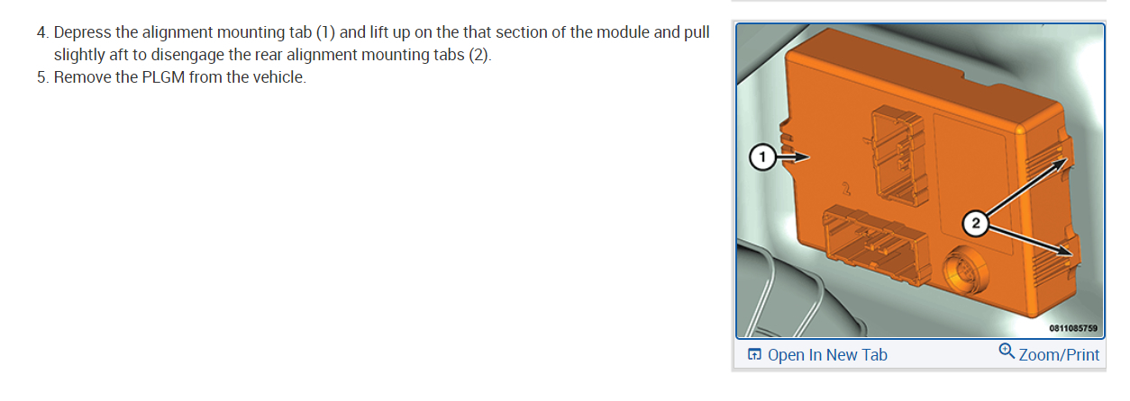

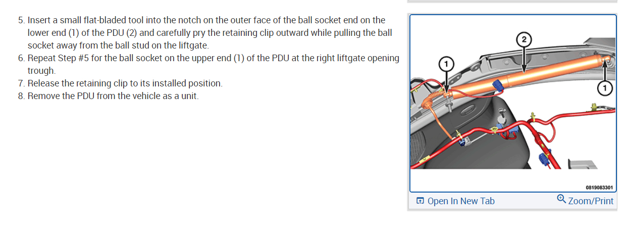

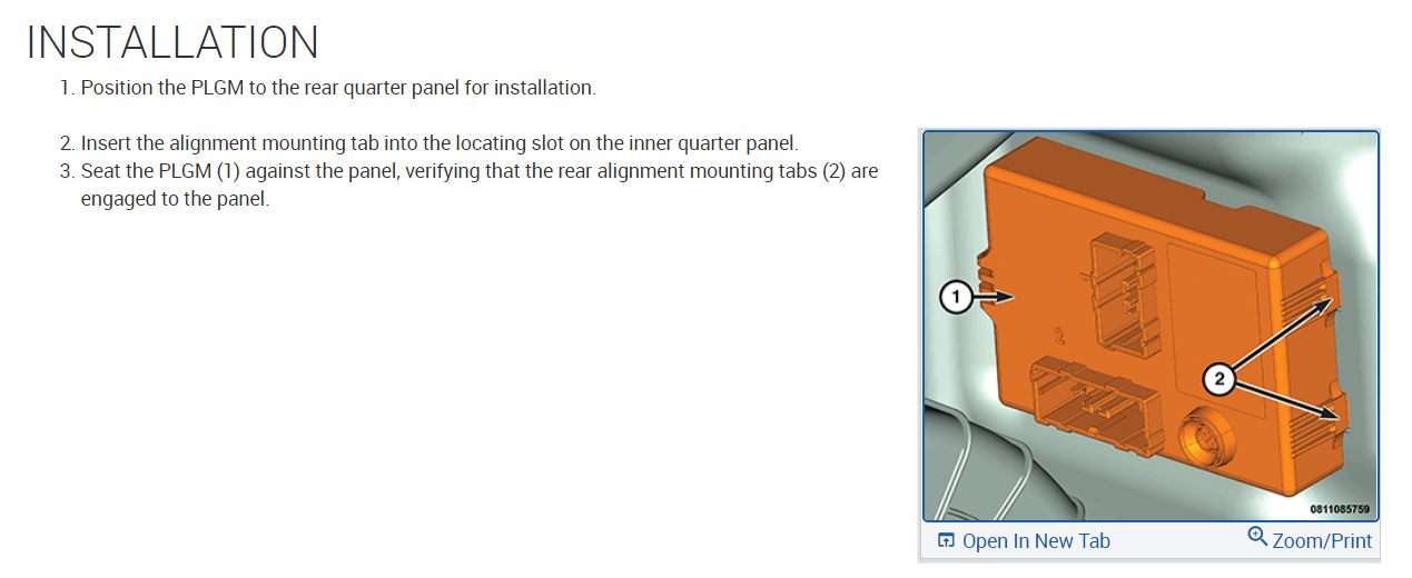

If the liftgate of your 2021 Chrysler Pacifica Hybrid is not closing after a timeout period, there are a few troubleshooting steps you can try:
Manual override:
Check for obstructions:
Power cycle the vehicle:
Here are the instructions in the diagrams below. I have included the control module as well.

We took it to the a Chrysler dealer nearer to us (not where we purchased it) and it just happened to fail when they first looked at it. They put a computer on it and it showed an error in the liftgate pinch sensors. They did not attempt to fix it right then and wanted us to leave it so we did for 2 days but we were still in a long line of cars to be repaired/serviced and it would be 2 or 3 more days before they could even get a technician to look at it. I picked the car up and drove it home. I tried the door when I got home but it worked fine. I tried holding the pinch sensor to simulate a pinch sensor failure (sticking closed) but it did not time out after 2 minutes of holding it closed (it might have timed out after a little longer). I left it open for about an hour (I was not holding the pinch sensor at this point) and it finally timed out and would not close. I put my code reader on it but it gave no error codes. Again the only way to reset it was to manually close it. My wife will be taking it in to the dealer we purchased it from on Tuesday, they agreed to work on it while she is there and if they cannot fix it they will give her a loaner car.
I suspected the pinch sensors earlier but have deliberately tried on 2 occasions to hold them in for a while but may not be giving it long enough. This would make sense because if the pinch sensors are sticking the engineers would probably lock out the ability to shut the lift gate to prevent injuries. I know they work because if I trigger them while the door is closing it will reverse and go back up as intended. Sounds like they may be having trouble with these sensors intermittently sticking but I have not been able to simulate the problem.

Update: Took van in to dealership and left it. They called back and said it was ready, we picked it up and 2 days later its doing the same thing.
The service report mentioned several DTC error codes all of which were related to the liftgate. They found a problem in a connector that connected the liftgate wiring into the vehicle wiring harness, connector XY551 A, it made sense being all of those sensors come thru that connector but unfortunately its back to the same problem as before. No answer from Chrysler on why the liftgate times out to begin with even when there are no issues I guess.

Yes, but I don't have the sheet here with me. I know they were all body codes and all had to do with the liftgate B1886, B1186 and more if my memory is correct.
One was related to pinch sensors, one was for the liftgate latch position switches, when I get home I will take a picture of the ticket and get you the codes. I had a Chrysler advocate working with me, she knew nothing technical but was very nice and tried to help any way she could. I asked her to get Chrysler to tell me why the lift gate times out to begin with but so far they have not answered. I found another listing on the Chrysler Pacifica Forum regarding this issue and they mentioned that Chrysler had issued a TSB "Liftgate button intermittently not working per the owner's manual: "performed TSB 18-19-31-9D Module, Power Liftgate Module (PLGM)--reprogram, 0.3 hrs" I looked it up but dont seem to have any access to it. see https://www.pacificaforums.com/threads/vanessa-is-home-from-the-spa.49501/

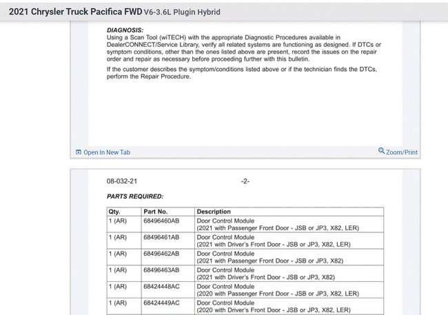

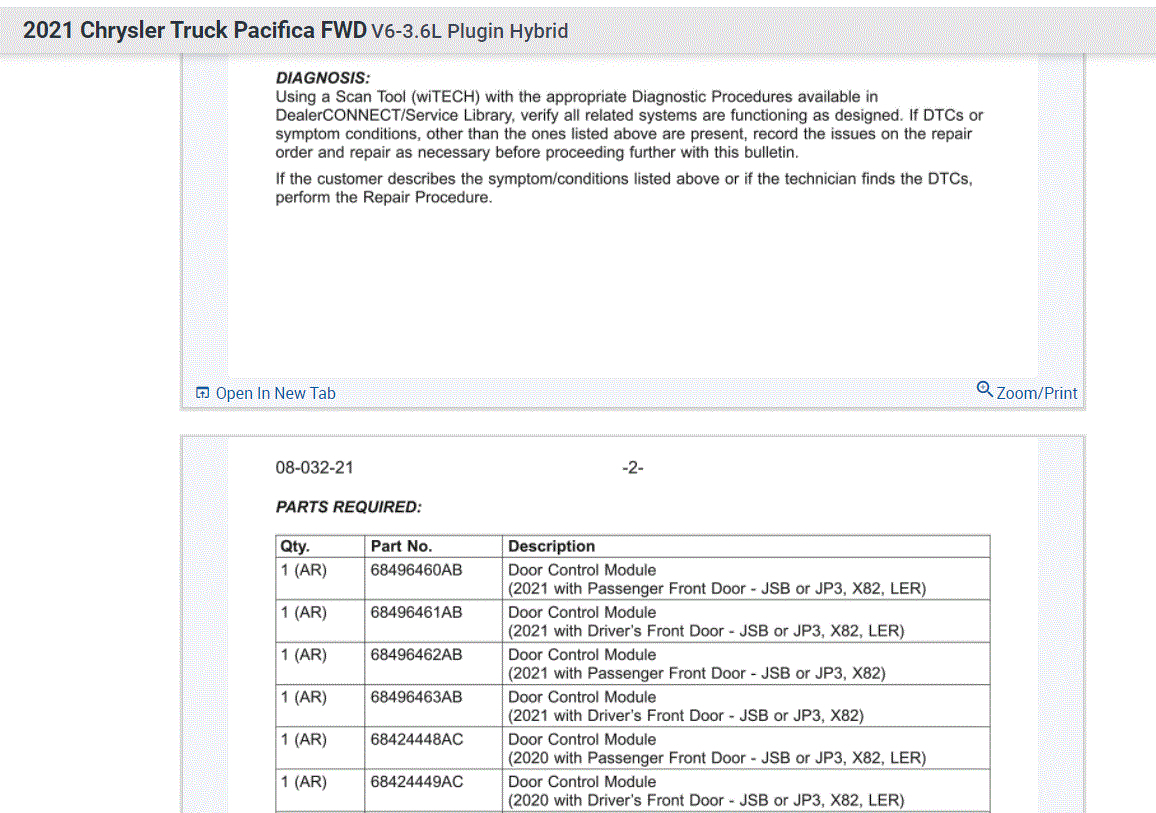

  • 110,194 POSTS
I'm not finding that TSB. It may have been from an earlier model year. The B1186 doesn't come up either, but the B1886 is. There is a TSB related to that code. I attached it below.
Let me know if that helps.
Tuesday, June 15th, 2021 AT 10:31 PM

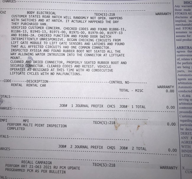

LARM
  • 9 POSTS
Joe, here are the codes they found as I promised. See attached picture.
I spoke with the service manager and he looked the TSB up and found it in his computer and will reprogram when we take the car in the next time.
Thursday, June 17th, 2021 AT 8:14 AM
  • 110,194 POSTS
Thanks for the info. I looked through the codes. They are related to the pinch sensor. The common thread is they all seem to involve a short to either ground or battery voltage.
It may have been when he repaired. Let me know if things change or if I can do anything to help.

I had a 2021 Pacifica for a few hours. It would consistently time out after one hour of no activity. What I did notice was that the PLG State (Power Lift Gate State) would change from "Decklid is completely open" to "Decklid is in intermediate position" Pushing up on the liftgate does not change this message. I suspect that engineering used this for load shedding after extended inactivity.
Monday, May 9th, 2022 AT 1:42 PM
Thanks, John, for that info. You could be correct that this was load shedding, but I think we have a flash out for this issue now. Basically, they are seeing that the PLGM will get the signal from the switch but not operate the door at times. Many dealers were replacing the module, but this would not correct it.
So, I suspect the PLGM needed to be updated and that would have corrected this member issue.
