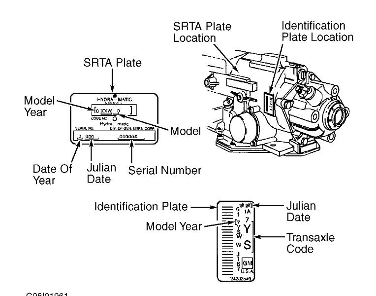

LALFAN
  • 179 POSTS
Do you know what years and models of cars the transmissions will interchange withmine? Just in case I have to get to that point. I really think it is to sloppy to seal up. Then I will have to price fixing or changeing it out. Thanks
Wednesday, March 23rd, 2011 AT 9:13 PM
SATURNTECH9
  • 30,869 POSTS
Let me know if it get's down to replacing or fixing and we will go from there.I would have to search thru all the year's and match part number's etc. Which I don't mind doing for you I just don't want to have to do it for no reason.I could spend that time helping other user's with there car's. So keep me posted on what you find and I will be more then happy to help you out with that.

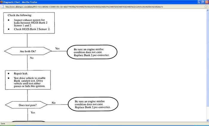

Drove the ls2 today. Seems to shift smoother than before. The rpm's going down the road seem to be less than before. Went to omaha and back and only got 24 mpg. The service engine light came on again. P0421 andp0431. Warm up catalyst efficiency below threshold bank 1 and 2. I guess more problems. My scanner does not give me misfires per cyl. On this car but the 99 sl1 I have it does. Dont under stand why it does that. Thanks
Sunday, March 27th, 2011 AT 10:50 PM
SATURNTECH9
  • 30,869 POSTS
Are you sure you don't have a P0422 and a p0432?I can't find the one's you listed. Let me know.

That is what it says. They are in my chilton l series manual. And I did order a back pressure tester. Should get it this week. Thanks
Sunday, March 27th, 2011 AT 11:38 PM
SATURNTECH9
  • 30,869 POSTS

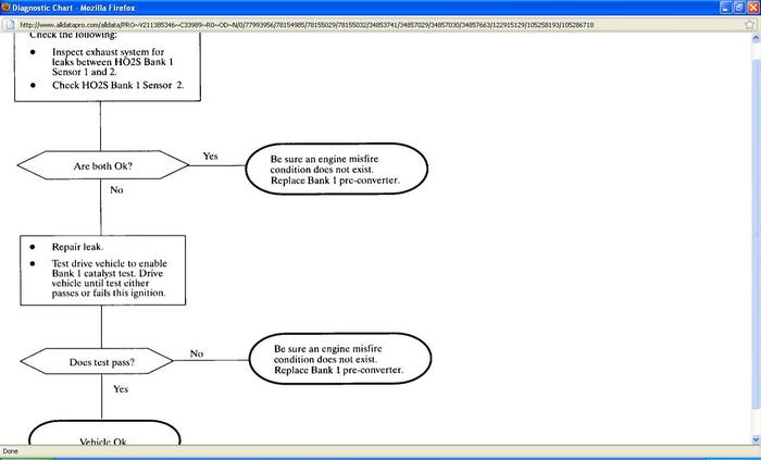

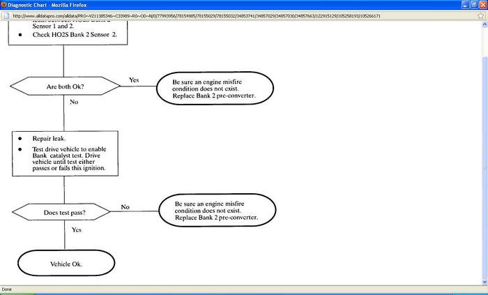

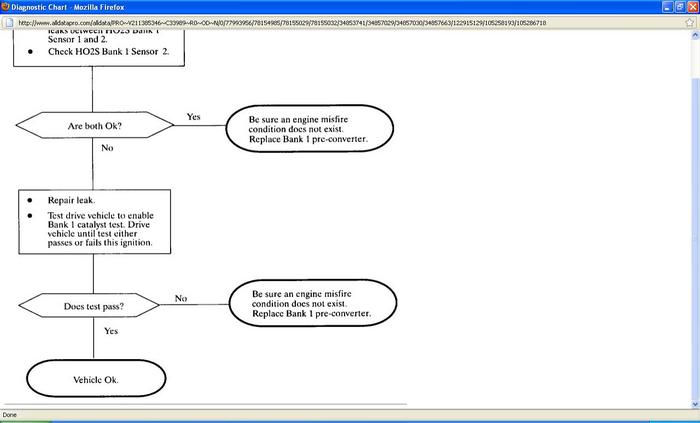

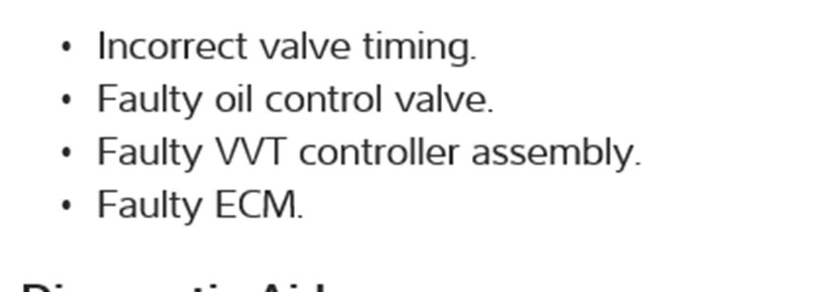

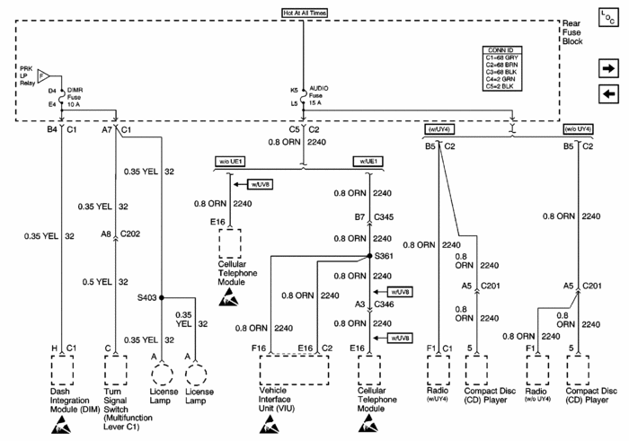

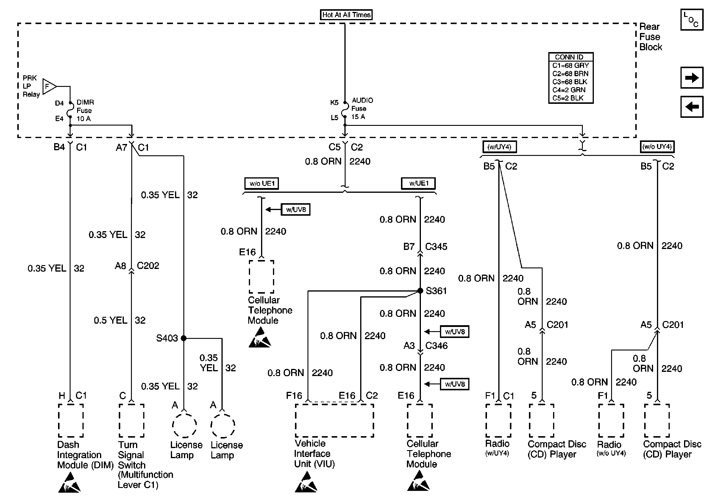

I can't find the ones you posted but the code's P0422 and p0432 is the same code description warm up catalyst efficiency below threshold bank 1 and 2 I posted the code descriptions and the trouble tree's for you the first two posted ones is the code P0422 and the number 3 and 4 images is the code P0432. Let me know what you find.
The catalyst is a device used to control emission content. Although the catalyst is active as soon as exhaust gas is passed through it, this diagnostic will not run until the front and rear oxygen sensors are both in open loop. The oxygen storing capability of the catalyst is monitored by viewing the rear oxygen sensor's response to an oscillating air-fuel ratio. The ECM computes how a near-failure catalyst would cause a rear oxygen sensor to react to an oscillating air-fuel ratio. These values are compared with the actual rear oxygen sensor response. If the actual response deviates a calibrated amount from the computed values, this code will set.
DTC PARAMETERS
DTC P0422 will set when:
* Closed loop is enabled
* Engine Speed is between 1400 and 2200 rpm
* Catalyst temperature greater than 380°C (716°F)
* No front or rear, misfire, MAF, TP, purge solenoids codes set
DTC P0422 a (type B) DTC.
DIAGNOSTIC AIDS
Once set, this code should remain active. Under certain driving conditions the catalyst monitor test may pass. This condition may occur if driving the vehicle at highway speeds (high air flow) but if this code is set, and there are no exhaust leaks, the converter should be replaced. If a misfire code is detected, the catalyst monitor test will not run. Be sure to correct a misfire condition before replacing the converter.
Possible causes:
* Exhaust system leaks between front and rear sensors, or rear sensor leaking.
* Catalyst deteriorated due to excessive time operating vehicle with a catalyst damaging misfire.
* Contamination of converter due to incorrect sealant, fuel, or fuel additive.
DTC PARAMETERS
DTC P0432 will set when:
DTC P0432 a (type B) DTC.
DIAGNOSTIC AIDS
Possible causes:
Sunday, March 27th, 2011 AT 11:57 PM

The pre converter is that part right below the exhaust manifold that is attached to the exhaust manifold.I can't tell you why your 1999 SL1 shows miss fires per cylinder and your 2000 LS2 doesn't. So does your 2000 LS2 miss firing or have miss fire code's?I would follow the trouble tree's I posted there pretty straight forward they really don't have any scanner data to watch or look at. They just ask if you have a exhaust leak a miss fire etc. If you want to donate more feel free too.
