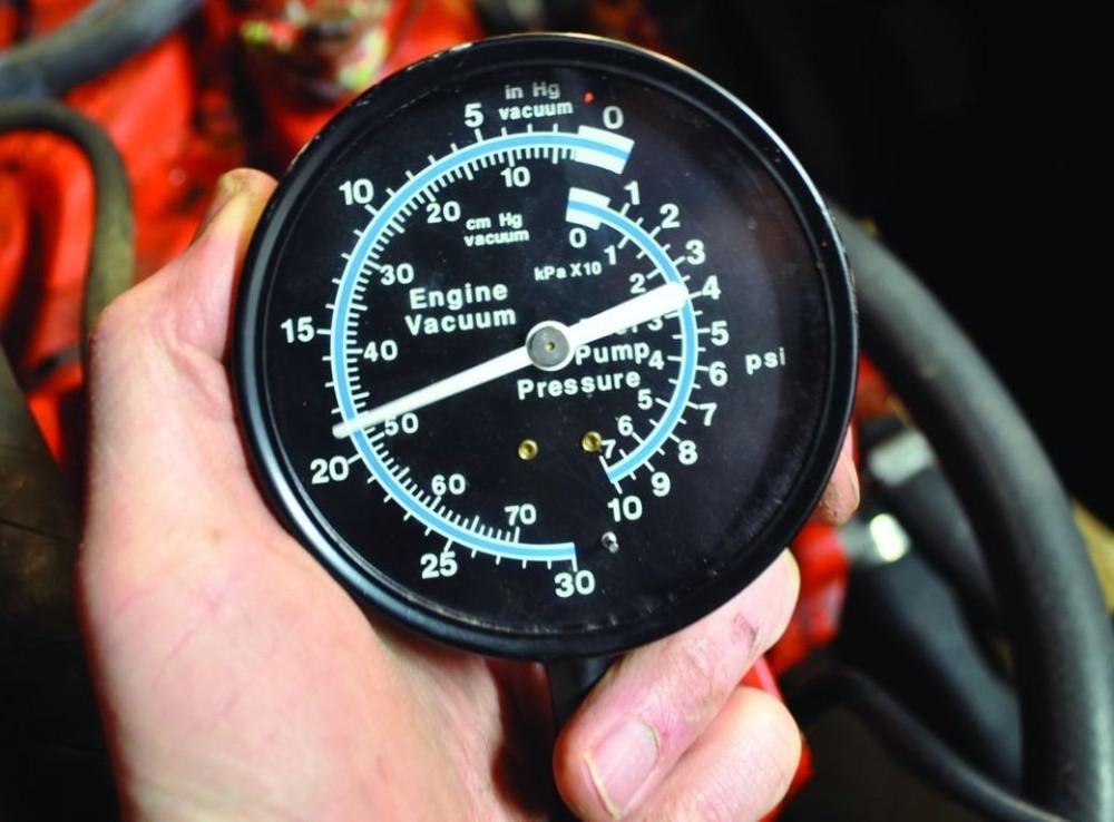

After thought... I was sitting here thinking about the problem... Have you ever checked or changed the crank sensor or cam sensor? They determine injection timing and can cause a lot of different issues.
No sir never have. And i definitely wouldn't mind changing them if it will improve my car's performance. However, first i want to check the engine vacuum like you suggested. I'll get back to you depending on what i find. Btw are the crank and cam sensors the same thing? Where are they located and is it very complicated to change them?
Oct 5, 2015 at 7:00 AM
Disregard that last question i already looked it up. Actually while i was hunting for a vacuum gauge at a local auto parts store, they told me that another way i can tell if my engine vacuum is fine is that when my ac is on, if it changes quickly from vent to defrost, which mine does, then the vacuum is fine. So would you recommend i still buy the gauge? Also at Autozone they showed a vacuum pump which they rent. It looks like a gun and it has a gauge mounted on it along with a long rubber tube to goes to wherever you're supposed to connect it on the engine. They told me you pump the trigger and you watch how much the pressure falls. Is this the tool i need? Because there's one that i found online that looks closer to the picture you posted. It's just a big gauge with a long rubber tube and a little T adapter. Which one is it?

Oct 20, 2015 at 5:45 PM
Ok today i tested the engine vacuum. I got a reading of exactly 17 inches of pressure. Then I proceeded to test further following these guidelines i found on Google. I opened and closed the throttle quickly and the needle would quickly jump from around 2 to 20 inches quickly, then return to normal. I also noticed that although it would stay at 17 in, the needle would vibrate slightly. But at a higher fixed speed (by opening the throttle more and holding it there) it wouldn't vibrate at all. So what's next? And thanks again.
