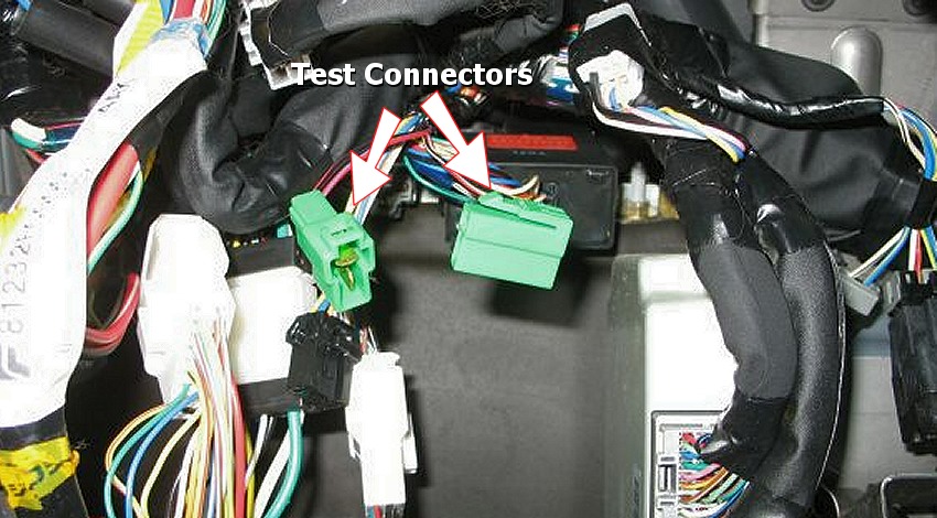

Locate the diagnostic connector which is located near the driver’s side kick panel, most cases, they maybe green or black.
  obd1 subaru test connector
Locate the computer which is located under the dash near the driver’s side.
With the ignition key in the on position and the engine off, connect the "read memory" connector and disconnect the "test mode" connector. The check engine light will start to blink, the first set of light blinks will be the first digit of the trouble code, there will be a short pause when the computer is going to output the second digit of the trouble code. For example; if the first set of check engine light blinks three times and the second set of flashing check engine light blink five times the code number is 35.
To clear trouble codes once the repairs have been made, remove the negative battery cable for 60 seconds, then reconnect.
