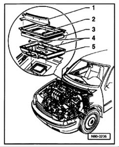

How do I change the cabin filter for VW jetta "01 cabin filter. Where is it located?

Removing
With plenum cover removed:
Depress tabs at front edge of frame -2-.
Lift and pull out filter element with frame to front.
Installing
Assemble filter element to frame
Insert so that pins fit into into filter housing -5-.
Clip frame into place.
