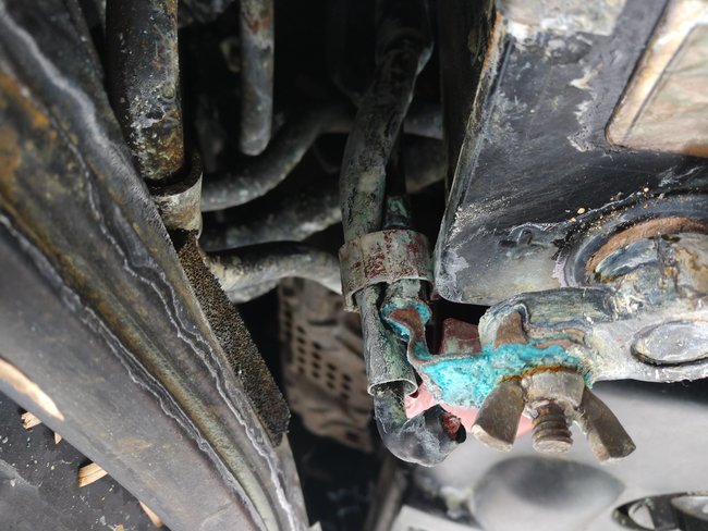

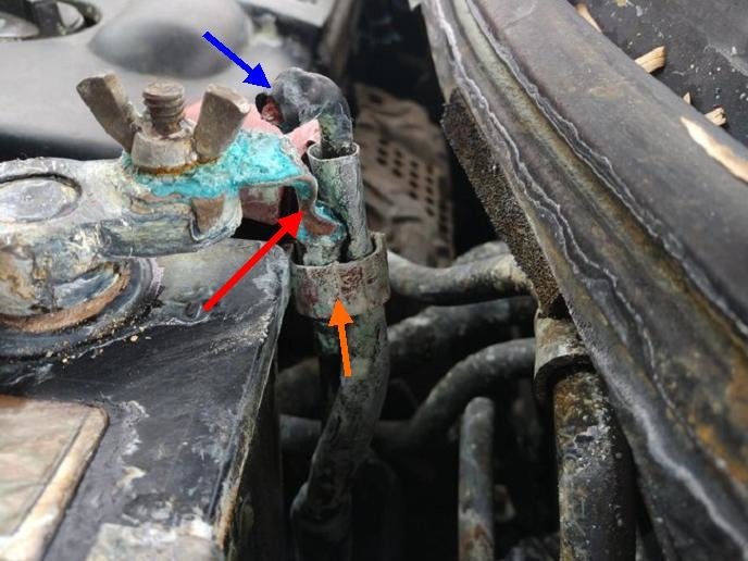

The battery was dead and I went to jump start it and there was a ton of corrosion on the positive terminal. I cleaned it all off, went to jump it and nothing. Would not charge, would not start. After taking a closer look I see a cable just floating in space and not connected to anything. I honestly do not remember if it was ever connected. Does this look like something that is supposed to be connected? Or does it look like excess cable from a previous battery replacement? I received this car in 2015 and it was used and seemed to be like it was an auction buy from the dealer. Any help and suggestions on what I need to do would be greatly appreciated. Attached below is the battery/cable.

Good evening,
Not stupid at all.
That green stuff is the cause. You need to replace that cable as all that corrosion is preventing any voltage from flowing.
Replace the cable from the battery down with a new cable. You can get them at a parts store. You will need to measure the length of the cable to be sure you have enough cable to run it the same way it is run right there.

It sounds like there are multiple issues, but it all started with nothing more than a defective battery. The clue is your dandy observation of the excessive corrosion. As all batteries age, the lead slowly flakes off the plates. Battery manufacturers know that is going to happen, and how quickly. They provide the longest warranties they think they can get away with which is typically five years.
As more and more of that lead flakes off the plates, the electrical size of the battery becomes smaller and smaller. It will still crank most engines just fine, but not for as long, if necessary, as when it was new. The bigger concern is when that battery recharges once the engine is running. The amount of charging current going through the battery is determined, in part, by the charging voltage, and that is designed in to match the needs of the entire electrical system. The battery will charge at the intended rate, but with much of the lead flaked off the plates, that current gets packed into a smaller area, and that causes the plates to heat up more than normal.

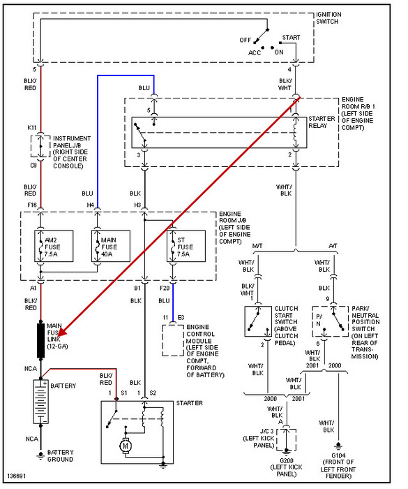

HMAC300
  • 48,601 POSTS
Intermittents are hard to find but here is a schematic of the start system for you to check. Look a the main fusiblelink where the arrow is. Check for maybe one or two strands of wires still connected. If that's is like that replace the whole llink. Ancd checkthe fuses underhood as well as the relay. The relay may have corrosion on it, if it doesn try cleaning it as well as the spade connector then put some dielectric compound on it to get better contact.

JOHNSGOULD
Link looked ok. Added new ground strap to motor as well.
Put in a new starter relay but the old one was probally ok.
