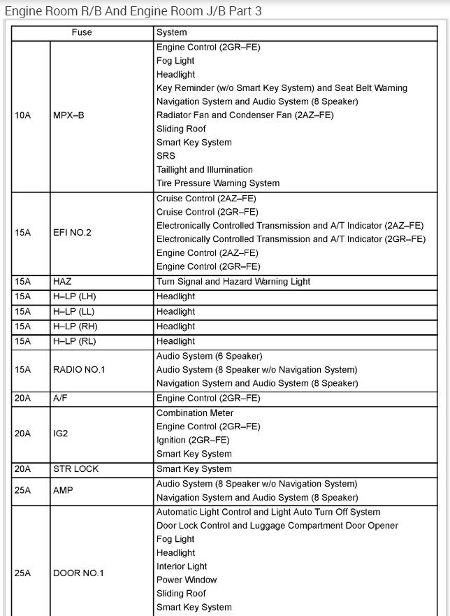

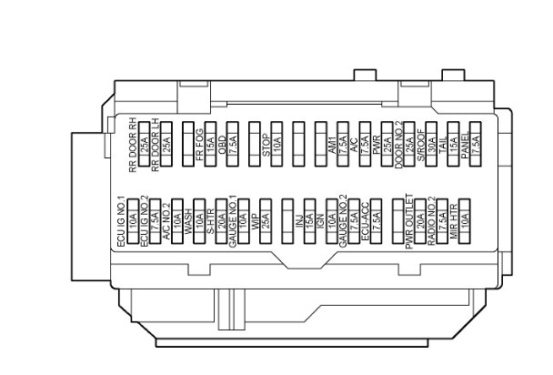

this sounds like window motor.try holding the switch and bang on the door panel see if it starts working.only other way you need a test light for quick voltage checks.test that voltage going through the switch to the motor. This guide will show you how.
https://www.2carpros.com/articles/electric-window-repair

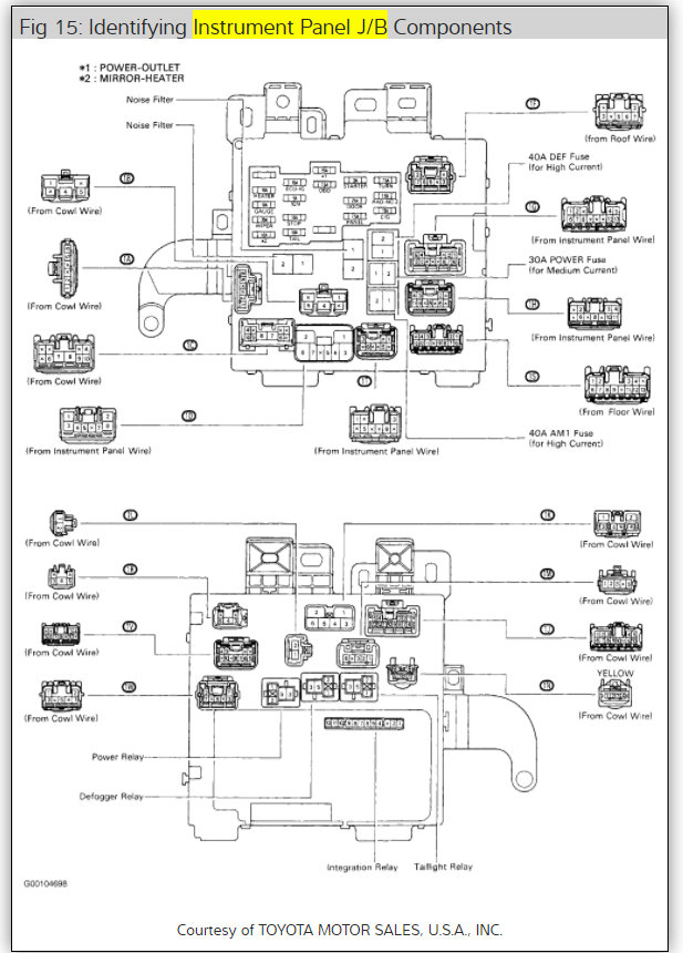

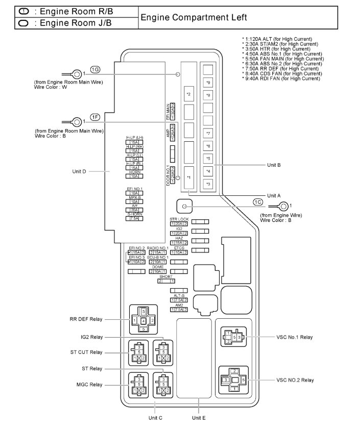

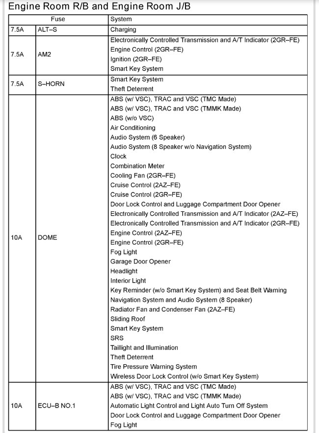

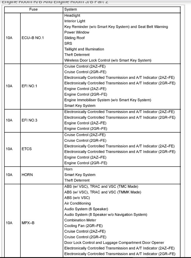

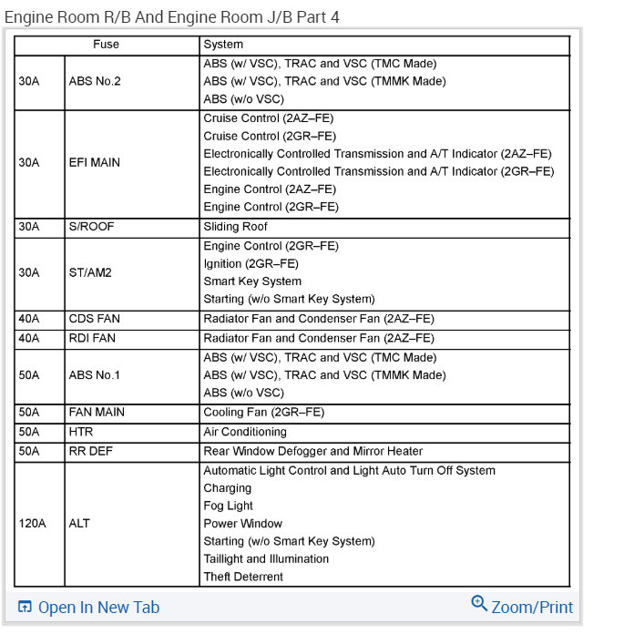

Here are the window wiring diagrams so you can see how the system works. Also check the system fuses and the power relay locations below.
and
Check out the diagrams (Below). Please let us know what you find. We are interested to see what it is.

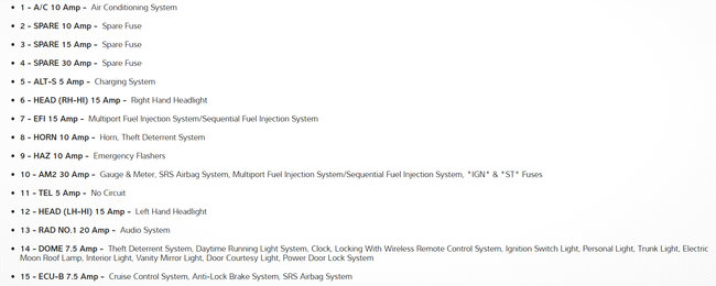

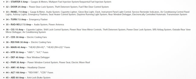

BLUELIGHTNIN6
  • CAR REPAIR CONTRIBUTOR
  • 16,542 POSTS

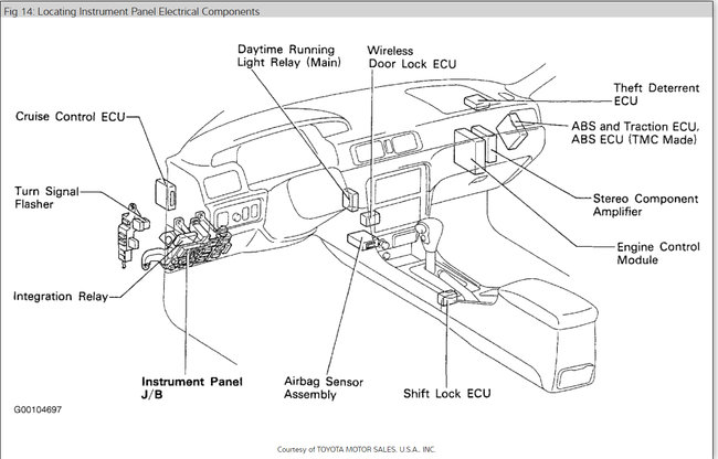

hello

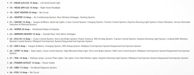

There is a common fuse #10 in the passenger fuse panel. Here is a guide to help check it and the fuse location in the diagrams below.
Check out the diagrams (Below). Please run this test and get back to us.
Feb 19, 2021 at 6:52 PM (Merged)

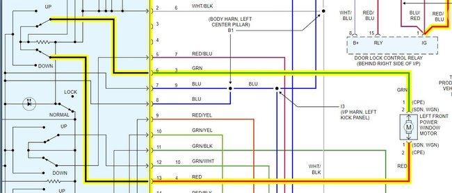

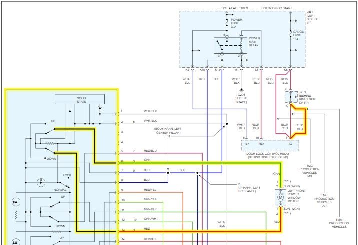

CBRASSO
  • 43 POSTS

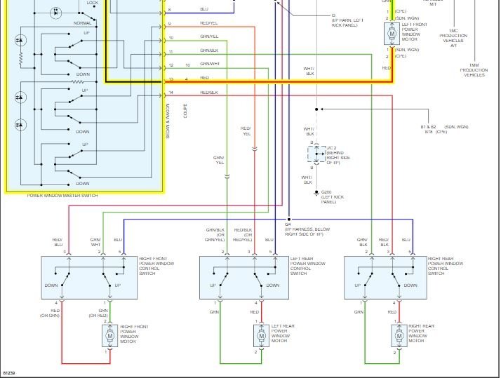

Okay, 30 amp fuse under steering wheel was blown so I replaced it. All windows and locks work except for driver window. Now I checked voltage at the plug that goes into the switches and I have 3 wires having 12v. I’m assuming I should have 4? I used multi-meter and found to have continuity from the kick panel to the Sam plug in the door on all but the red and I believe blue which are the colors of the wires that go into window motor. Is it possible both those wires happen to be cut in between the kick panel and plug are am I missing something?
Feb 19, 2021 at 6:53 PM (Merged)
  • 110,190 POSTS

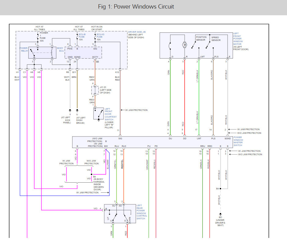

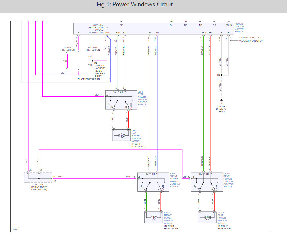

Welcome to 2CarPros..
First, the green and red wires going to the left front (driver's) window will only have power based on the direction selected. See picture 1. Red is for down, and the green is up.
What I have done is attach the entire wiring schematic for you to review. I had to break it into two different pics for it to fit, but you will see all the wires and colors to help guide you. Also, I did overlap the pics so you can follow one to the next.
Take a look through it and let me know exactly which wires you are checking and what you are finding.
CBRASSO
  • 43 POSTS
Joe that was really helpful! I’ll save this for future reference! Turns out the motor is bad I was a bit confused on the wiring. Thanks a bunch!
