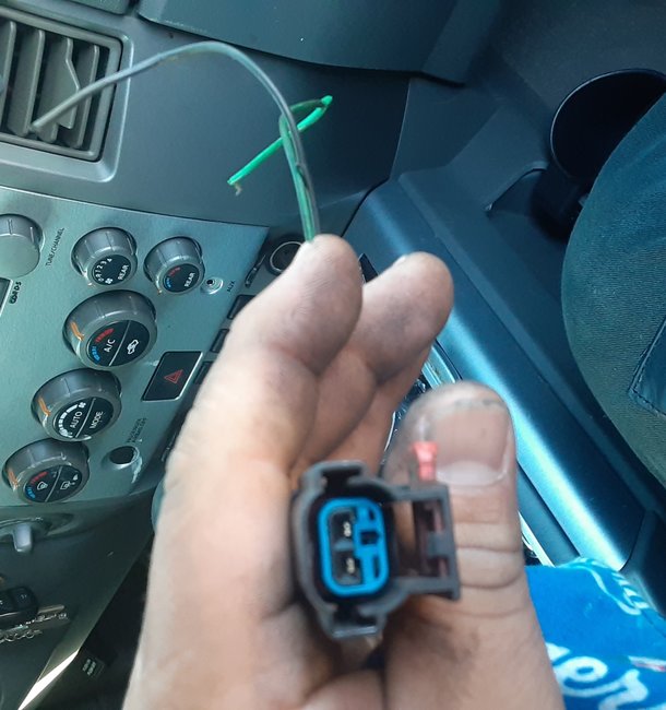

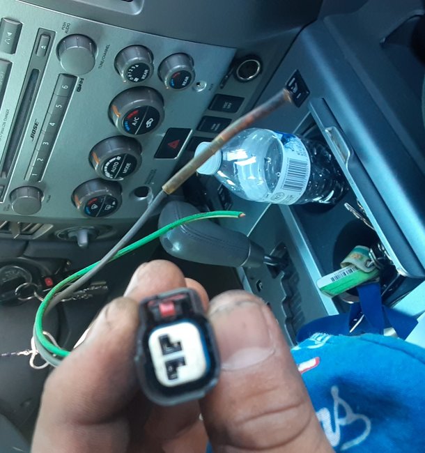

Before all that. I did cut and swap the connector for the alternator because it was a small difference. The original is the blue one.

Okay. Let's step back and can you give me the detail as to why you put an alternator on it and then did you only change the connector? How did you connect the new connector? Did you solder the wiring together?
Then which terminals did you connect each wire to? Meaning you should have terminal one with the green wire and 2 should have the green with orange wire. Lastly we need to ohm out the wire from the battery to the alternator. There is a fusible link that we need to make sure is still good.
Let us know this info and we can go from there. Thanks

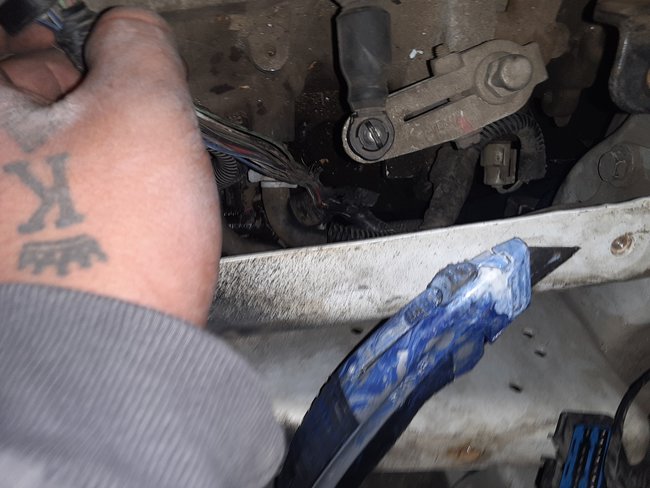

Okay, it all started when in the mornings I would start up the car and it would not start I would jump start it. It would turn on some times and sometimes not, then I noticed my dashboard lights would dim on and off from bright to a low then I took it to a friend and he checked it and said my alternator was bad. He then said to go to a junk yard and get one as long the car was as same as mine and everything matched. We then took the old one off and put the used one on come to find out the connector for the alternator was different style it was still 2 pin connector but smaller he then cut the connector for the old alternator on the car and bridged it like ppl do with stereos cables then we were going to jump start it and saw some smoke coming from the cables I mentioned earlier idk if its related or just a coincidence. The blue one is the old connector and the one is the white one.
Wednesday, October 28th, 2020 AT 7:07 PM
Okay. Based on that info, let's take that alternator that you got from the junk yard to a parts store that can bench test it. I am thinking it may have a short and the voltage spiked and burned the wire. If the alternator tests ok then we will need to test the wiring to make sure it is ok as well. However, due to that info, I suspect the used alternator was the issue. Also, did they say what vehicle this came off of?

Okay. That is good. The difference in connector then is because it came out of a different model year PT Cruiser. That was common for them to change connectors.

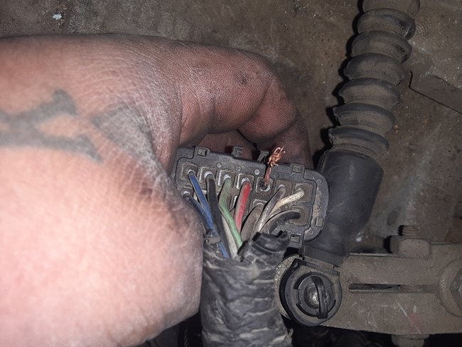

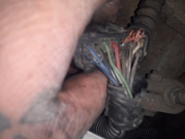

I don't but tomorrow morning I will take a look at it all. I do know it was from this connection it's under the battery tray.

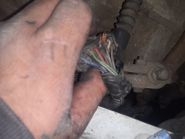

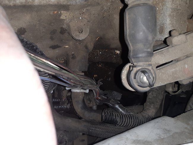

Finally got to the car, but it got dark have not taken the alternator to get checked yet kind of hard single dad and no car, haha. Did notice there was a number 12 where the burned cables connects the 12 is on the connector I will try again tomorrow to find out the color of the cable but I think it's black.
Friday, October 30th, 2020 AT 9:28 PM
JOVANIHERRERA0323
  • 17 POSTS

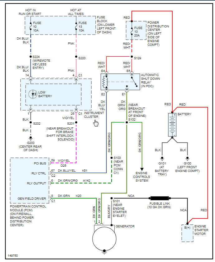

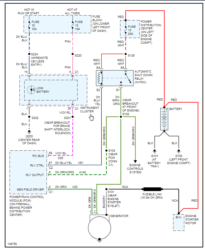

Did I mention I have the Haynes book? Also it has the diagram but don't really understand them yet.
Friday, October 30th, 2020 AT 9:32 PM
Okay. That helps. Does that lead to the transmission? It looks like what is called an inline connector so can you follow the harness to both ends and tell me where it goes? That will tell us what connector that is and then we can tell what wire that was.
However, if it was black, then it may be a ground wire. If it is then the ground that it leads to is most likely loose. Let's trace that harness and go from there. Thanks

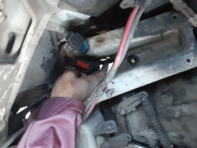

No, that one is on there. I know which one your talking about but it's not that one.
Sunday, November 1st, 2020 AT 6:31 PM
Okay. However, just let me know what is on either end of the wires. In other words, where do they lead too and I can track down what circuit that is based on where it is in the connector. I just need to get a starting point with a component that it is attached to. Thanks

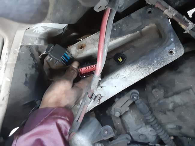

Thank you so much for taking your time and helping me out so much finally got it running again. It was the thick black ground cable that was loose and when I tried to start it up it got fried up. Thank you so much man you're the best.
Saturday, November 7th, 2020 AT 12:46 AM
The dreaded loose ground strikes again. Thanks for the update. Glad you found it and for sticking with us to keep us informed. That info will surely help others.
