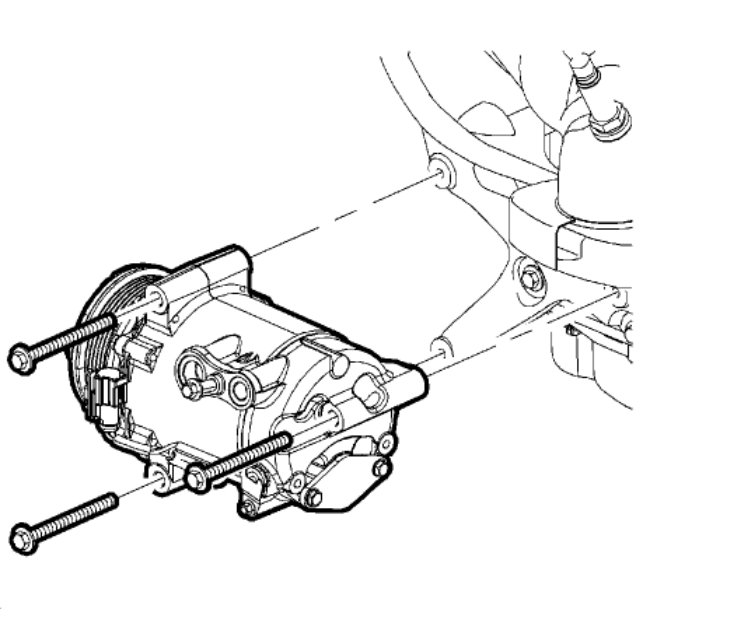

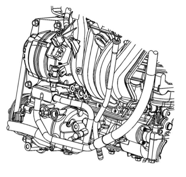

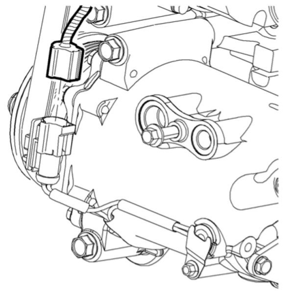

It sounds like you have a air conditioer compressor that is going out. When they go out the seal go bad which it sound like whats going on. Here is a guide to help you get the problem fixed by giving you an idea of what needs to happen.
https://www.2carpros.com/articles/replace-air-conditioner-compressor
and
Here is how to change the unit out in your car (below)
Please let us know what happens

It does sound like the compressor is getting weak which is how they act when they are going out.
Here are a couple of guides that should help you get the job done and explain how the system works.
https://www.2carpros.com/articles/how-a-car-air-conditioner-works
and
and
Diagrams below:
