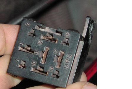

So far I went and pulled out the relay for the fuel pump. It was clear this relay had seen better days. In fact it was very loosely in there and upon further examination I found it probably was shorting out a bit. It was black inside on a spot and had melted away some of the plastic on the cover of the relay and on the outside of the relay (where you plug it into).
So I got a new relay, put it in and nothing. I even went back to the old relay. Nothing again. The fuel pump doesn't even kick in now. I haven't been able to spend much more time troubleshooting it yet, but I wanted to provide this update.

I looked over the book tonight and don't see anything on an air flow sensor. However, I don't have the best in the manuals (as those look to be over $500). I don't see anything on the ECM either. The only thing I see in the wiring diagram that might be of interest is the warm up regulator as this looks to be connected to the fuel pump relay in some sort of fashion. At this point I'm beyond my or my relatives understanding of the electrical system.
As far as hooking this up to a computer I'm not sure. I think if I did that I would just take it in and get this problem fixed. Which could end up being my choice. I also was looking around and found something (maybe this is where the computer hooks up? Not sure, looks like something should plug into this thing, I'll attach the picture.

Yep, with porsche there are some specialized test equipment that needs to be purchaced to trouble shoot electrical problems. Let me know what the shop finds.
