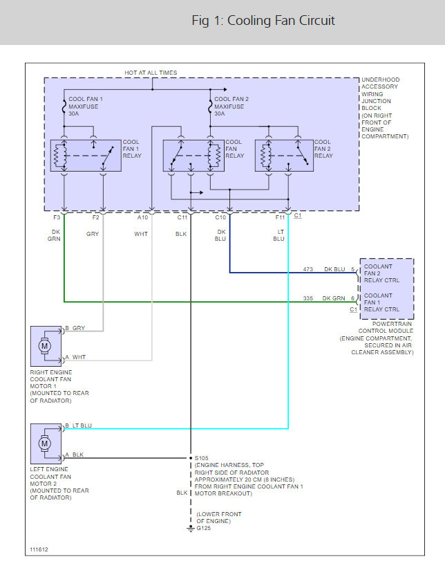

2000 Pontiac Montana cooling fans
2000 Pontiac Montana Two Wheel Drive Automatic

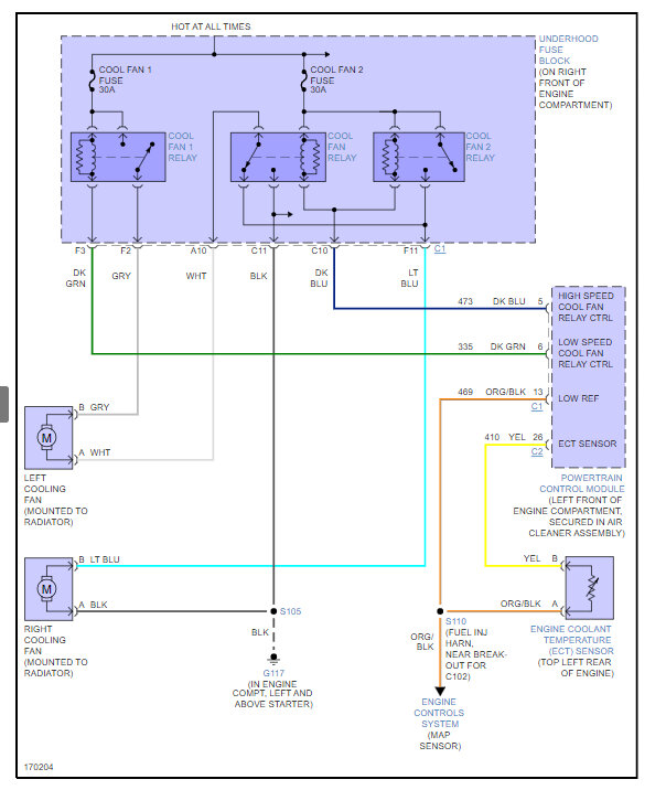

fans not working fuse ok how to i check farther
Avatar Asked by art smith
Answer
Replied on August 28, 2010
http://www.2carpros.com/forum/automotive_pictures/416332_2000_pontiac_coolant_temp_sensor_1.jpg
I posted a diagram of where the coolant temp sensor is unplug it and with the engine idling jump the two terminal's together on the connector harness with a jumper wire if the fan kick's on replace the coolant temp sensor.
