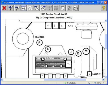

MY GRand Am will not start and I cannot locate the fuel pump relay. Where is the fuel pump relay located in a 93 grand am se?

Center of engine compartment firewall, on relay bracket

It's number 3 in the diagram it's on the firewall.

I cannot see the numbers on the picture.

Center square on the firewall.
