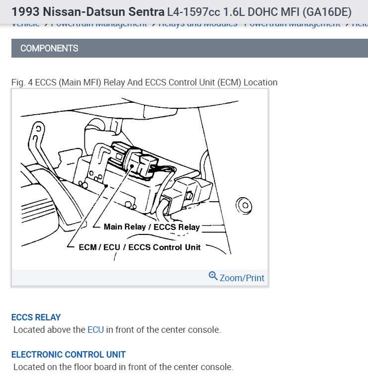

I would say it is the ECU that is bad because I have seen this problem before I would try a used one. Here is the location.
Cheers

I do not believe it I tried the ECU you said finally and I have been running the car it has never run better I think we got it! I will report back if it does it again wish me luck.

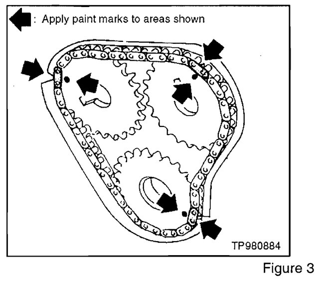

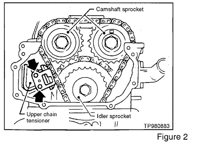

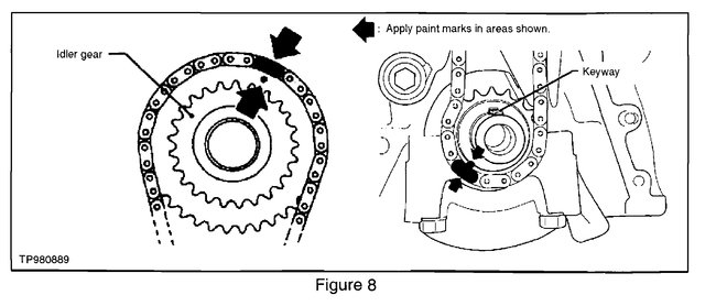

After repairing the cylinder head and put car back together car starts and idles but immediately shuts off when gas pedal is pressed.
Friday, August 28th, 2020 AT 9:50 AM (Merged)
  • 108,133 POSTS
Welcome to 2CarPros.
Have you checked for vacuum leaks? Also, does it idle smoothly? Have you checked fuel pressure?
Next, I attached three pics of timing marks. Make sure they were where you set everything.
If possible, can you record what is happening so I can hear the engine idle and what happens when you hit the gas?
