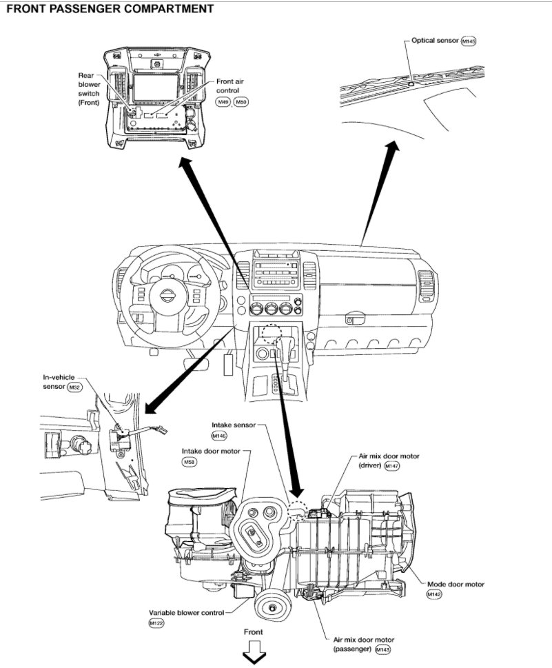

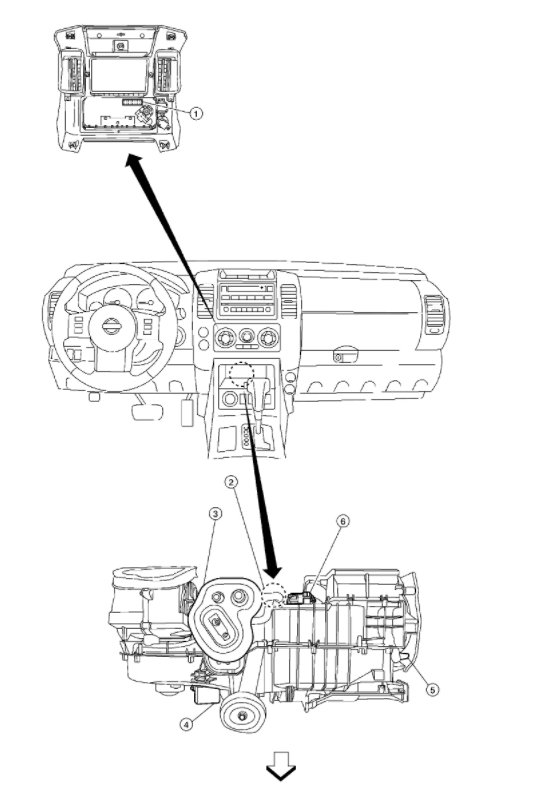

Want to run the diagnostic on the climate control. I started the car and pressed the off until the system appeared to begin cycling through a test series. when ist stopped about 60 seconds later it just showed the number Test complete and the number "12". The cars Climate control system has been acting erratically for a while. EG Blowing cold air when calling for heat/Blowing hot air when calling for ac. The problem always seems to rectify itself for a period but then will pop up every once in a while. Any suggestions.
Thanks
LH
Dec 9, 2012 at 1:33 PM
KHLOW2008
  • CAR REPAIR CONTRIBUTOR
  • 41,814 POSTS

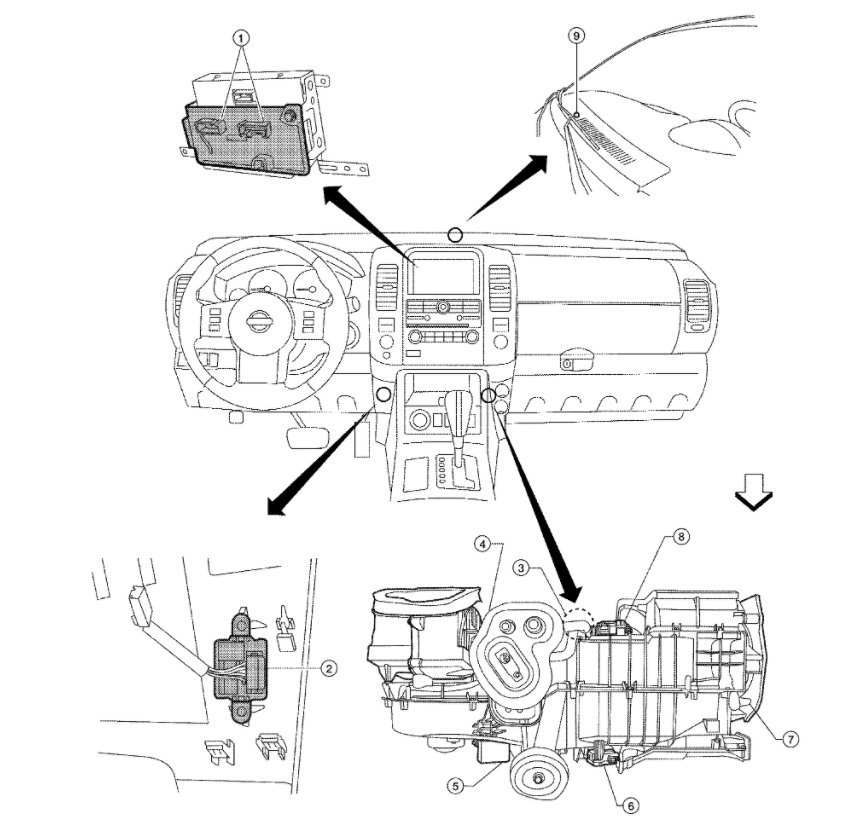

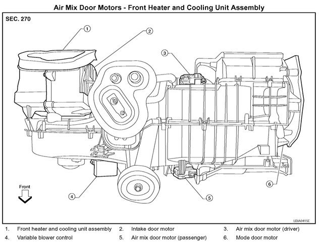

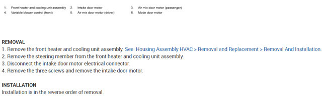

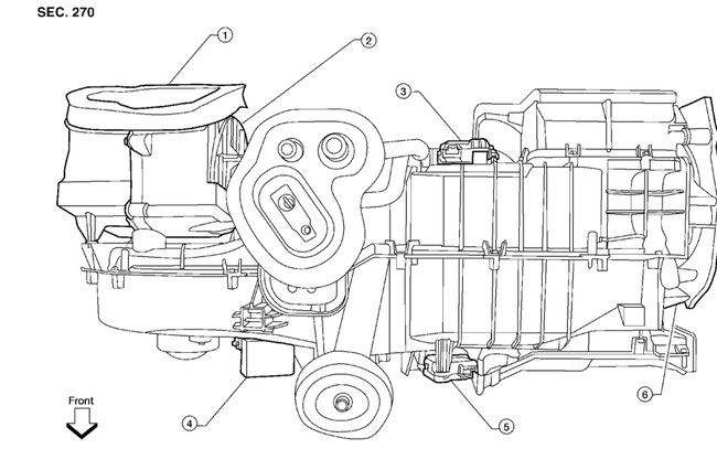

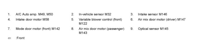

It sounds like the blend door actuator is out but to be sure this guide will help with the actuator location in the diagrams below
Code 12 - Passenger air mix door open/short/out of limits.
I have included both auto and manual systems. Check out the diagrams (Below). Please let us know what you find.

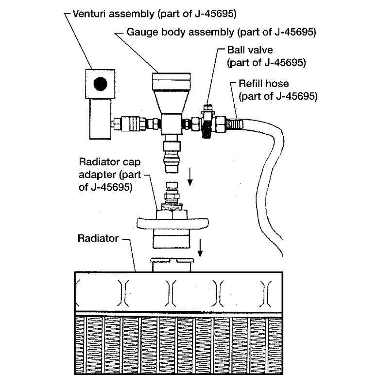

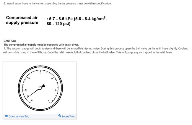

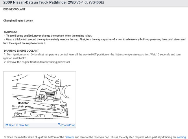

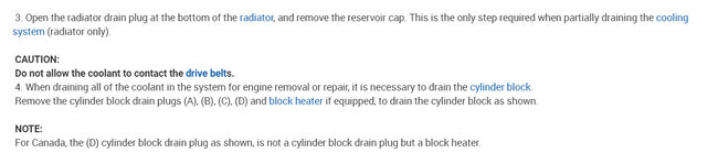

The heater hose connector to the heater core broke, I fixed that problem, replace the coolant, truck has no heat. when idling, the temperature gauge stays in the middle, when I go to drive it, the gauge goes way up and no heat.
Nov 26, 2020 at 11:38 AM (Merged)
  • 54,350 POSTS

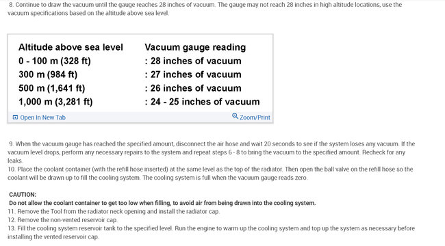

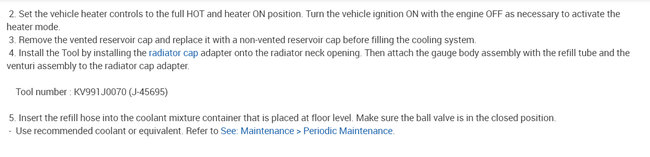

It sounds like you have an air pocket in the cooling system. There is a special way you need to fill the system. here are the instructions. You may be able to purge the system by raising the back of the truck using a jack, then try raising the front while running.

Air blows but only cold, it does not get hot at all. We have flushed the system and coolant levels are good. The vehicle runs at normal temperature. We have no idea what the problem could be. Any ideas? The vehicle's year is 1999.5.
Nov 26, 2020 at 11:40 AM (Merged)
  • 54,350 POSTS
It sounds like the temperature blend door actuator is not working which will cause the air door not to move allowing the hot air inside the car. Here is a guide to help you see what you are in for when doing the job.
