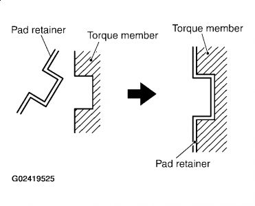

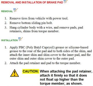

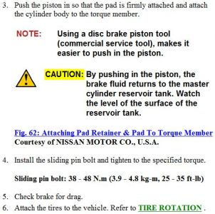

ZACKMAN
MECHANIC
4,202 POSTS
SPONSORED LINKS
-1
Wednesday, April 15th, 2009 AT 2:34 AM
