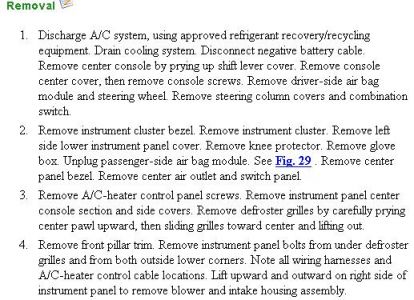

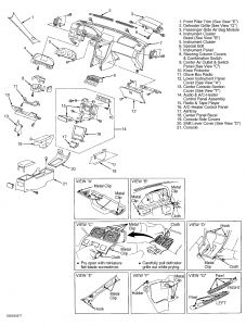

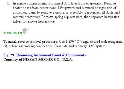

How do I remove old heater core to install a new one?
Friday, February 27th, 2009 AT 8:16 AM
