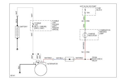

can u send a pic or diagram of some sort to me I believe the wire hook up is wrong by 1 or 2 wires when reinstalled

Hello
Below is info. you requested.
