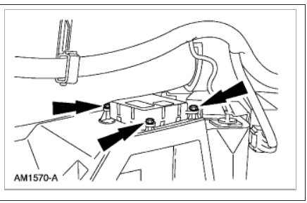

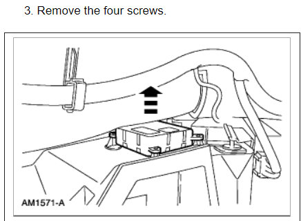

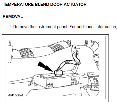

I have a 2004 mercury grand marquis with 91,000 miles (4.6). I have no heat, and this is a problem because its winter! I recently changed the thermostat, but even when I have the climate control on the highest setting (90 degrees) and the fan on high, its still blowing cold air.
The engine runs at normal temperature, does not overheat at all.
Tested the EATC system, as described below and the only code that showed up was 025.
Can anyone tell me where in the dash I can find the air blend door actuator?

Could be a clogged heater core here is a guide to help you see what you are in for when changing the mode blend door actuator.

my problem is i have no heat or air working at all, seems as there is no power to the fan or temperature control unit. I remedied this by replace the blend door actuator thanks 2Carpros! I think the cost would be associated with this problem was $265.00.
