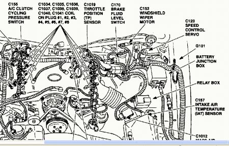

TAMARA REYNA
Put a new A/C compressor in my car. Now the control panel for the AC/heat does not come on at all.
Aug 26, 2019 at 6:24 PM (Merged)
  • CAR REPAIR CONTRIBUTOR
  • 54,350 POSTS
It sounds like you have a fuse that is out. Here is a guide to help you check the fuses for the system and a diagram (below)
and
It could be the control head, check for power and ground.

RIVERMIKERAT
  • 6,110 POSTS
Blower motor control. Use a meter to see if each of the pins to the blower motor are receiving power on different speed settings.

DKHOME
It sounds like your blend door actuator needs to be replaced. You can do it yourself but its a long and annoying job that requires removing the dash. The part cost between $65.00 to $80.00 depending on where you go. If you go to a shop expect to pay between $600.00 to $850.00. Sometimes you can get your hands in there to do it here is a guide to help walk you through and the location of the blend door actuators.
Check out the diagrams (Below). Please let us know if you need anything else to get the problem fixed. Cheers,

TEX
Just got mine back from the shop today $1,000.00 later. It had two blend door actuators that needed replacing along with a TPS (temperature processing sensor) or something like that. Sure felt nice to have A/C again! Especially in Texas. We were also told there were three service bulletins from Ford that came out regarding this problem. You can find them on the internet.
