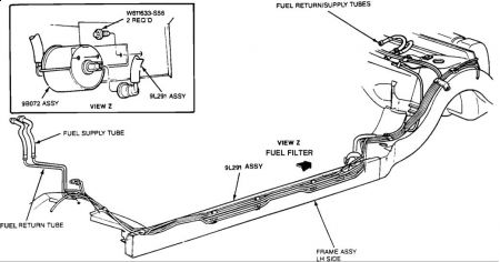

Where is the fuel filter located on a 1994 Lincoln Town Car Signature Series
Monday, February 8th, 2010 AT 8:00 PM
MECHANIC
75,992 POSTS
Left inside frame rail.
