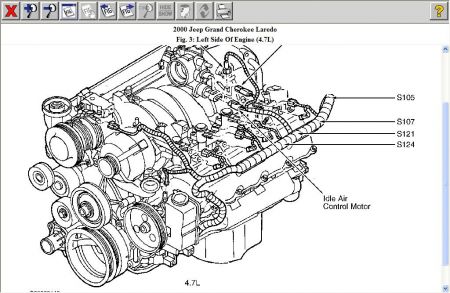

The Jeep will not idol at a consistant RPM. I'm thinking idol control valve or motor. Any idea where it is located on this model?
Thursday, October 15th, 2020 AT 11:06 AM (Merged)
  • 75,992 POSTS
Its a grand cherokee that's why I couldn't find it-
The idle air control motor see below
