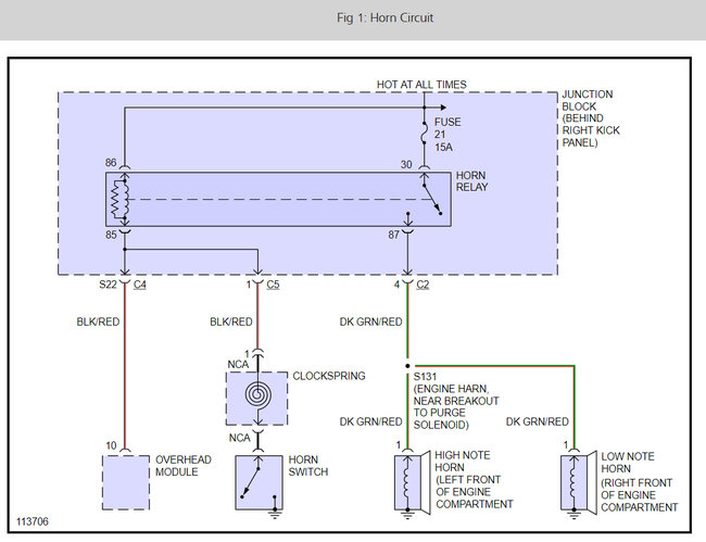

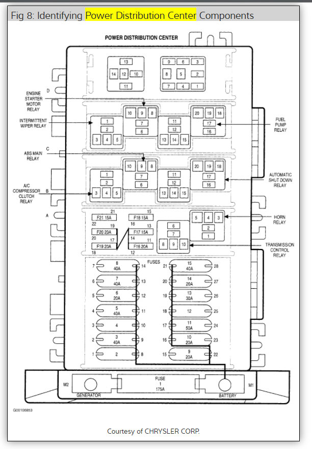

The horn in my 99 Jeep Cherokee Sport just won't work. I have checked all the fuses and seems like there is no power going to the horn
Saturday, November 8th, 2008 AT 11:04 AM
23 Replies
KEN L
  • MASTER CERTIFIED MECHANIC
  • 42,877 POSTS

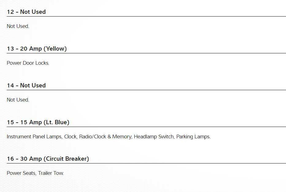

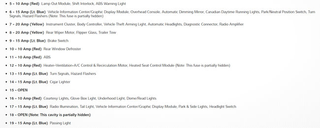

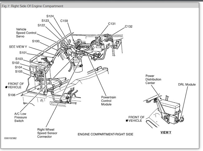

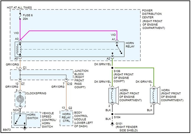

There is a horn relay that sounds like it is not working. Here is a a horn system wiring diagrams so you can see how the system works. This guide will help you test the relay when you find it from the diagrams below.

AMTIII
Thanks! It was the relay

The problem is usually in the steering column. You could use a voltage tester at the horn relay. Terminals 30 and 86 are hot all the time. Terminal 85 is ground for the coil side of relay, your horn switch, grounds the circuit. When the relay is grounded, that arm with the arrow-head moves to terminal 87, 87 carries voltage to the horn.

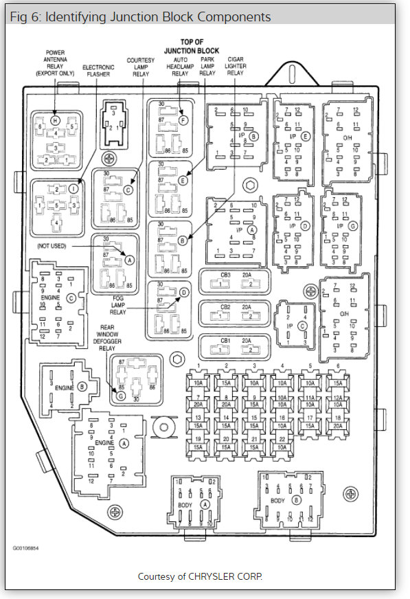

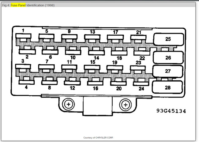

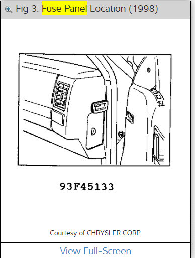

The horn relay should be located in the junction block under right side of dash. I don't know what else to tell you?

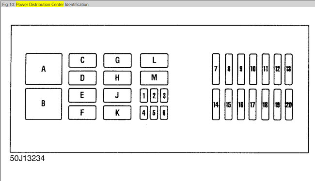

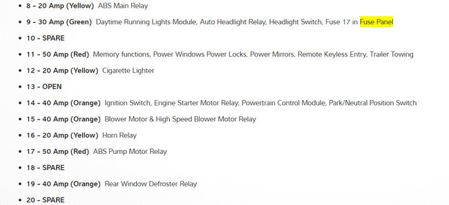

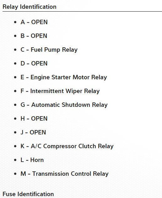

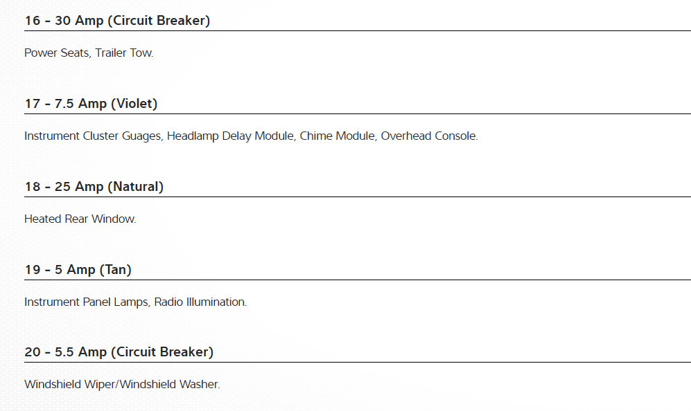

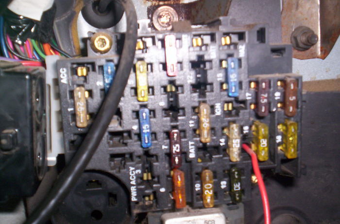

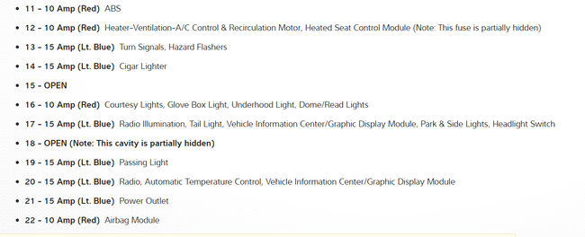

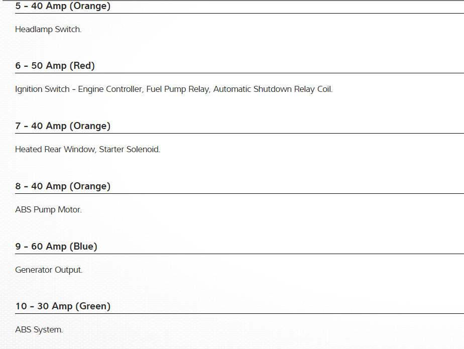

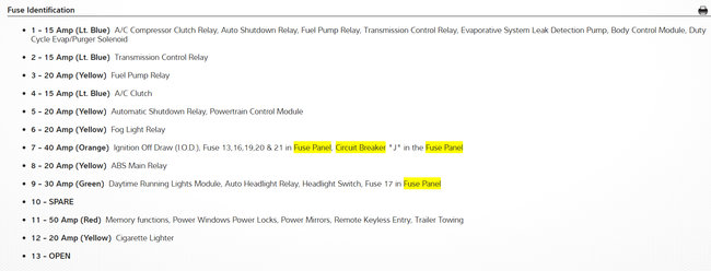

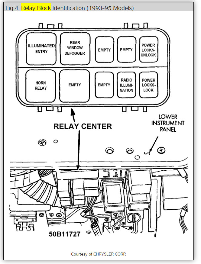

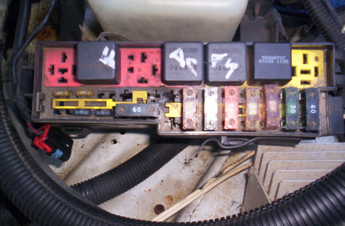

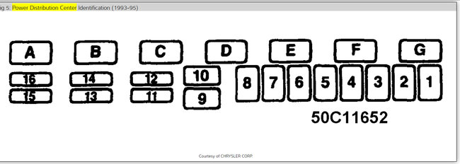

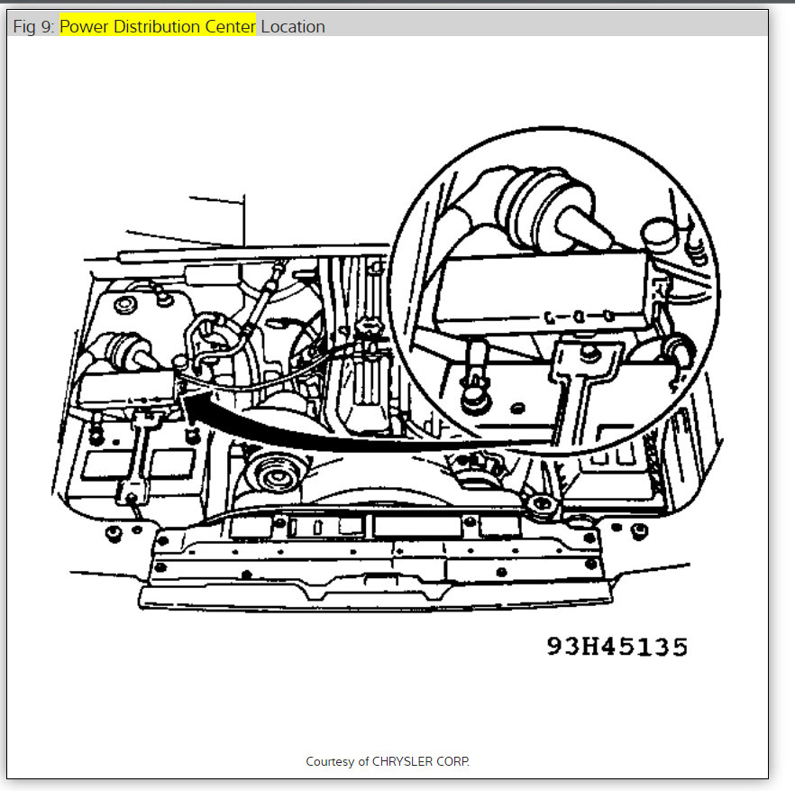

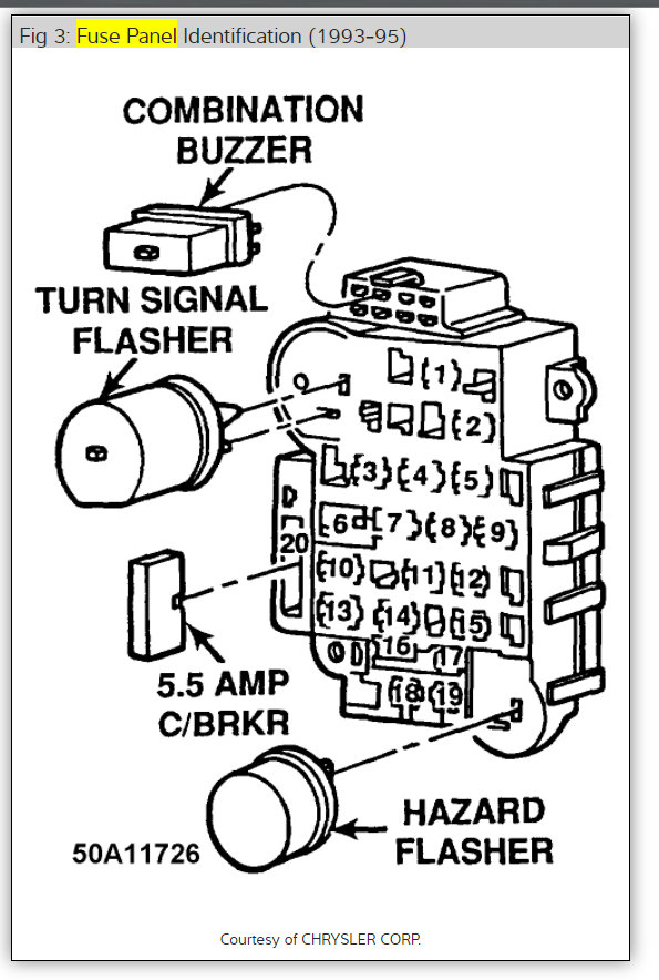

Where is the horn relay located on a 1995 Jeep Cherokee? Are there any pictures to show where it can be found?
+1
Monday, November 11th, 2019 AT 6:01 PM (Merged)
  • 75,992 POSTS

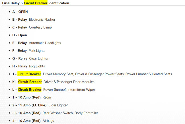

The horn relay is located in the fuse panel. Here is a guide to help test it with the location in the diagrams below.
-2

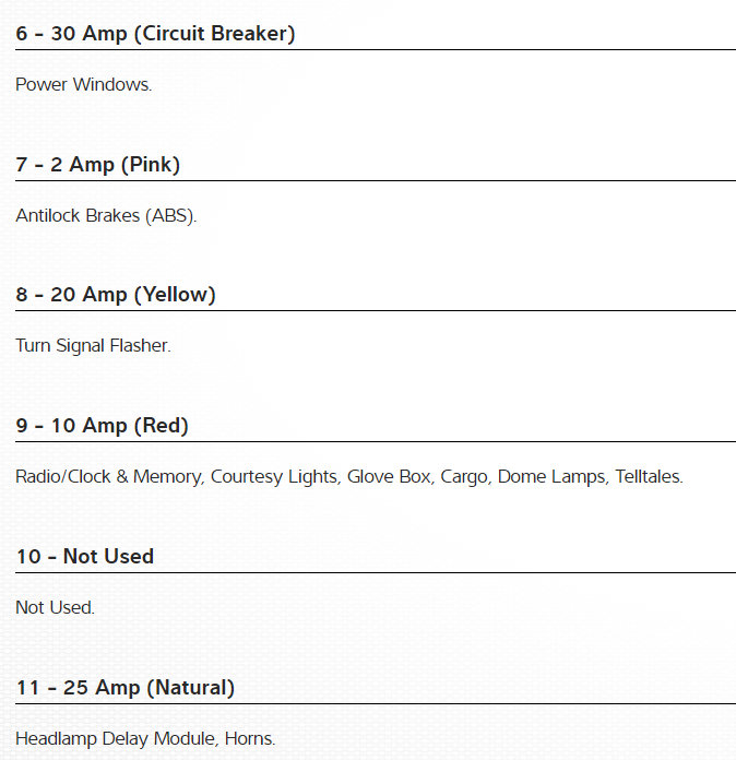

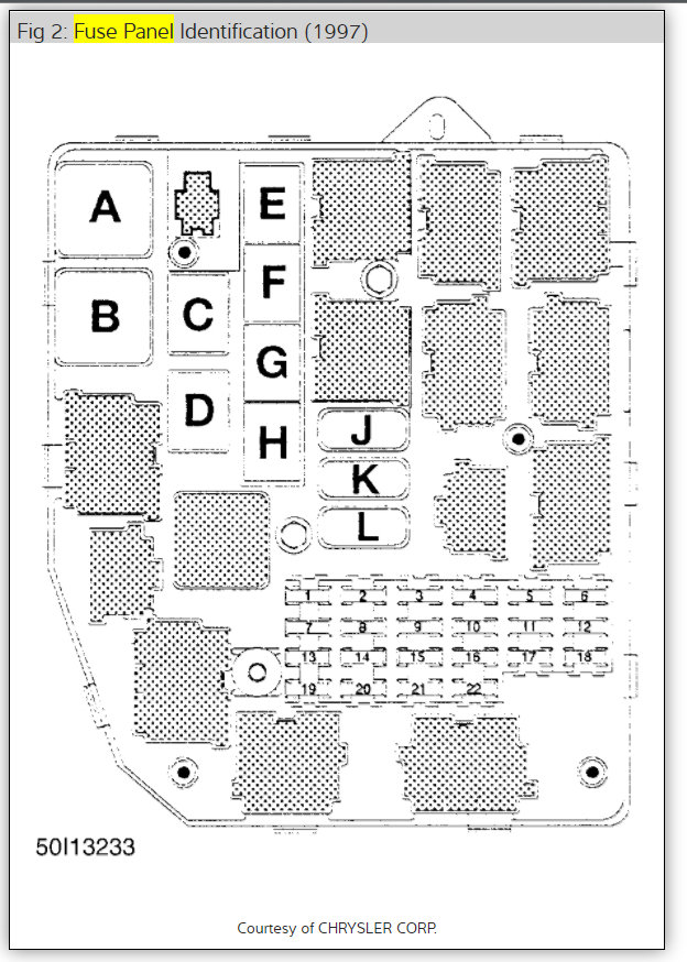

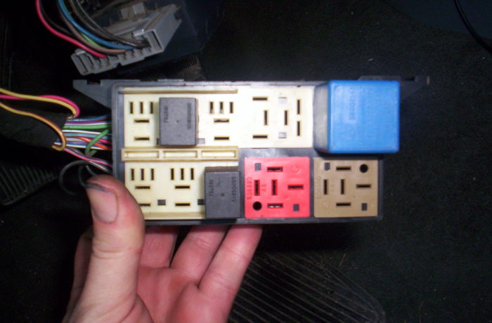

STONE CLONE

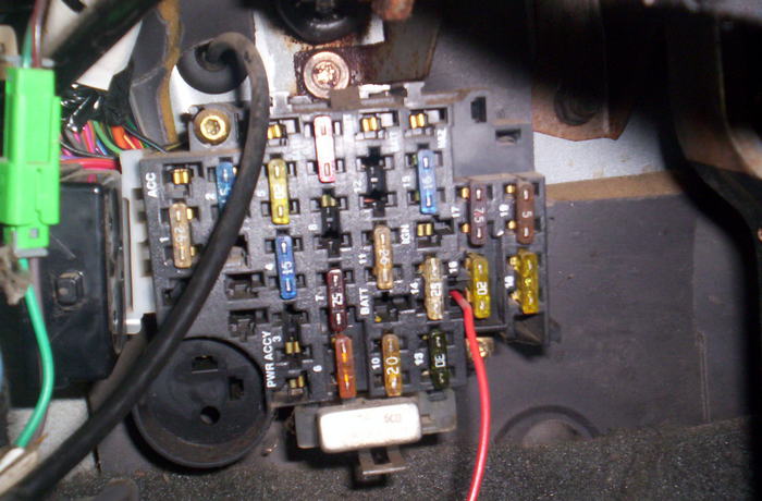

Is this under the dash or under the hood? I have nothing that looks like this that I can see. Thanks for your help. I really appreciate it.
STONE CLONE
I am going to post a few pictures of what I've been looking at. Maybe that will help us out.
+1

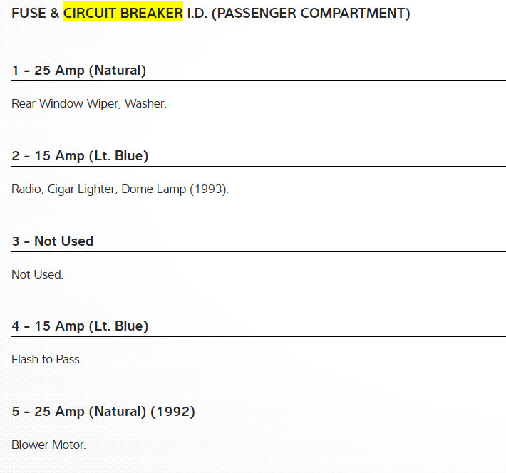

KEN L
  • 42,877 POSTS
I found this. Check out the diagrams (Below). Please let us know if you need anything else to get the problem fixed.

The horn does not work. It will blow if you set off the alarm system, but not from the steering whell buttons. Fuse is good and I also replaced the relay, since jumping across 30 and 87 on the relay socket made the horn work. New relay, good fuse, good horn, but still missing something here. Any ideas?
Monday, November 11th, 2019 AT 6:02 PM (Merged)
BLUELIGHTNIN6
  • 16,542 POSTS
Most likely horn switch on steering wheel since all other components were already tested OK
DRJACK
I got schematic of the horn sysem and narrowed it down to that switch. Can't figure out how to get to the switch though.
