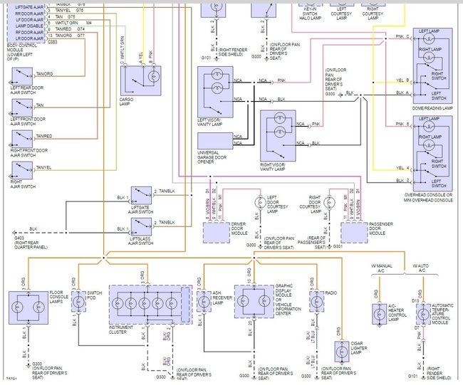

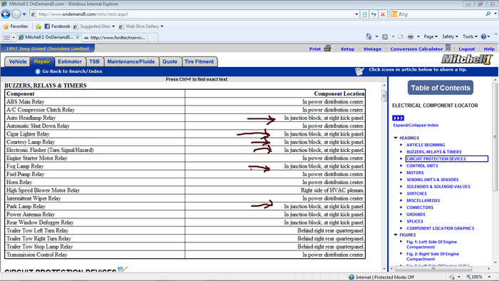

Check the main junction block under the right side of the dash. I have attached an image with the relays that are co-located there pointed out. Let us know which one is clicking, and I'll send you a schematic for that system so you can track the short.
+5
Saturday, December 10th, 2011 AT 12:48 AM

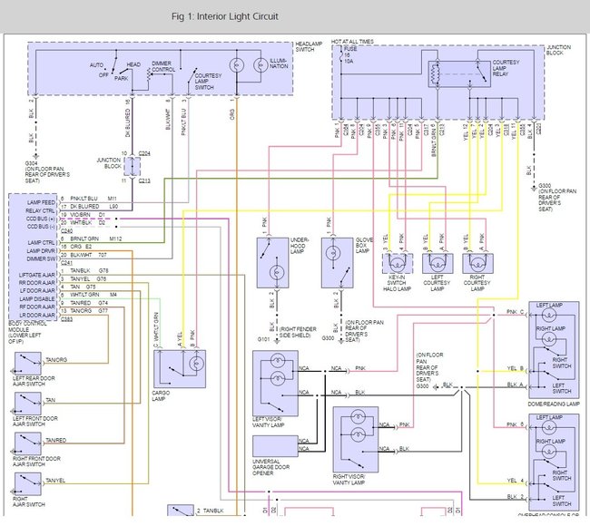

TDAWWG
I know this is years old, but I just thought I would report on my experience. I have a 1996 Jeep grand cherokee with this issue. I got down to looking through the fuse box and found that the issue is coming from the courtesy lamp fuse(slot 16) If the fuse is pulled the clicking and battery drain stops.
+10
Tuesday, January 10th, 2017 AT 6:03 AM

This is what I found for the draw, there is a relay that I think has shorted or you have a glove box or hood light that is staying on, here is a diagrams and some wiring diagrams to get the problem fixed.
https://www.2carpros.com/articles/car-battery-dead-overnight
Please run some tests and get back to us so we can continue helping you.
Best, Ken
