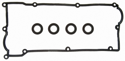

Sirs, I recently changed my spark plugs and all were fine exept for 1(one) which has oil on it as I removed it. Thanks R

Replace your valve cover gasket, including the spark plug tube seals.
Felpro VS50593R 1.6L
