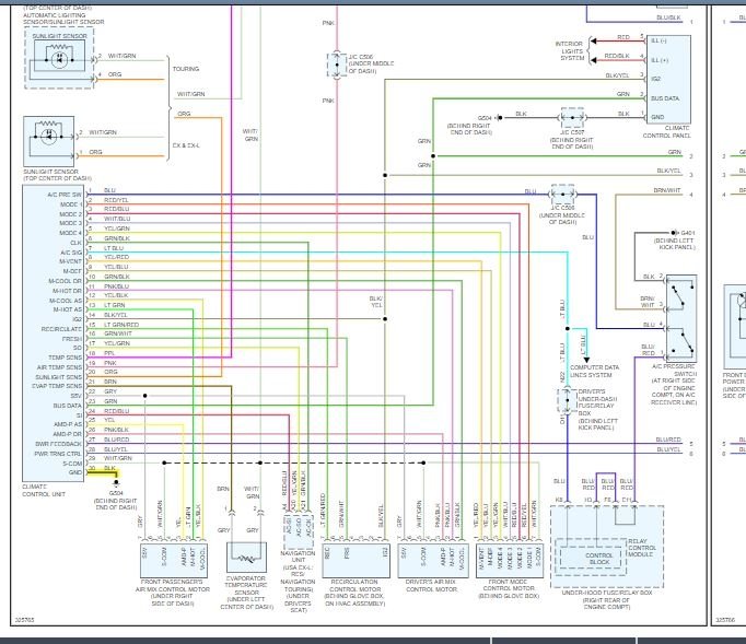

What fuse did you replace? Which fuse block?
I attached a wiring diagram of the control unit.
Do you have automatic climate control?
Sep 18, 2019 at 2:13 PM

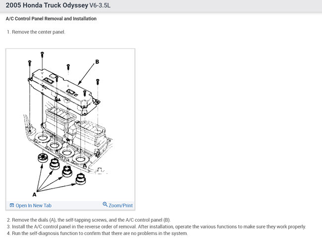

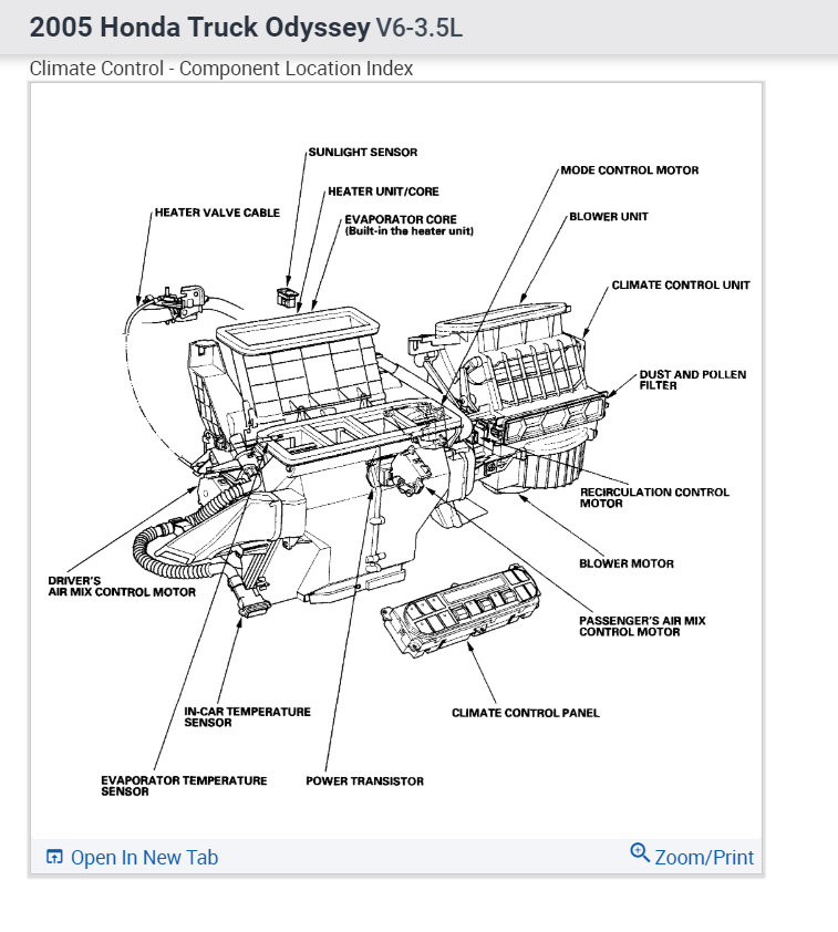

The heater control panel may have a internal problem, only way to fix it is to replace the heater control panel. Here are the instructions on how to replace the panel in the diagrams below. Check out the diagrams (Below). Please let us know what happens.
Dec 19, 2019 at 3:12 PM (Merged)
MIKE94
  • 0 POST
The panel cost $143.00 and it worked! this site is amazing!
