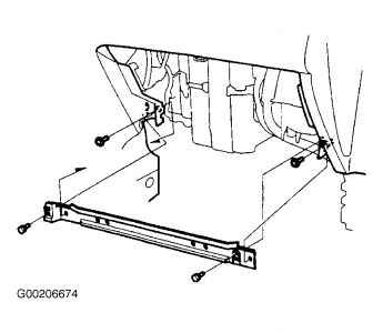

How do you change the cabin filter. I cannot get the metal bar out of the way.

First remove the glove box. Then the metal brace has screws/bolts holding it in (see pic)
